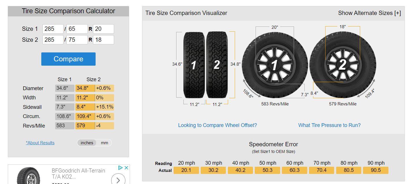

THE SET UP IS WAS WANTING ARE 285/75/18 TIRE WHICH IS 33.9 TALL WITH A 18 X9 RIM AND A +12 MM OFFSET JUST NOT SURE IT WOULD FIT. THIS IS WHY I WANTED A 2.5 LEVEL THANKS

Did you mean 34.9"? Here are your tires compared to mine. I think you would be very comfortable at 2.25" or 2.5" with those wheels, but check with your tire/wheel provider.
thanks ,this helps
