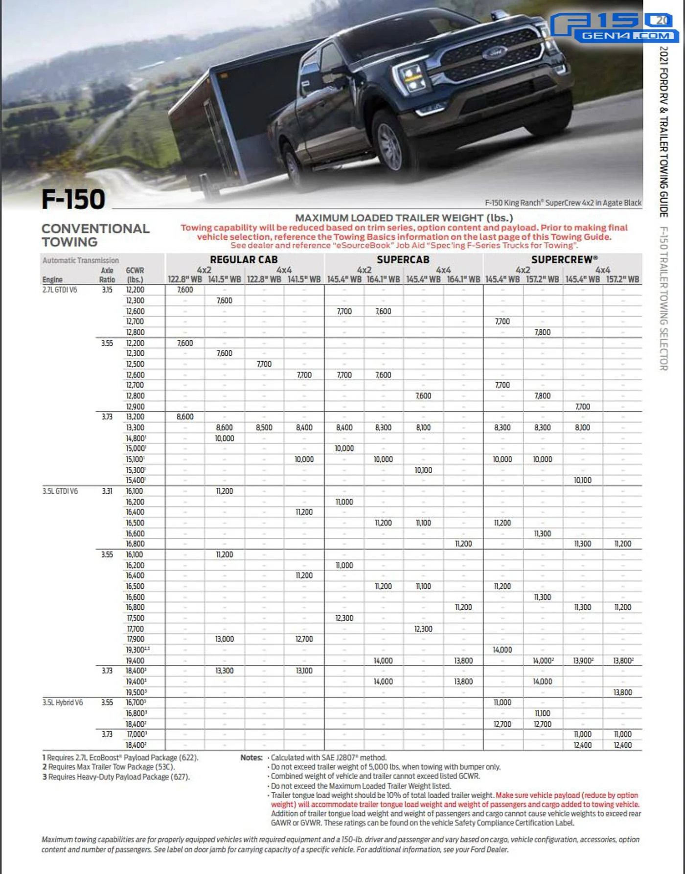

Once u see it on the chart sure does stick out. Has 3 73s so thats the HDPP. Probably right then

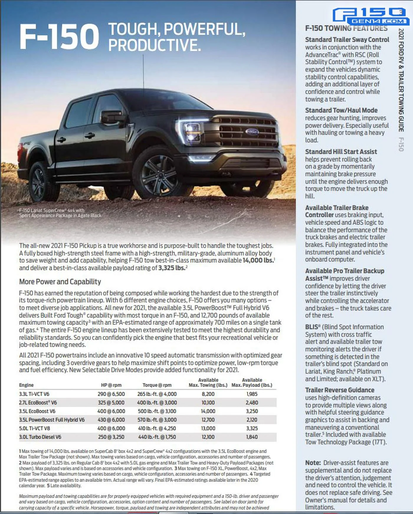

Thank you for posting this.

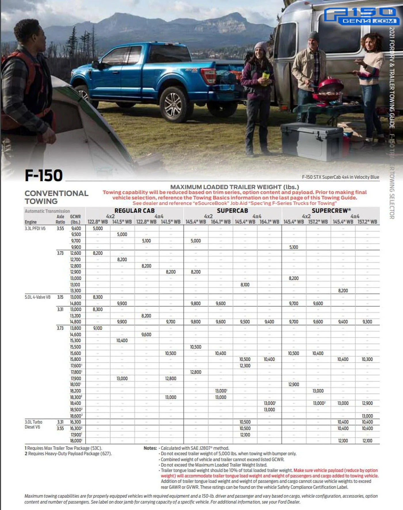

One thing I don’t understand is why it only shows 1700lbs with the 7850lbs GVWR?
have 2640lbs under ideal conditions?
Edit... ok I saw it’s the hybrid .. but the 5.0 should should have a better payload?
Ford F-150 Lightning 2021 F-150 Towing, 5th Wheel Towing and Cargo / Payload Capacity Figures 080479C8-8FD9-4148-A1C7-BC524E542AE6
Ford F-150 Lightning 2021 F-150 Towing, 5th Wheel Towing and Cargo / Payload Capacity Figures 4F6F47ED-6926-4E38-A1D8-7B4334230E4F

Not seeing any towing specs for the Hybrid with the basic tow package (53A), just with the Max Tow and Heavy duty. Am I missing something?
