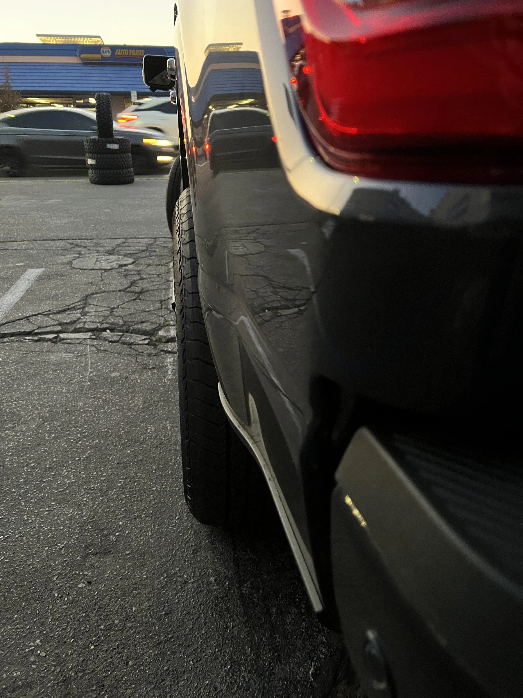

It's hard to say with just offset, as the tire width also plays a factor.
I have 18x9 -1 offset rims with 35x12.5R18 tires. I have a set of air design flares in the garage waiting to get colour matched, and when I test fit them on the truck earlier today, the tires were flush with the flares.

If you want a flush look with the fender flares, a 0 offset with a 9 inch rim and 12.5 inch wide tire will give you what you're looking for.
A +20 offset will work too, but the tire will be pushed into the truck a bit, and the flares will stick out further than the tire by a bit.
If you want that flush look, as you've mentioned in your original post, go with a 0 offset on a 9 inch rim and 12.5 inch wide tire.
The diameter of the rim (18, 20, 22 ect..) doesn't make a difference on how far the tire sticks out, only how much sidewall you have.
I personally like 18's in a rim, I'm running a 35x12.5 R18 Tire on a 18x9 0mm Offset Rim. That gives my wheel a more aggressive off road look, since there's more tire sidewall visible, as well as improved offroad performance too. Ultimately, it's up to personal preference.
