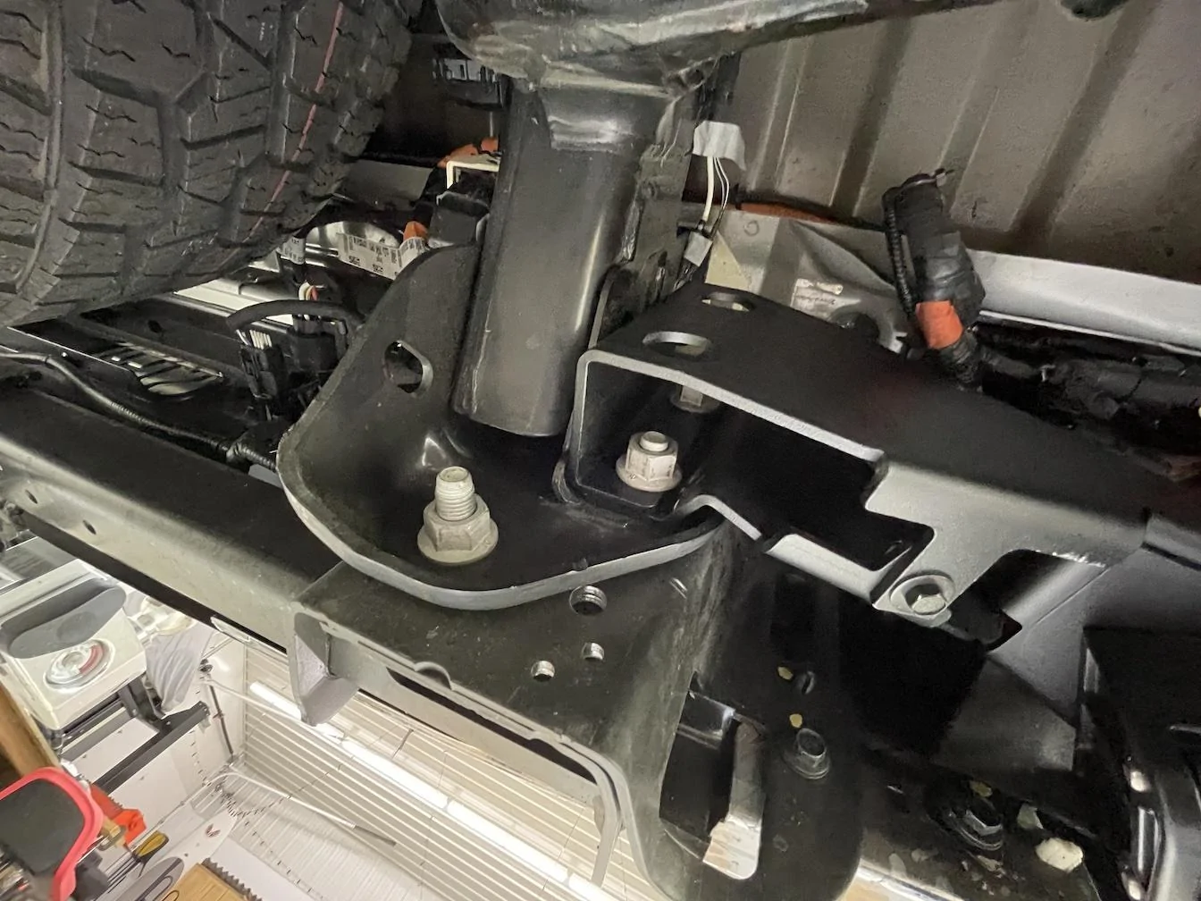

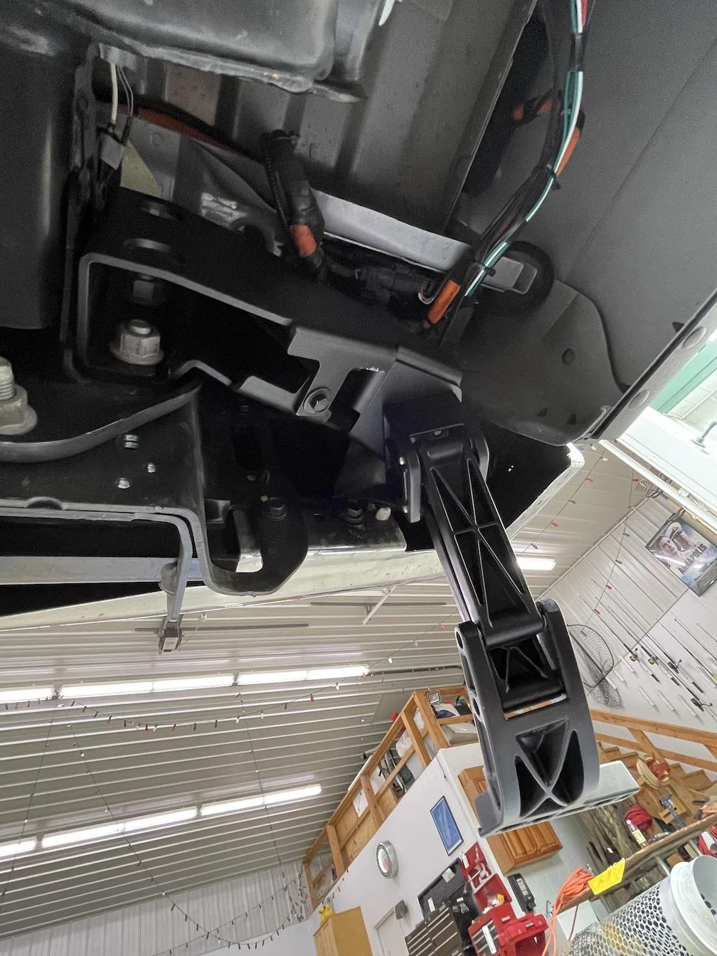

I didn't have any issues with my install...Are you all trying to install the 2 x 15mm bolts into the support bracket? only 1 goes through that support bracket, the 2nd bolt is just next to it..
I can get a photo this afternoon...

Yes that is exactly the mistake I was making. Since that support bracket had 2 holes I figured it needed to be filled! And what about the 5 holes in the base??? Very confusing and yes left out a few details that could easily be fixed. Like giving each hole a letter or #. And how bout short video showing the operation.

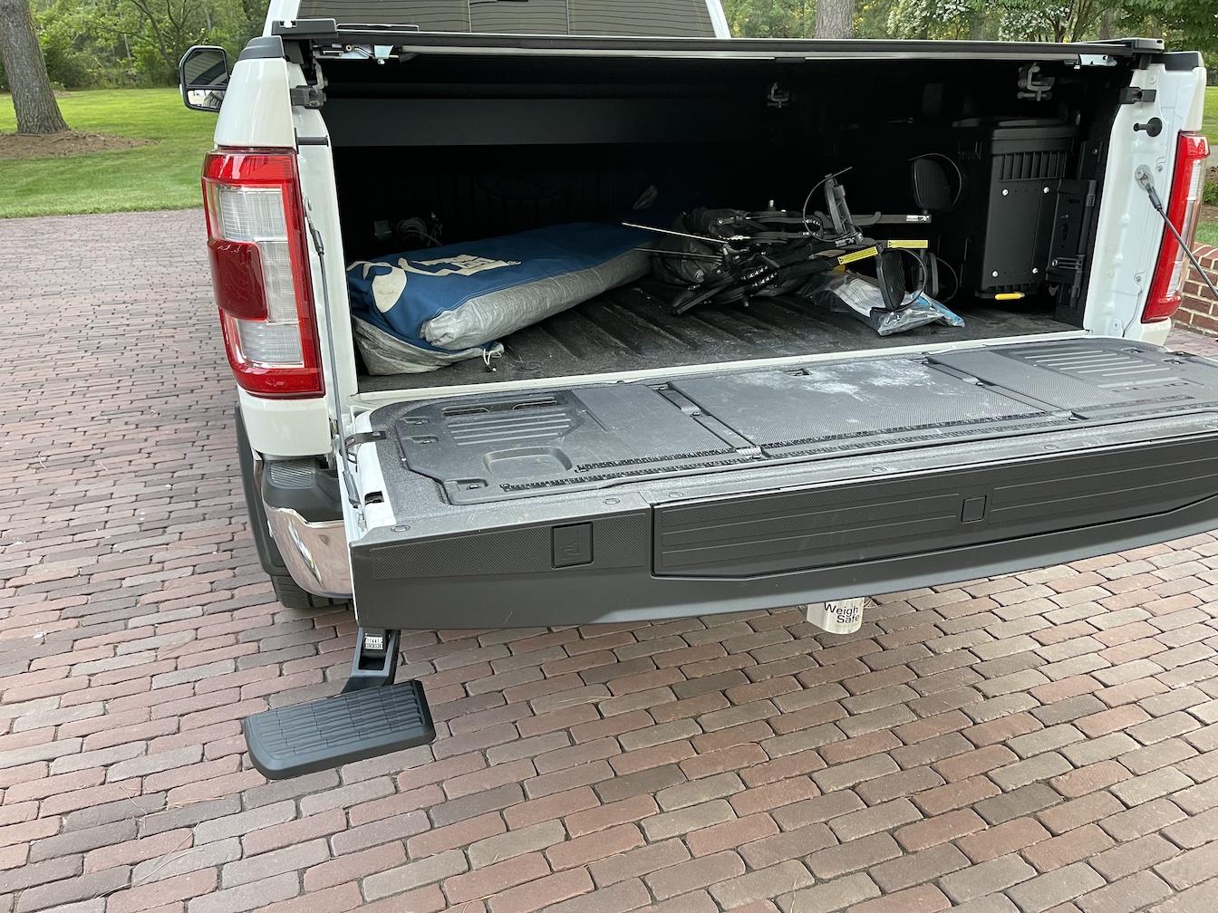

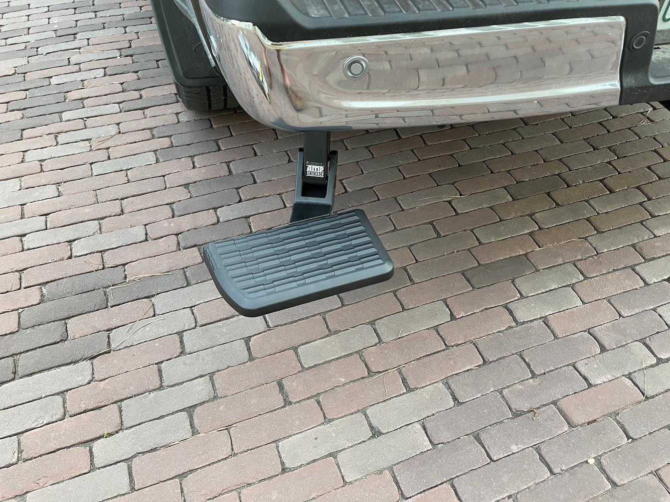

I finally made a call to tech support and got a guy in a few min. He explained what 12Lariat21 said above. I took some pics with in on the tailgate. Sure hope AMP takes a few min to fix the instructions and make a video.

It is a really good part, tough to design given the amount of weight it must support and the awkward angle that it juts out to be useful. But they definitely need to fix the instructions - took me a couple tries - too many holes, bad pictures, no video. It all comes clear when you do get it right, but it is super non-intuitive.
