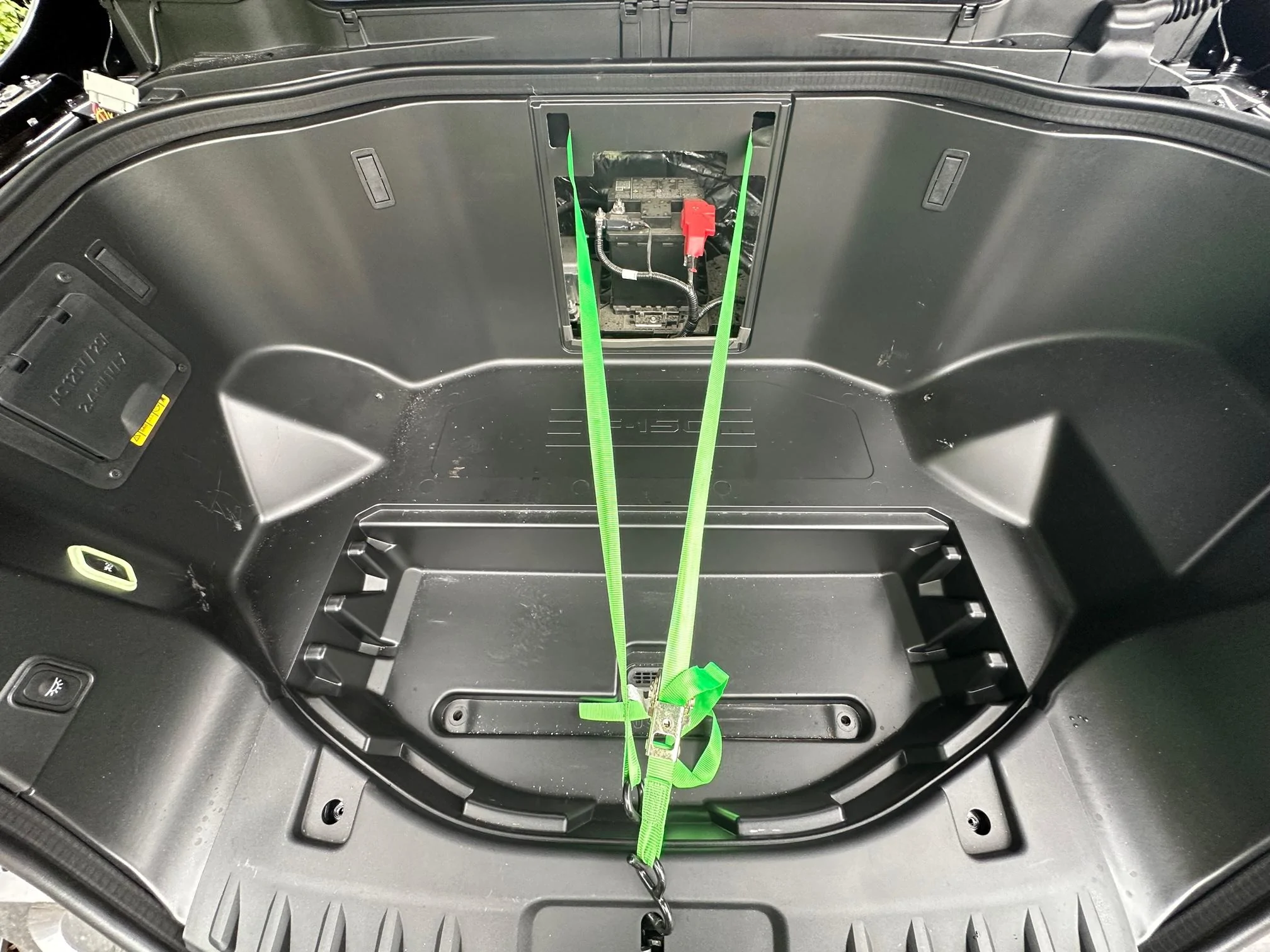

Another one bites the dust! Thanks to everyone who made this possible. Even with the great info above, I had a bit of a hard time locating the beeper but eventually found it.
In order to keep the harness end sealed, I left the beeper in place but disabled it by removing it's contact pins with needle nose pliers. They broke easily.
Getting the frunk out with one person is a challenge. I installed a ratchet strap, as pictured below, so that I could lift near it's center of gravity and that helped a lot.
Great idea. Working smarter, not harder! Lifting it in and out with my arms spread out like Jesus was quite the challenge.
Yeah I struggle with joint pains and so I couldn't get a good grip on it, on my first attempt to remove the tub it slipped and that led to me shattering the rear retaining clips of the emergency trunk release. Some 3M VHB tape was an excellent temporary fix. After I spoke with my dealer about how much the replacement part would be (several hundred dollars) I decided the fix was a perfectly adequate permanent fix 😬

Yup, I still ended up breaking a couple of the plastic retaining clips on the smaller forward trim panel, between the frunk and the headlight but that wasn't on account of moving the tub, I just pried on the panel a little too hard.
