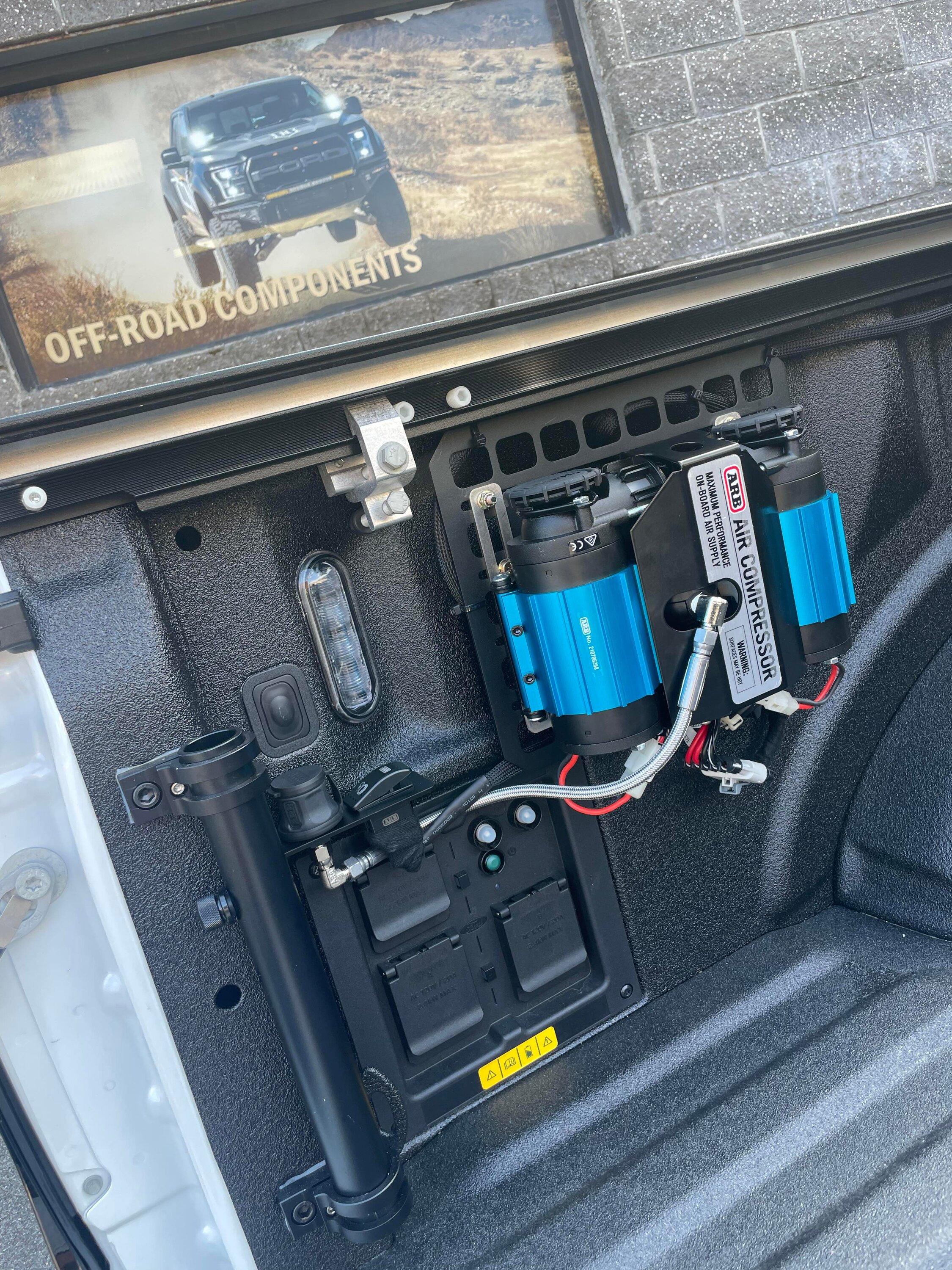

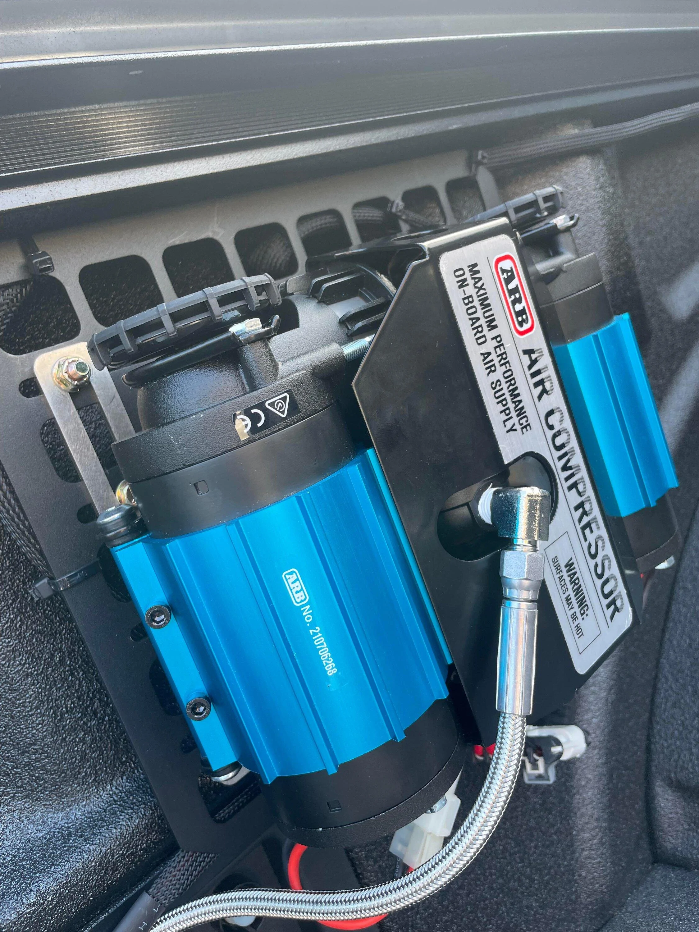

Figured I'd install a twin in my bed. I have a RetraxOne XR Cover on my truck so it'll keep the elements off the compressor (although these ARB can handle the elements without any issues).

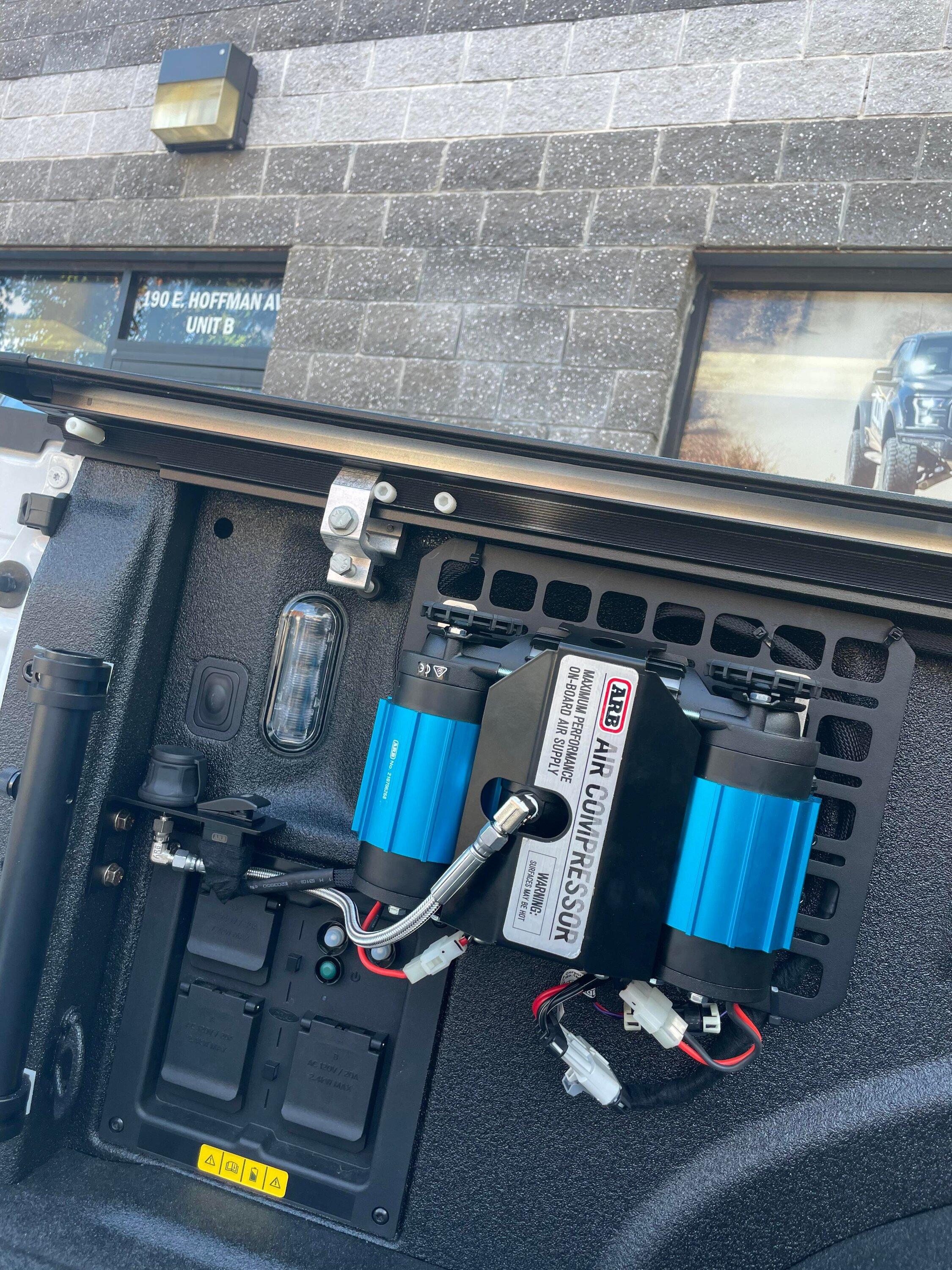

I had an extra BuiltRight Industries bed panel laying around (their small one) so figured I'd install that and mount the compressor to it. Problem was, none of the holes lined up. NO PROBLEM! I can design things in CAD. So i designed some simple brackets to mount to the back of the compressor, which let me bolt the entire assembly onto the panel.

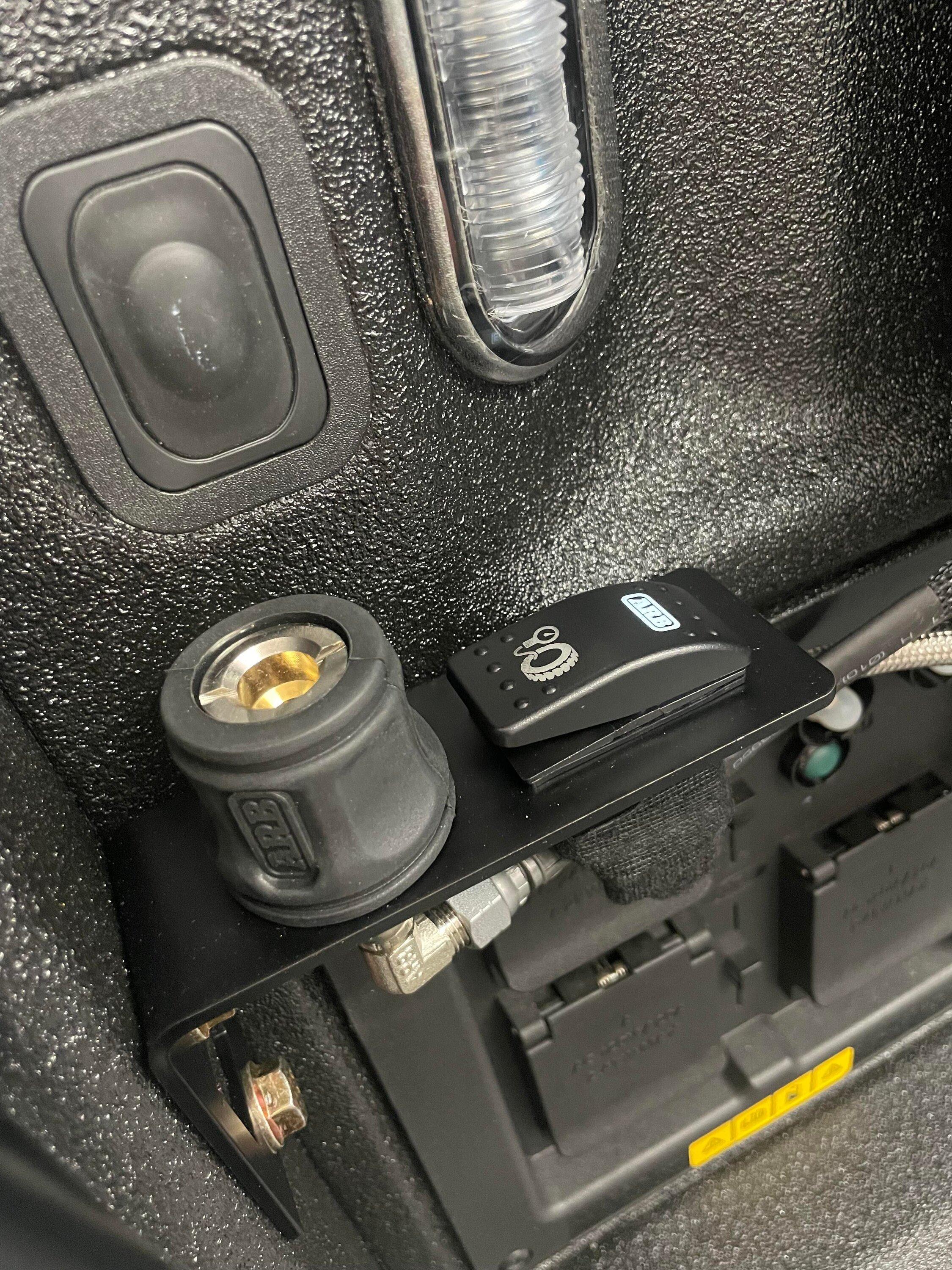

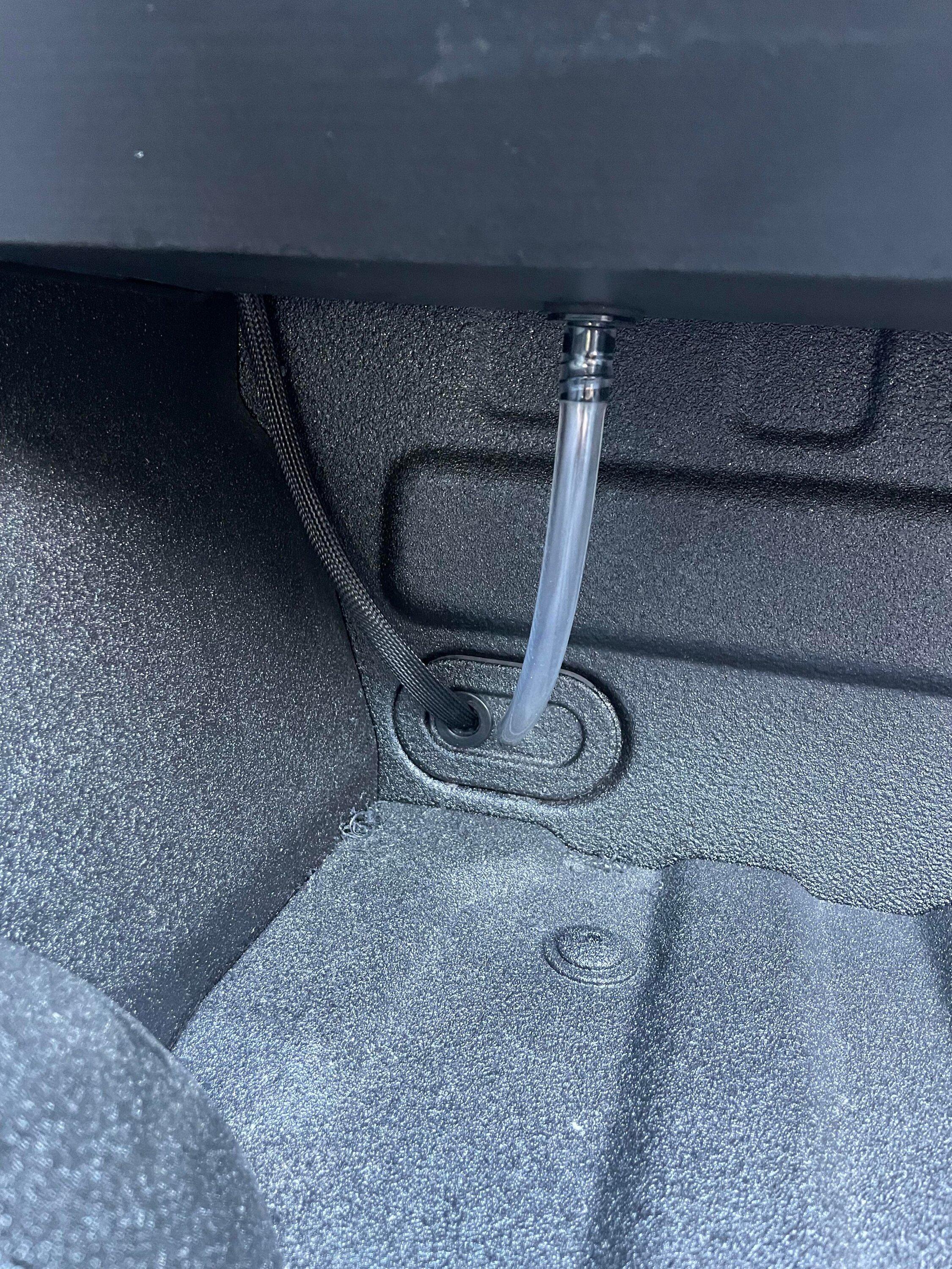

Next, I took one of our Bronco ARB Coupler/Switch panels that we make and bolted that in. I drilled two holes and bolted it on up under my bed lighting button. Ran the line to the compressor, made my own power harness which I ran up through the bed, under the truck and over to the battery. DONE.
Install was pretty straight forward. Took a few hours since I made my own harness and kept everything very clean. Now i've got air wherever I go!
