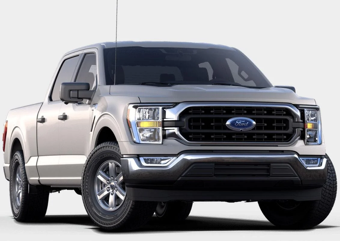

Hi All, I recently placed a custom order for a 2022 F150 XL SuperCrew cab with STX package and also with the XL High Equipment group, 360-Degree Camera, Tow Technology Package, Co-Pilot360 2.0, and it will have Sync4 with Enhanced Voice Recognition and FordPass Connect. With all the options I added (not all shown here), the truck will be well above $50,000. After ordering, I realized that Co-Pilot Assist 2.0 is available on XLTs (though not XLs), and it appears to be a simple software update (plus the extra button that can get added to the steering wheel, though that doesn't even seem necessary for the functionality). I travel long distances frequently and would really like to add Co-Pilot Assist 2.0.
With the options above that I already ordered, it appears that XLTs do not have any additional technology that would allow for the addition of Co-Pilot Assist that won't already be installed on my XL. I am willing to pay for the upgrade and it appears that Ford simply does not want to allow XL buyers to be able to purchase Co-Pilot Assist in order to entice buyers to purchase an XLT or above. I've since thought about cancelling the XL order to order an XLT, but there is nothing additional with the XLT that I want, nor can I get the same 20" STX rims with an XLT and I like the front grille on the XL STX package better as well. If I ordered an XLT, I would be getting something I like less just so I could get Co-Pilot Assist, which doesn't any make sense.
Why is Co-Pilot Assist available on cheaper Ford vehicles and on a base XLT that costs $36,630, but not on a more than $50,000 F150 XL? Is this going to change? Is Ford planning to allow F150 XL buyers with the same required equipment to buy and download Co-Pilot Assist eventually? Do you (F150Gen14 forum members) think I should I try to get a Ford dealer to add this for me after the fact? @Ford Motor Company Why won't you let F150 XL buyers pay you more money so we can use this safety feature?

Thanks for your input! That's a really good point and I initially thought that additional radar sensors in the front bumper would be required as well, but it appears that the additional radar sensors are not needed unless you buy the Co-Pilot Active Prep/Blue Cruise setup. For the Co-Pilot Assist option on the XLT (as shown in the picture below), the Ford Configurator only adds the 360-Degree Camera (no front bumper radar sensors). In other forum posts, new XLT owners have said they don't have the front bumper radar sensors with Co-Pilot Assist as well. It's super frustrating to have the necessary equipment and not be allowed to purchase the upgrade, just like in your case with the steering wheel heat. It seems like Ford is missing out on a large amount of sales dollars by not allowing some of these reasonable upgrades.

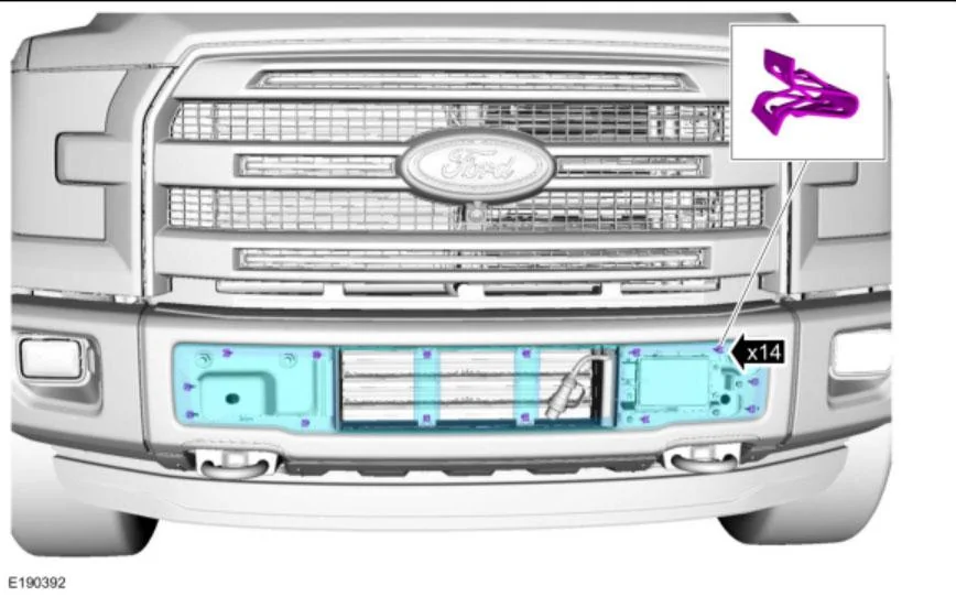

Flanking the lower smaller grille in that pic there are two black plastic covers on either end. Under one of those in my truck with adaptive cruise is a radar sensor to detect the distance to cars in front. The sensors you reference are proximity sensors for parking to detect things in very close range and therefore not related to adaptive cruise

Awesome, that's helpful and I see now. I just found the picture above from a forum post showing the sensor. I knew the Ford vehicles from a few years ago with adaptive cruise used a radar sensor like that, but I didn't know if it was still used with Co-Pilot Assist 2.0. I guess my next question is if this is the same sensor that is used for Pre-Collision Assist with Automatic Emergency Braking (which both the XL and XLT have)? I've also read that some Ford vehicles may use the windshield camera instead of a radar sensor like this for Pre-Collision Assist- which may or may not be correct. This Ford video makes it look like it could be the same sensor in both cases but I'm not certain and I wish that some of the details were publicly made clearer.
