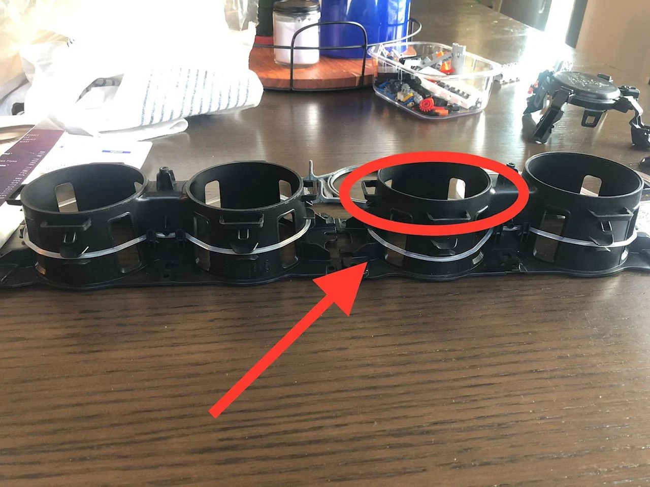

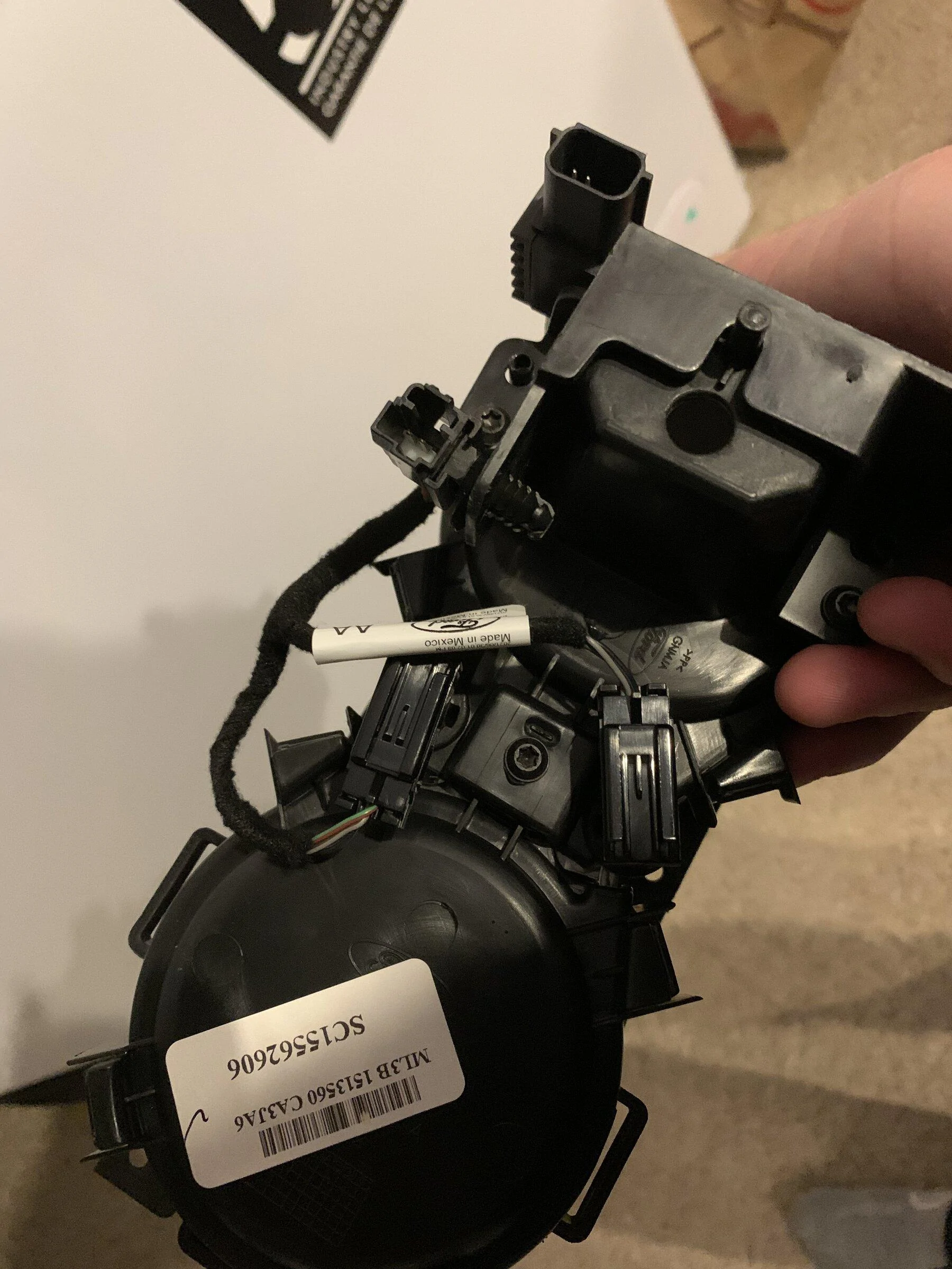

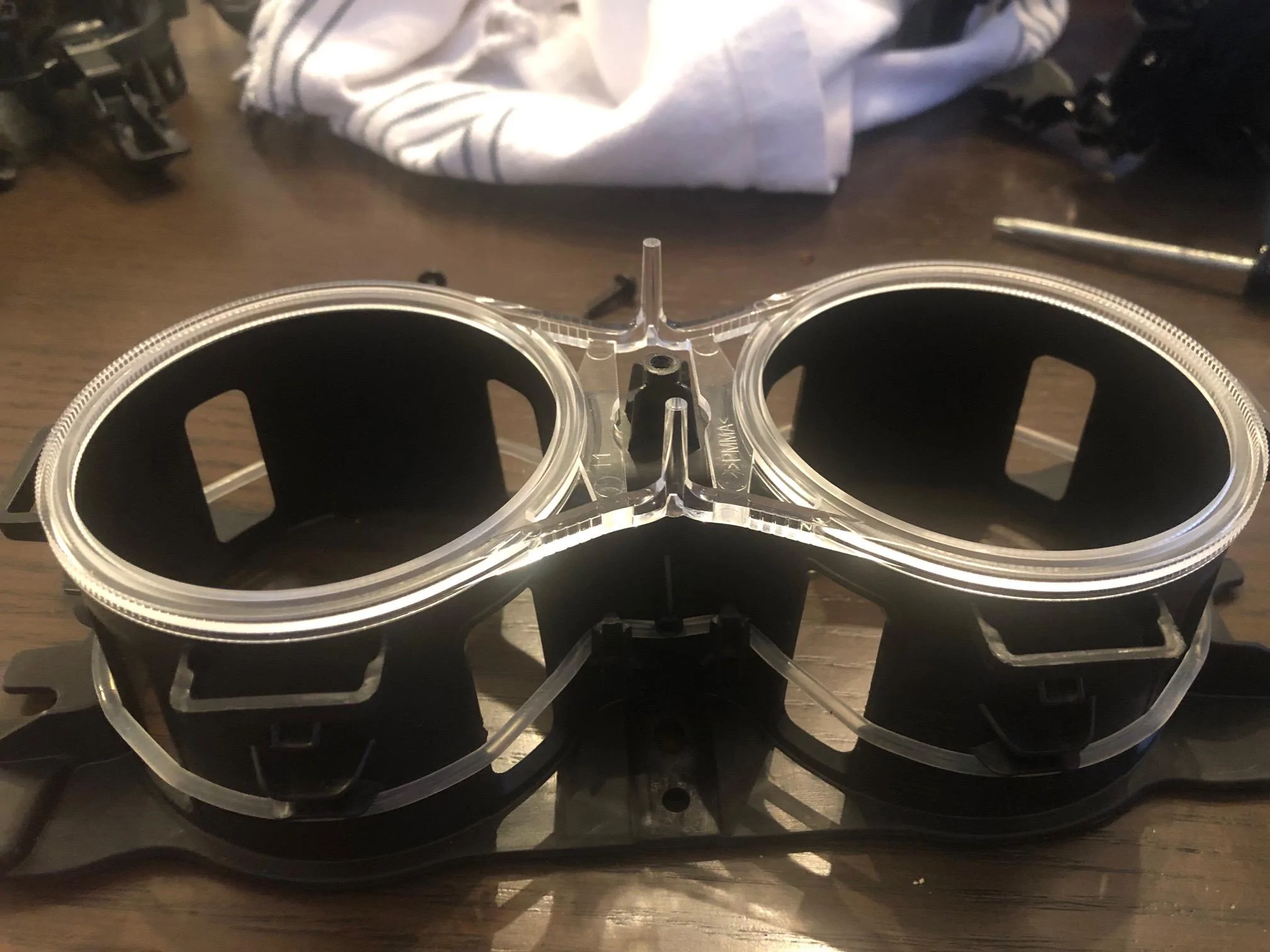

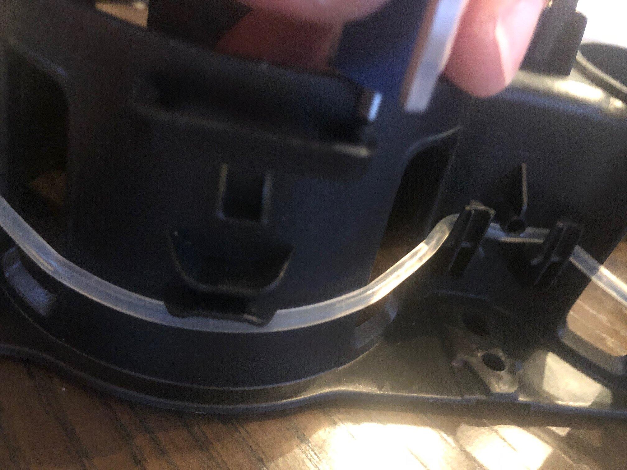

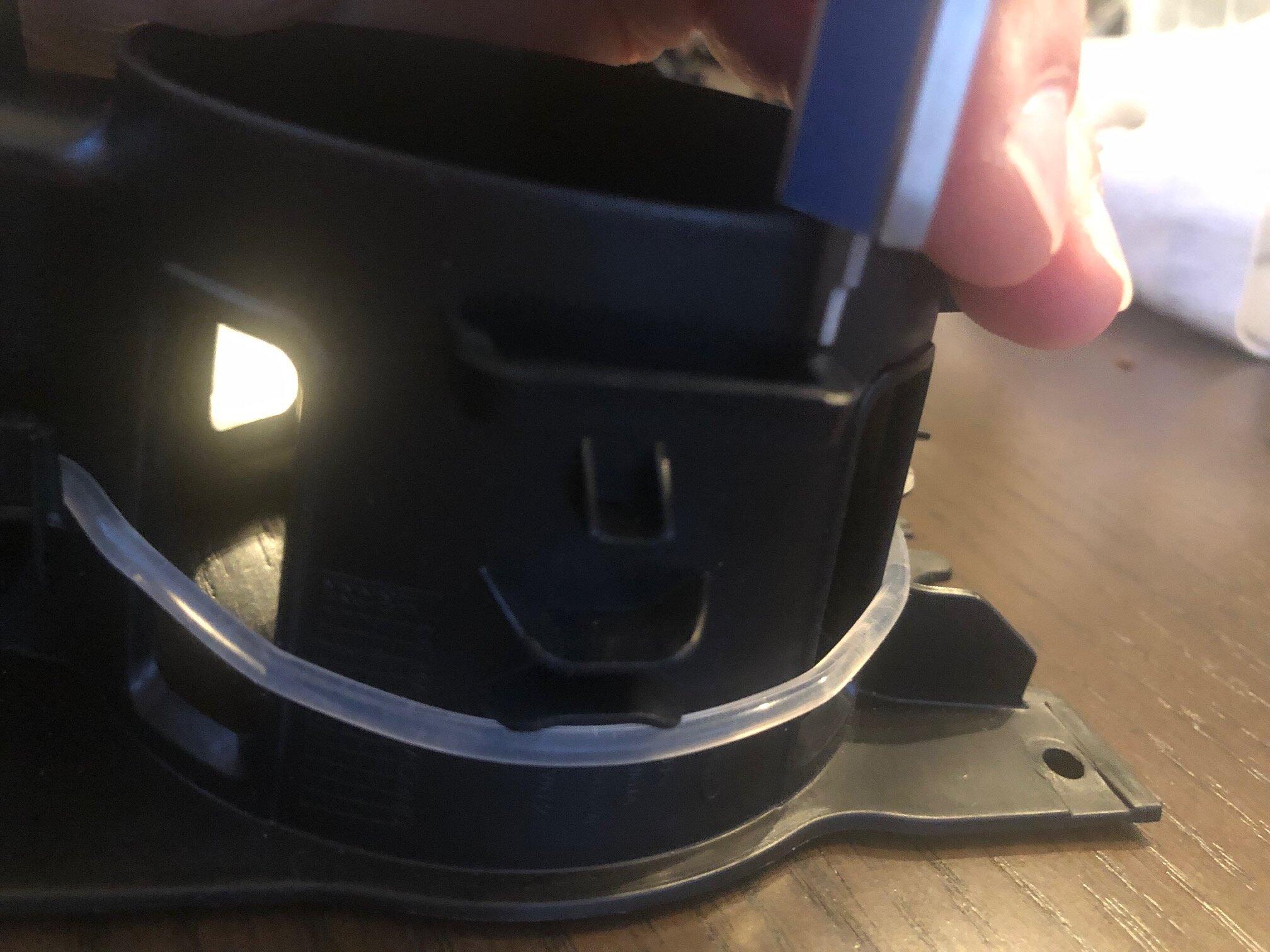

Ok guys im back with a new update, I apologize that it took me this long to get this information out there. I dont own an F150 so ive had to collect parts for this information. For you guys adding the light ring to your existing cup holder here is what you need to do. on the left in the picture is an OEM lighted cup holder, on the right is your factory one that youll remove from the truck. you need a belt sander(bench top). sand the cup holder flat till your light ring fits and the bottom snaps back on. if you look at the 2 pictures you can see the differences in the 2. if you sand the cup holder down almost flush to the middle section where the screw is your light ring will fit and it will all go back together just fine. if you look where the arrow is pointing thats what you need to sand. I hope this helps all the guys adding this in. If its needed I can get exact measurements for you but it should be easy to do.

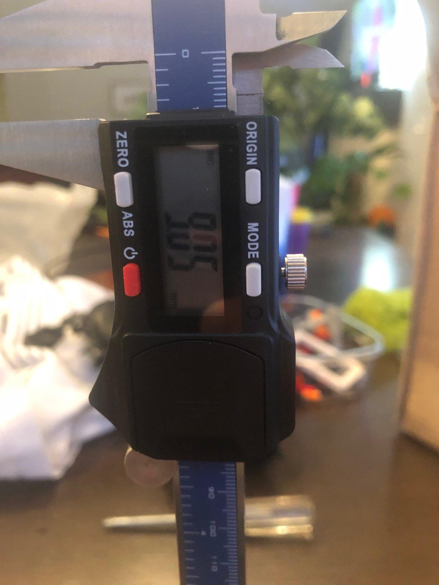

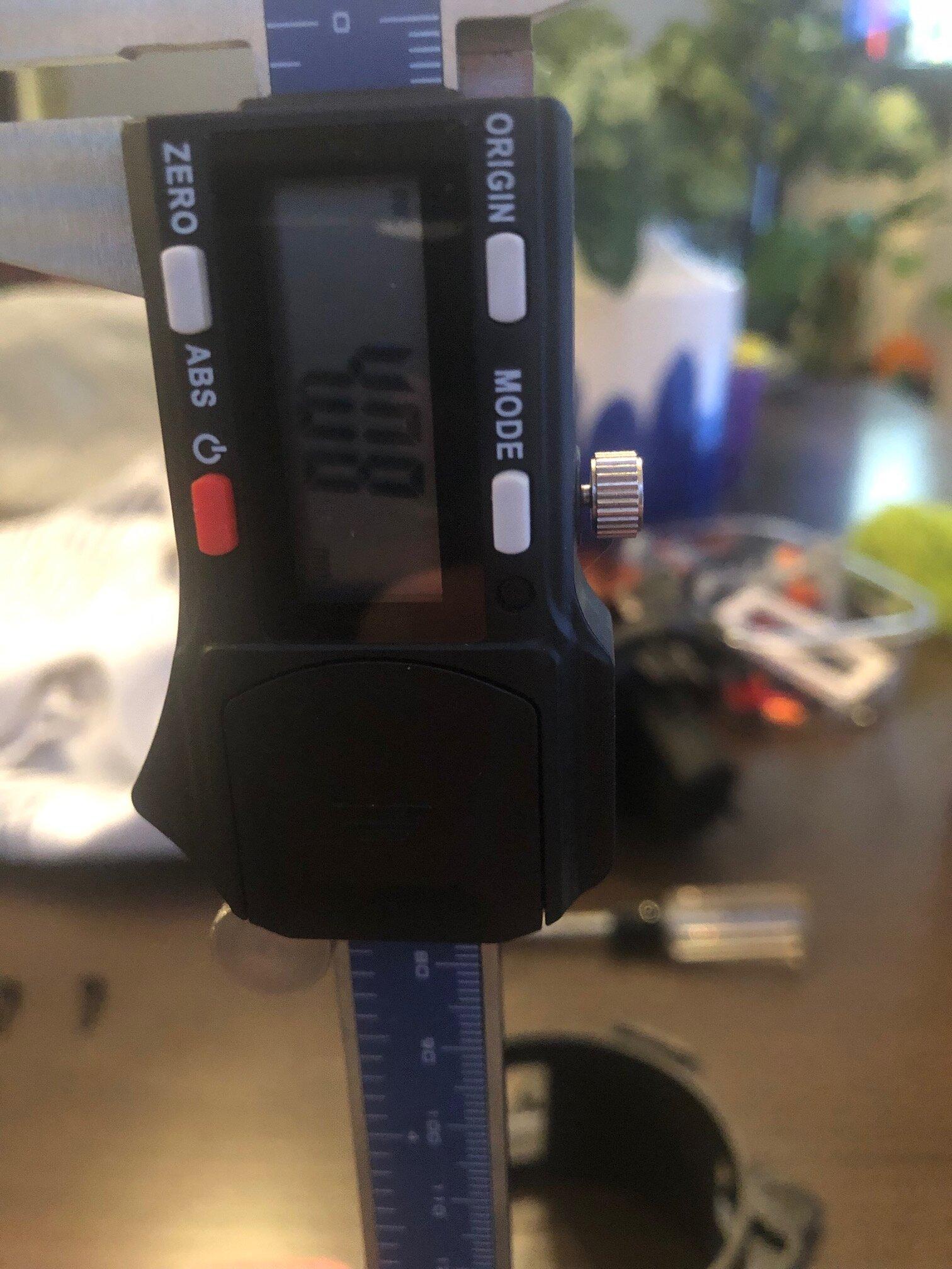

Ok at the request of a member i took them back apart and measured them for you guys. here is the factory cup holder this is measured to the band that clip goes under
Ford F-150 Lightning Cup holder light installation/media bin light/glove box light IMG_2308
Ford F-150 Lightning Cup holder light installation/media bin light/glove box light IMG_2309
heres an oem lighted cup holder
Ford F-150 Lightning Cup holder light installation/media bin light/glove box light IMG_2310
Ford F-150 Lightning Cup holder light installation/media bin light/glove box light IMG_2311
Ford F-150 Lightning Cup holder light installation/media bin light/glove box light IMG_2316

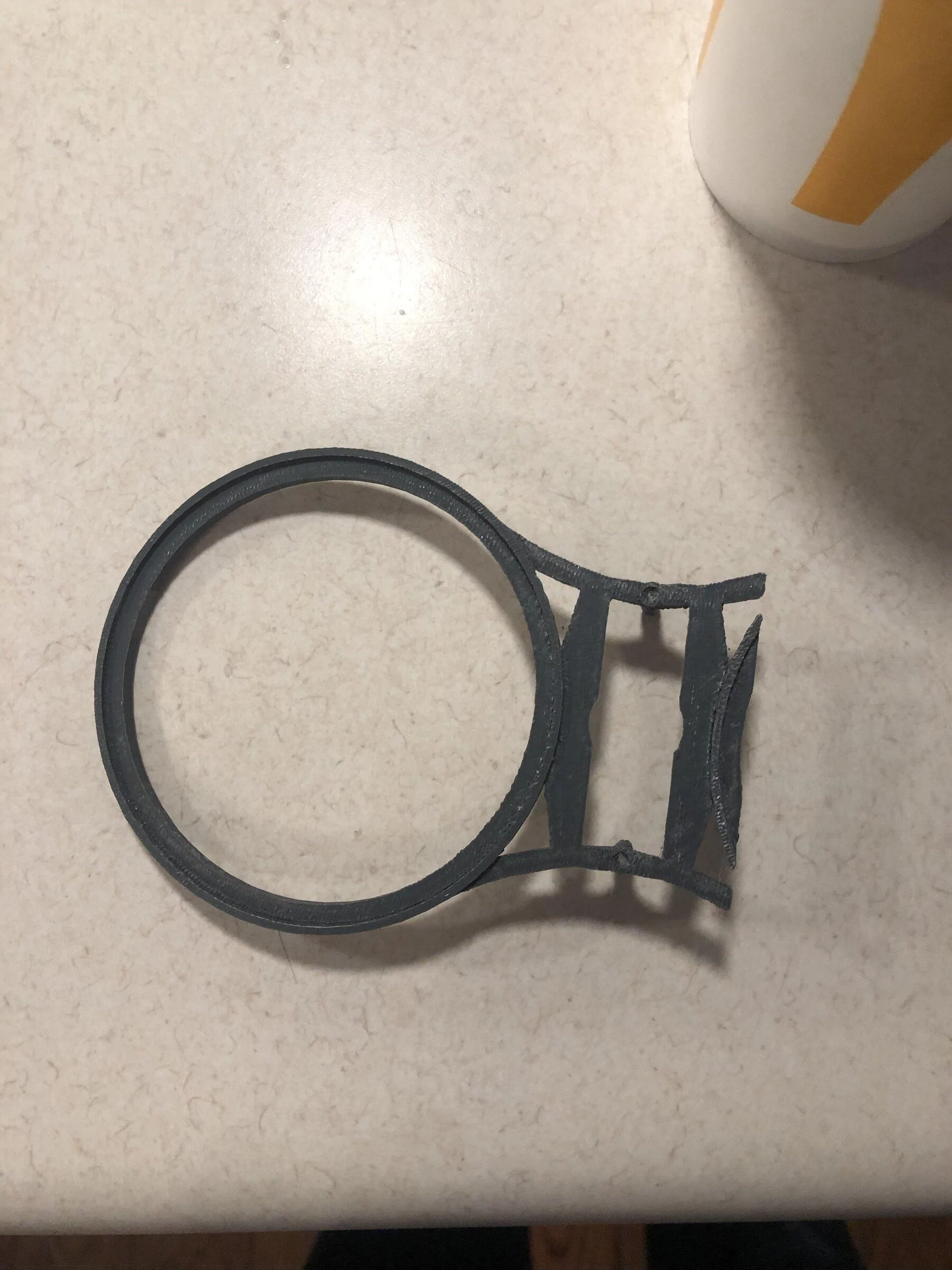

also yesterday it was asked of me why i dont tell everyone to get the full cup assembly in all my threads. the price is insane and congrats to people that get them but ive had at least 4 people say their cup holder(-CB part number) has arrived missing the light ring or missing the lights and ring. I have personally felt from the get go this part is priced incorrectly. with that said anyone that gets one and its complete congratulations!! I can build a harness to fit it also no big deal you just have to tell me you bought one of those and it was complete. also with that said here is one more thing I did for the community. I had my buddy copy the light ring and make it printable. IF you know someone who can 3D print clear parts here you go.
