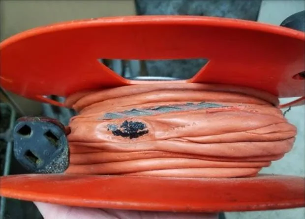

10 AWG will be adequate. @Maquis 's warning is valid and definitely the safest to make sure it is unwound. If you are only charging L1 through 10 AWG you'll be fine. I'd be worried if you were trying to do L2 through it. Leaving it in the bed will be fine, especially for L1.
