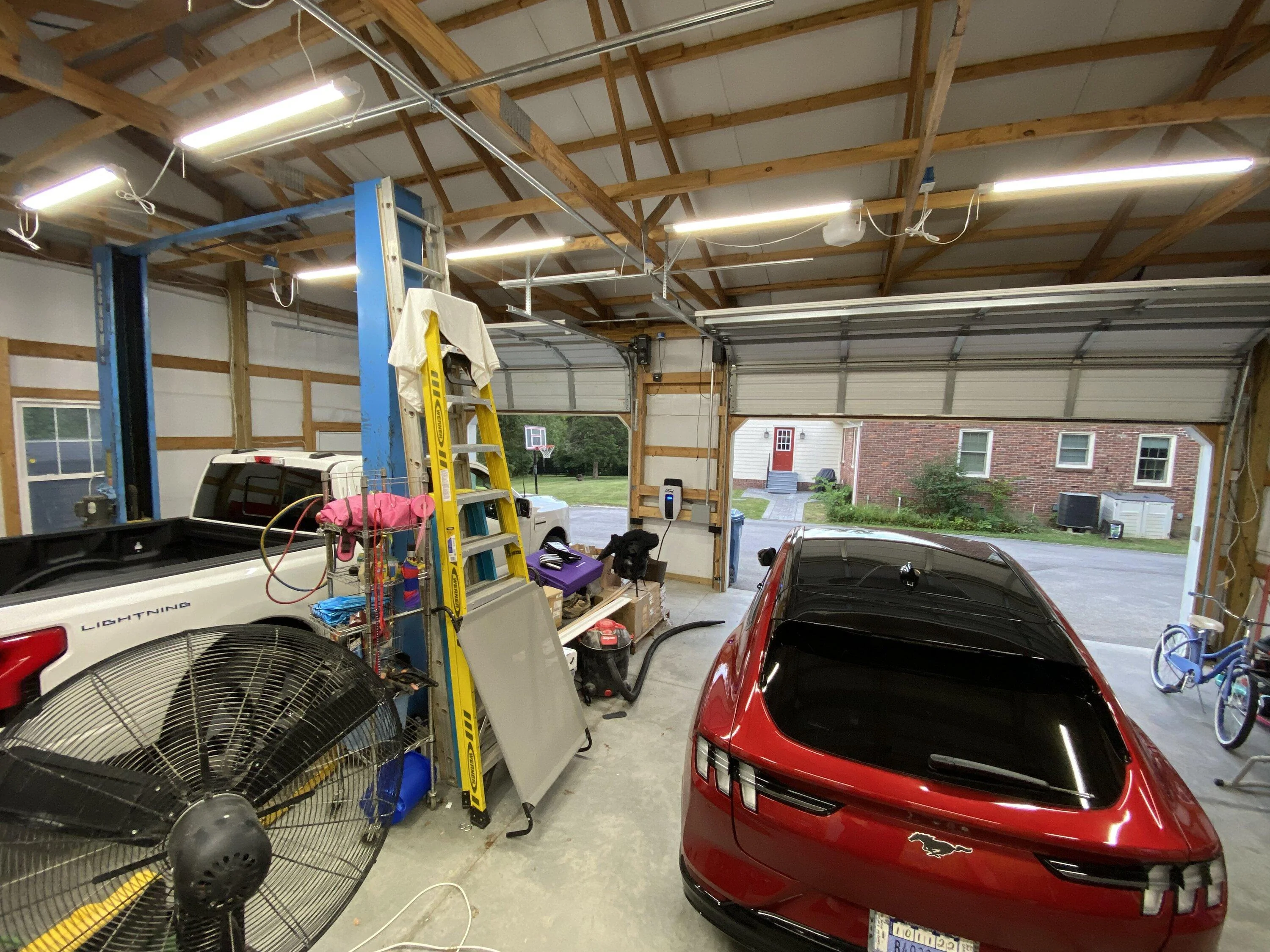

Since I now got my FCSP installed, I’m starting to think about cable management. I have 2 EV’s that need to share a charging cable (we each charge every other day) and it is mounted in the front of the 36x30 garage between the 2 car bay and the 1 car bay. Here is what my garage looks like:
