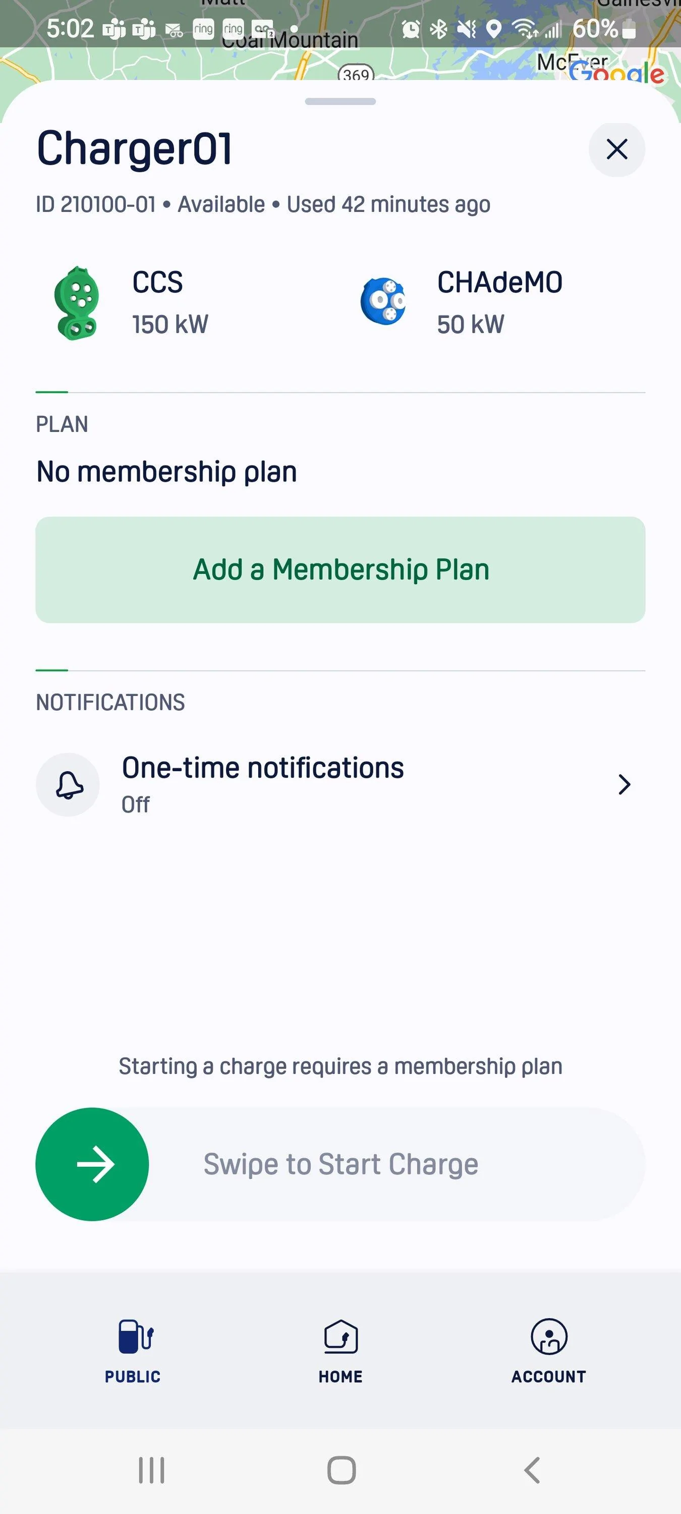

Anyone figure out how to use EA Pass+ separate from FordPass/Plug & Charge? I'm finally out of my complimentary kWh, and charging while away from home. I have the EA app and activated Pass+, but at the station it wants you to plug in first, don't see a way to choose which app/service to use. As soon as I plugged in Plug and Charge took over, so now I'm charging at $0.43 vs $0.31... After the fact I realized I could maybe just toggle Plug and Charge off before plugging in, and THEN maybe be able to use the EA app?

You have to use the EA+ app before you plug in.
If you want to get EA's Pass+ account, you must activate the charger with the EA app, then plug in

How do you "activate the charger"? I didn't see anyway to do that, it says "Plug in first" everywhere
If you click on the avaliable station, it will give you the option to start the charger. Ignore the plug in first statement.

🤦‍♂️ Thank you... Thought I tried everything I could in the app, first time user problems! Appreciate the assist
