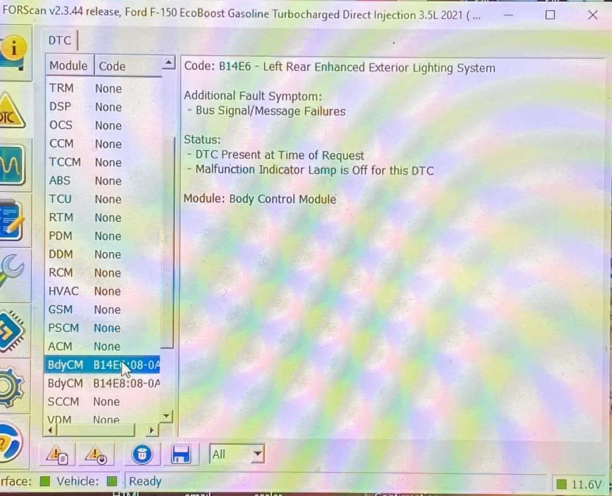

So I got the led tails, swapped the BLIS modules, installed my adapters and the reverse lights turned on.
thought to myself ok they will turn off after making changes in forscan. Make those changes and nothing. They stay on, while truck is turned on and off, doesn’t matter.
this happen to anyone else? It is showing 2 codes now one for each tail light.

Make sure you used the correct harness for each side, I had the same issue and realized weeka later I used the wrong harness for each side
