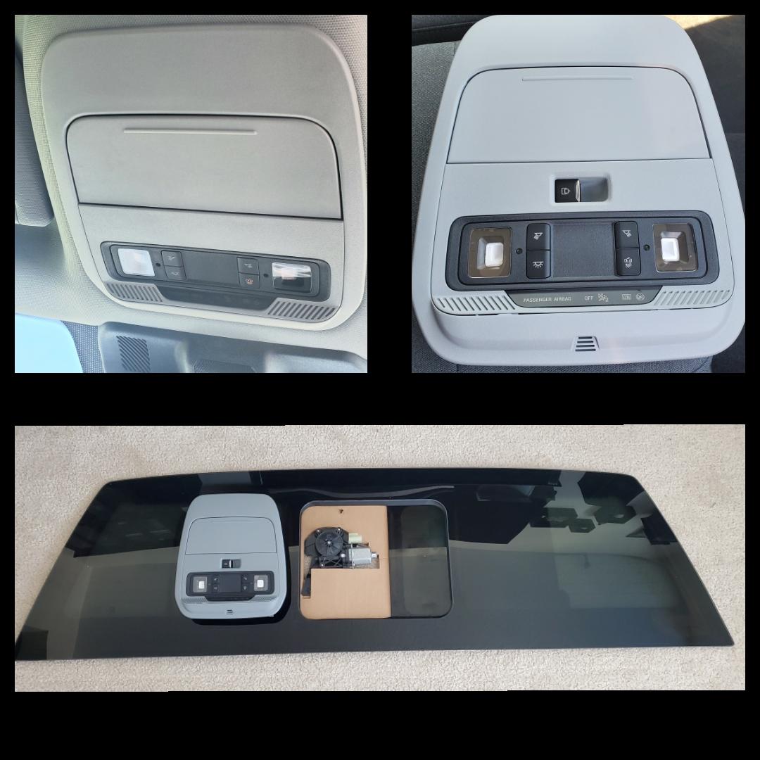

There is a 99% chance your new truck will be wired for the rear sliding window. You will only need to pin the wires that go to the switch in the overhead console, which you will have to get... a new overhead console with the rear slider switch. Im installing a rear slider in my RCSB XLT. My truck isnt wired for this upgrade so I will have to add all of the wiring from the BJB BCMB/BCMB relays. They sould be able to easily add the slider in your new truck. :)

It really isn't that bad..... especially if the truck is prewired for the motor. My single cab was not, so I added all the necessary wiring to do it as if it came from the factory.
How long did it take to r/r the window? One thing I also was concerned about is the side curtain airbags and as above, all the associated trim that would be disturbed. Did you also install the factory button? Thanks!

Side airbags are no concern as long as you follow 12v rules..... disconnect the battery and take your time removing trim parts. It's just a giant puzzle. I've had the interior of my 2016 crew cab cemetery removed to do alot of upgrading. As for the slider button, yeah, I only use oem parts so everything is oem. I bought a new overhead console with the rear slider button....
Ford F-150 Lightning Power rear window retrofit install? PCIMG_2021-05-08_13-10-02.JPG

It has been a few months but any progress with the rear slider project? What are the part numbers for the rear window and overhead console?
I read your post on installing a rear slider in your 2021. Thanks for good info! Wondering where you ordered the console with slider button? Thanks
