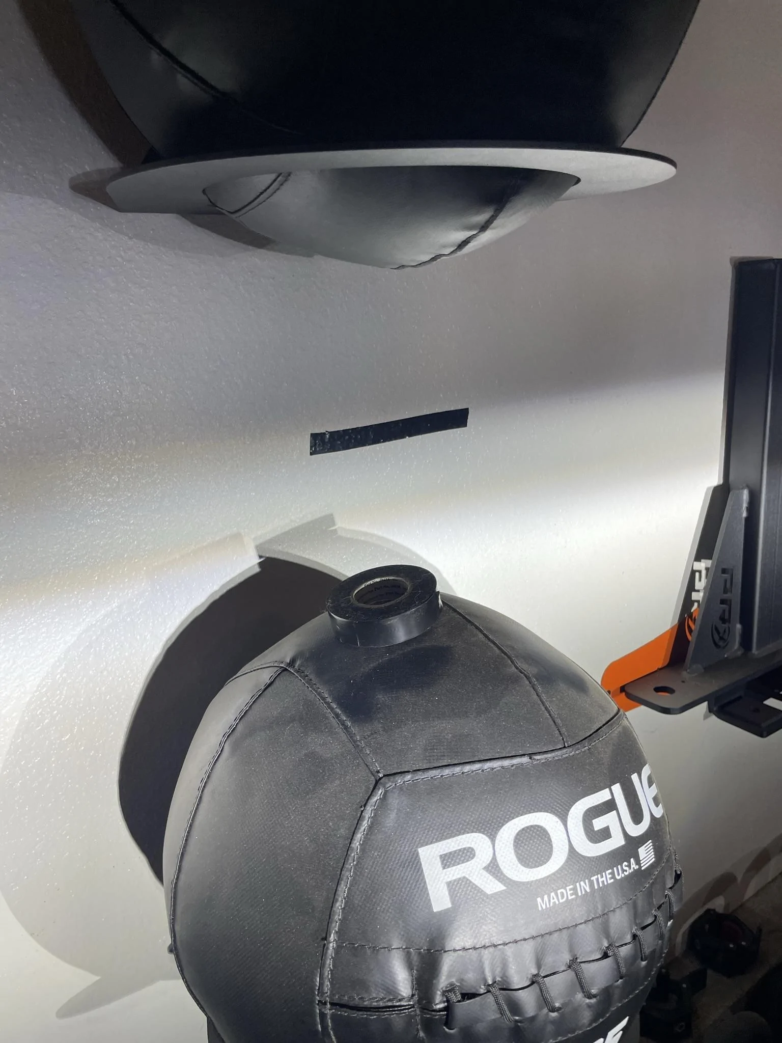

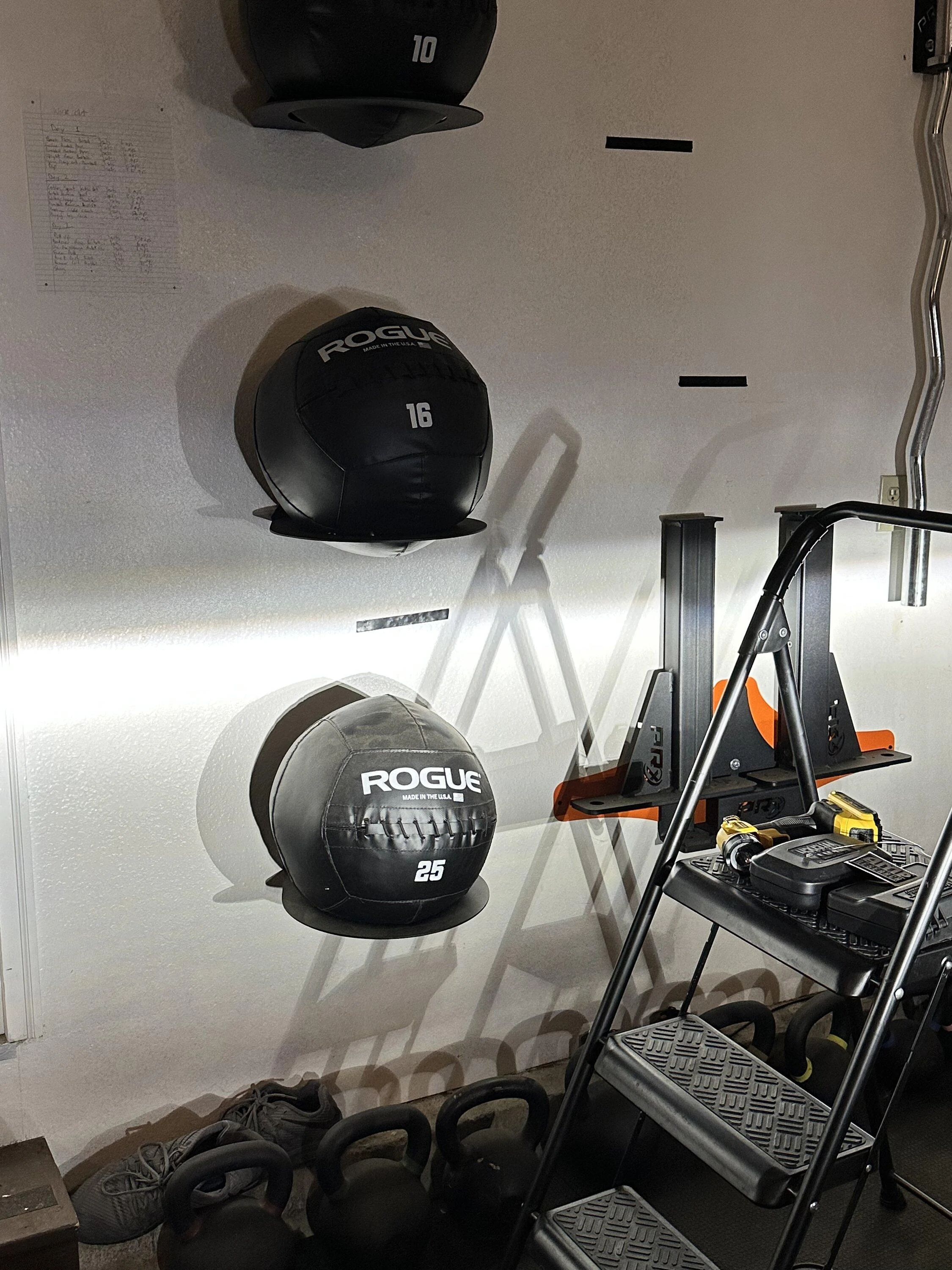

I did the readylift 2” recently and I taped the walls in my garage where the lights hit on low and high. They are definitely not the same and will need adjustment if you don’t want to be an asshole. Mine is a Pro so maybe the upper trims adjust automatically. Stock tires.

I finally adjusted mine. Was off quite a bit. I’m about 10’ from the wall so you can imagine how these things will raise up in 50+ feet.
What was the process ?
RavenYZF-R6
May 29, 2021
661
563
Denver
Tacoma
Pull off the plastic cover on each side of the fender. Then you’ll see a white plastic screw to turn. Up or down for it to line up. Went pretty smooth.
