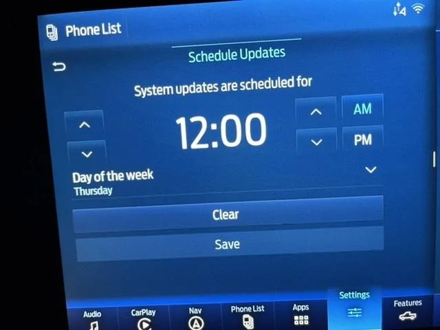

I can set and re-schedule OTA updates, but clearing an existing schedule does not seem to work (hitting Clear button seen below has no effect):

Anyone else having this issue ?

UPDATE - it seems I can set the schedule only once. When I tried to reschedule, no matter how many times I hit Save, the previous schedule shows up after re-entering schedule section.
Can anyone test this and confirm the same ?

I have had this same problem for a while now. Will not go to automatic updates either. Problems with my view on drivers information screen. I called Ford technical support yesterday. I was told they are aware of these problems and a few others. They hoped the “fix” would be ready in a few more weeks. Gave me a case number and thanked me .

JFYI - this issue is fixed in 21283 rev244 APIM (OTA 2.3.0)
