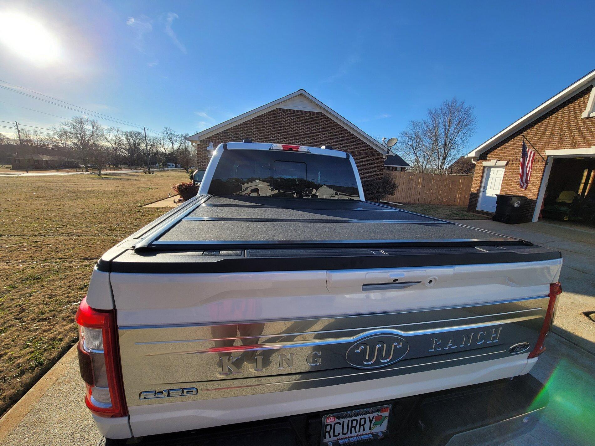

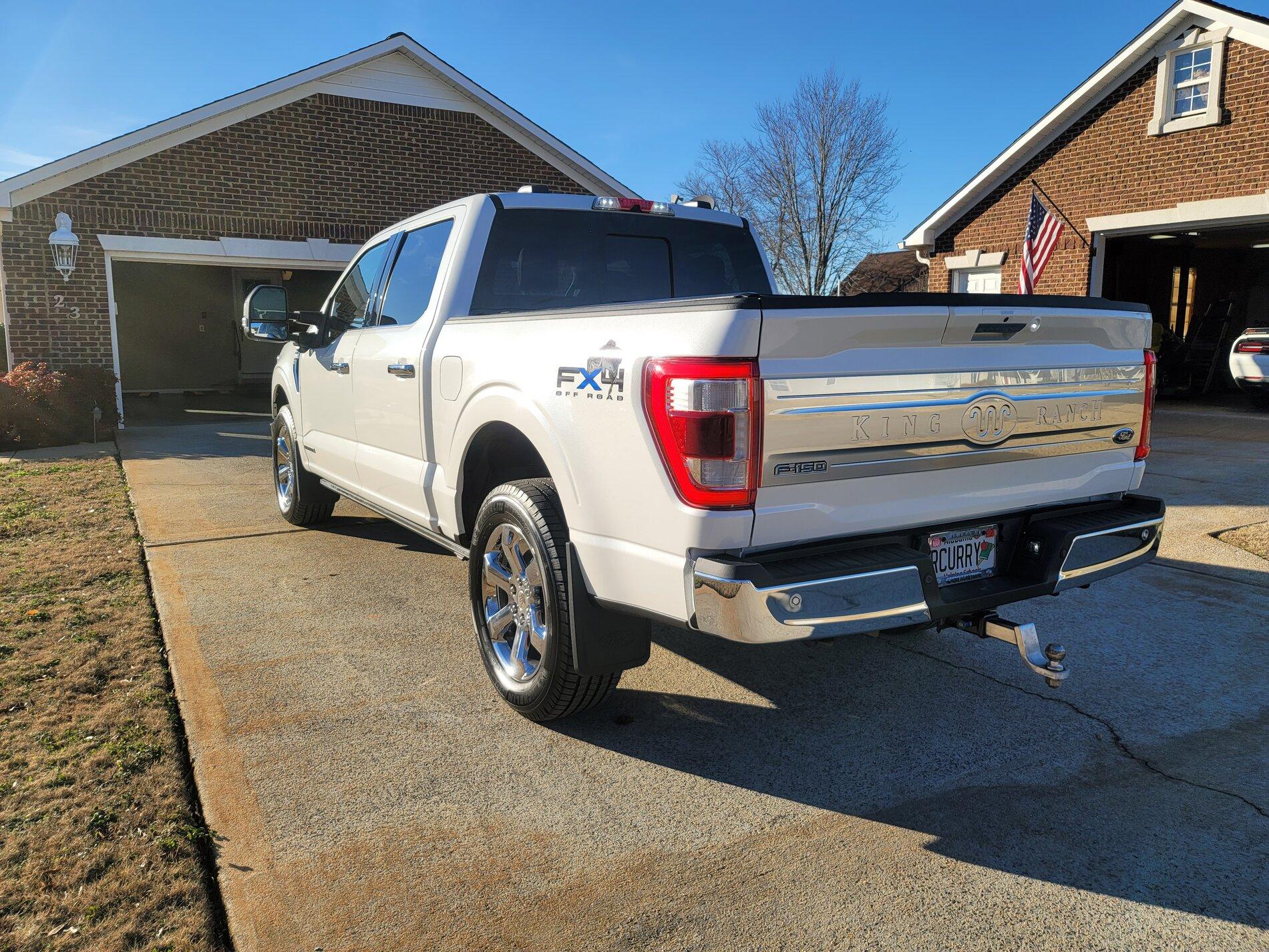

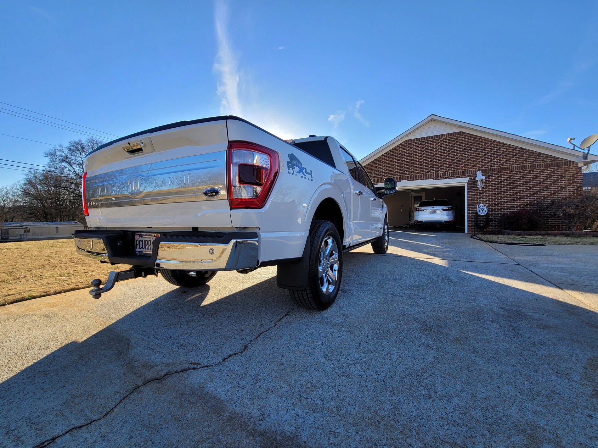

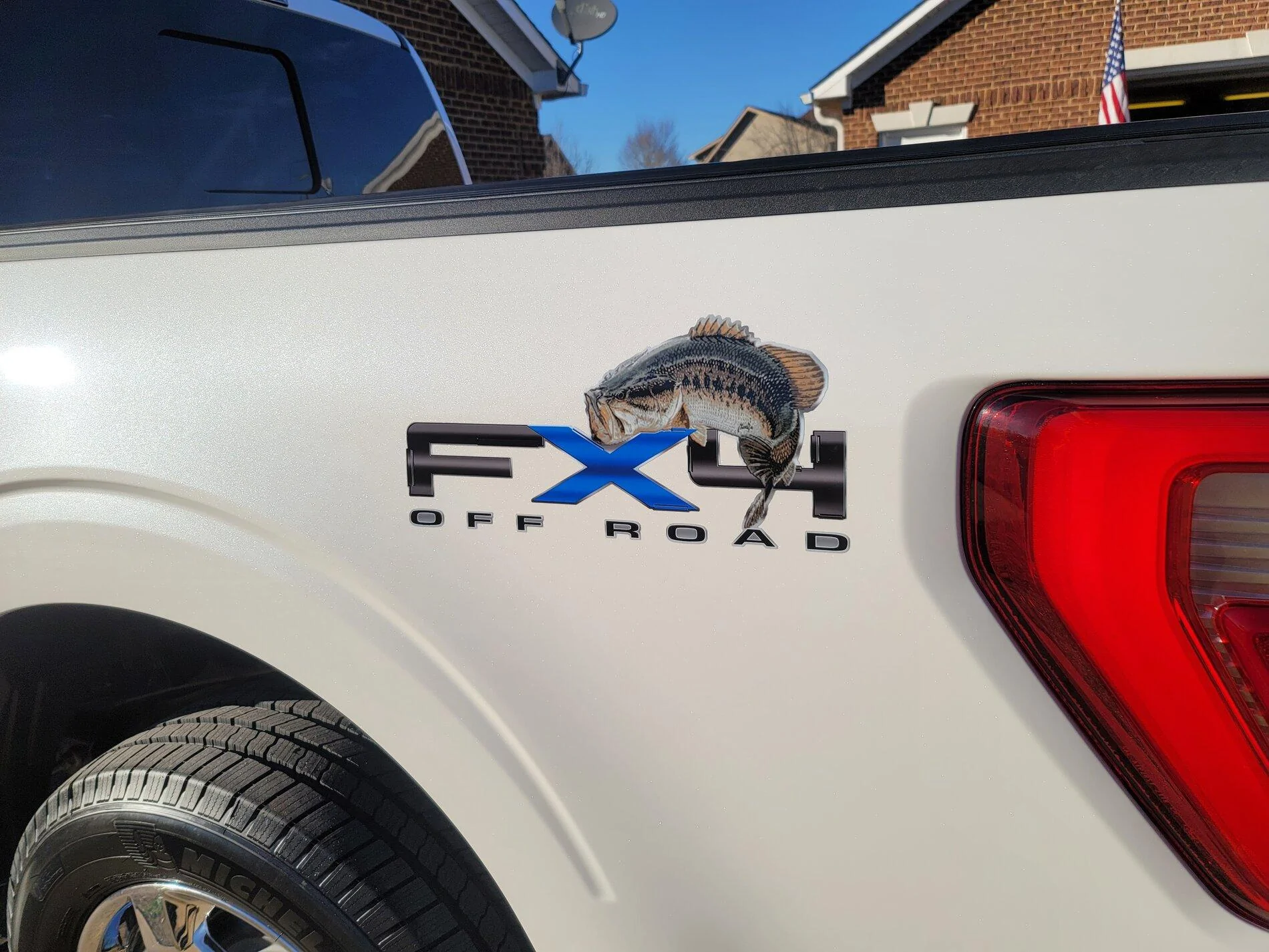

Got a bunch of stuff done today on my truck and removing the 4X4 sticker and putting my favorite one in it's place is a must for me. I'm a big bass fishing nut and had this same sticker on my last truck. Not for some I know but I like it. Got my mud guards, bed cover and a few other things I like to change.
Notice no dirty ole tail pipe showing.

You might have the most beautiful 2021 to date. And I’m not as much into fishing but that decal is awesome

Well thank you sir! I'm a proud papa. Lol

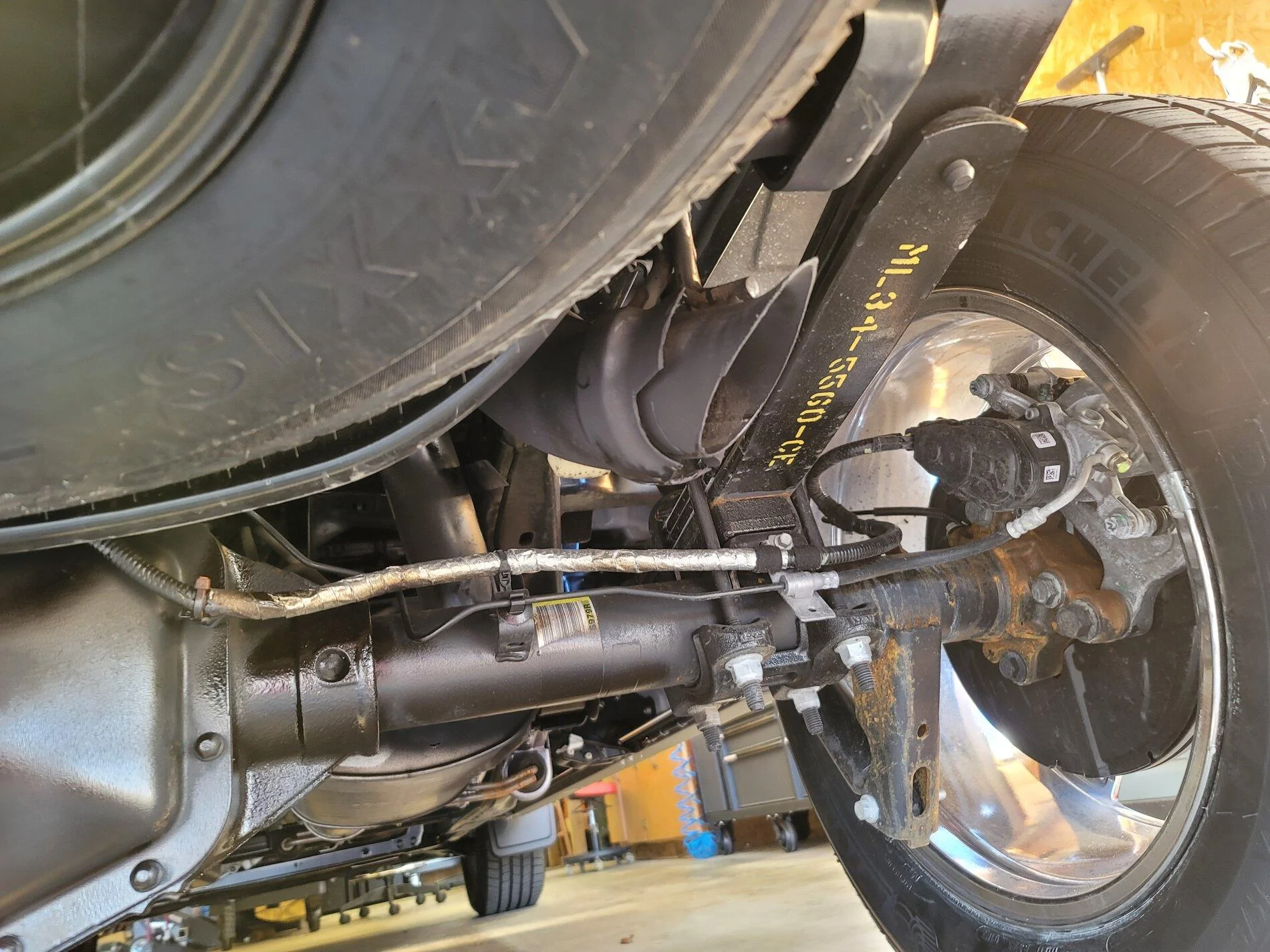

Thanks again Eric!
I assure you it doesn't. I added another photo showing the angle and you can see it's directed away from everything. If anything it might have a very slight reduction in back pressure because there are 2 bends in the pipe that were removed and that would be a good thing. These pipes are huge, not sure my 2018 was the same size or not.
I just used a sawzaw with metal blade and did it at about a 45 degree angle, trying to keep the exhaust going away from anything under the truck. I cut it right past the last exhaust mount, didn't want to weaken it any. I got some high heat black paint also for it, did not what it showing through the wheel well.
My 2018 had no exhaust carbon on it at all either when I traded it in.
I really would like to lower the rear level with the front is the only thing. I don't want to do anything to mess with the ride though because it is so smooth and handles better. I'm just not a fan of the jacked up rear.

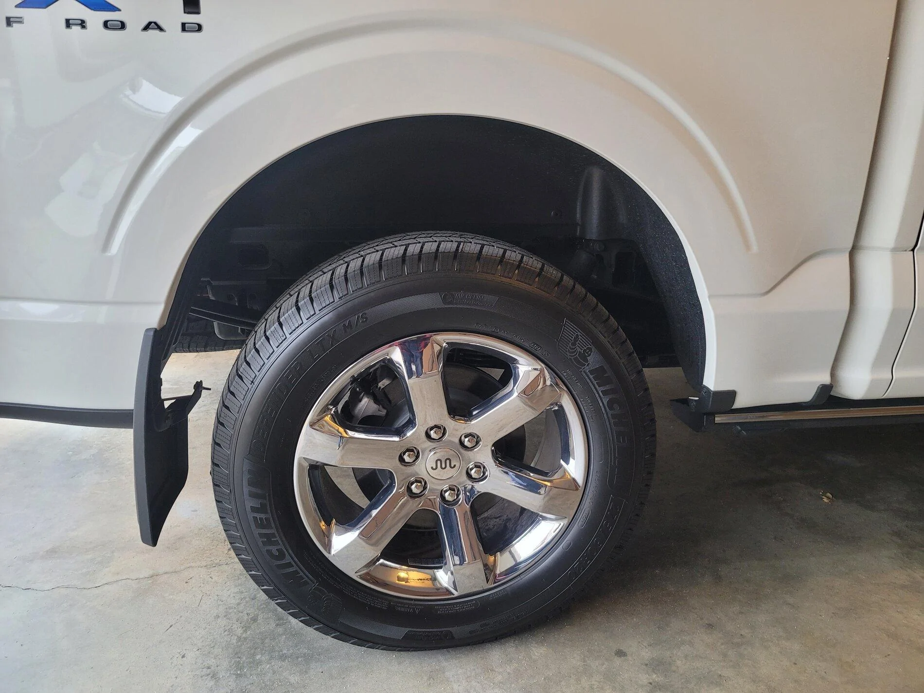

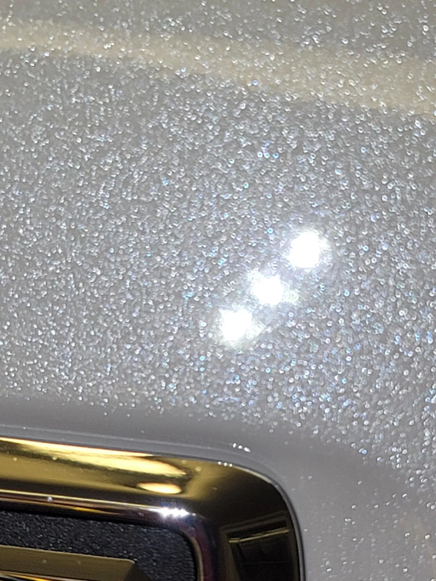

For kicks I once took a close up photo of my star white paint, amazing some of colors you can see in the sun up close, there is some ice blue that shows. The photo did catch it that well but I tried. Lol
Ford has done some really nice colors this year but for ease of care and in SE hot summer environment, I'm all about the star white. :giggle:

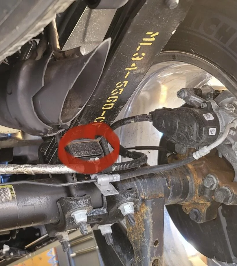

That color looks great. Those three stage colors always look good in the sun.
You can remove this block, it won’t get you even but will drop the back a little. Never heard of anything detrimental from removing those since it’s only on 4x4s, and doesn’t change anything enough to effect driveline angles etc.

That is not a bad idea! That amount would be very close and I have heard of some people doing that have just never talked with anyone that has. I guess that block is not glued to it or anything is it? May start a new tread asking if anyone has.
Thanks for the idea Zyvin!

I'm not sure you really can remove that spacer. The Suspension Deep Dive article listed that spacer as being there because the spring packs were thinner than in past years. And removing the spacer could impact ride if it changed the curvature of the leaf springs at rest, I really don't know. Also looks like the U-Bolts would have to be replaced as I don't think they are threaded up high enough to account for the removal of that spacer. Just some things to think about, but I have never removed or added spacers to a leaf spring setup, so I am just speculating.

They are just sandwiched in there. I have only seen 1 or 2 out of hundreds online that had some vibration, but the ones I saw were single cabs/short beds (shorter non-split drive shafts). However, they do make angled shims for the vibration, but again I’ve not seen issues on crew/long bed/extra cabs.
I saw that with the u bolts and figured they would have to have shorter ones. If there is any determent to lower it this way then I'm out. This thing ride much to smooth and handles better and I don't want to reverse any of that.
Guess I want someone else to do it first and tell what happens. Lol
