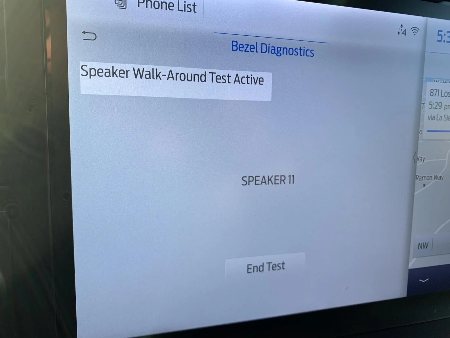

Just stumbled on to this today and haven't seen this mentioned on the site. If you hold down the forward buttons under the main screen and on the steering wheel simultaneously, you can bring up a Sync diagnostics screen called Bezel Diagnostics. It has pages of information and diagnostics for the APIM, AHU, DSP, ICP, TCU, ECG, Connectivity and many more. Sometime it will come up with just holding down the buttons but usually when I hold them down I will get the DSP Speaker Walk Around Test (which is a great way to test that each speaker is working)

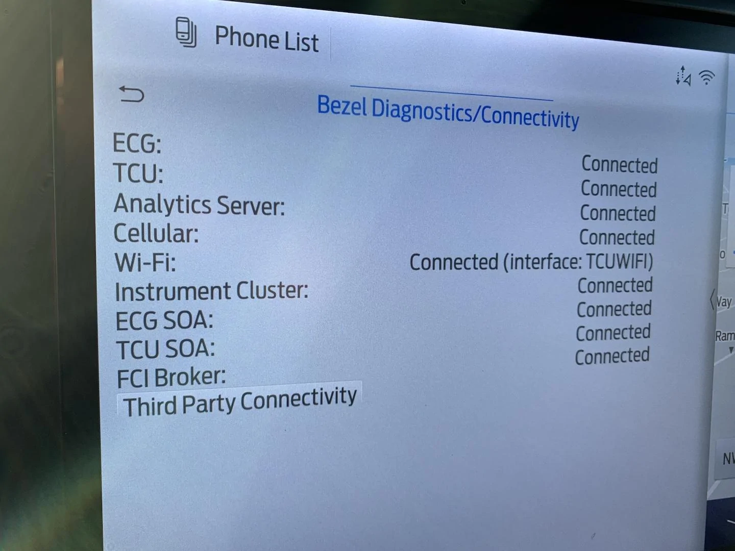

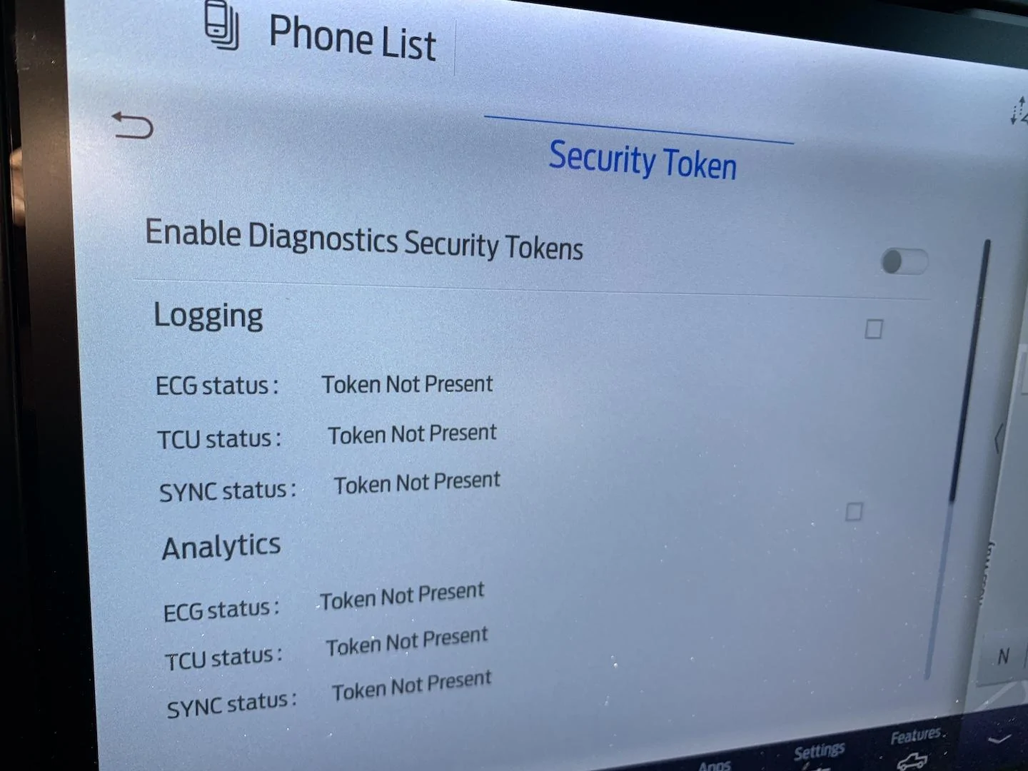

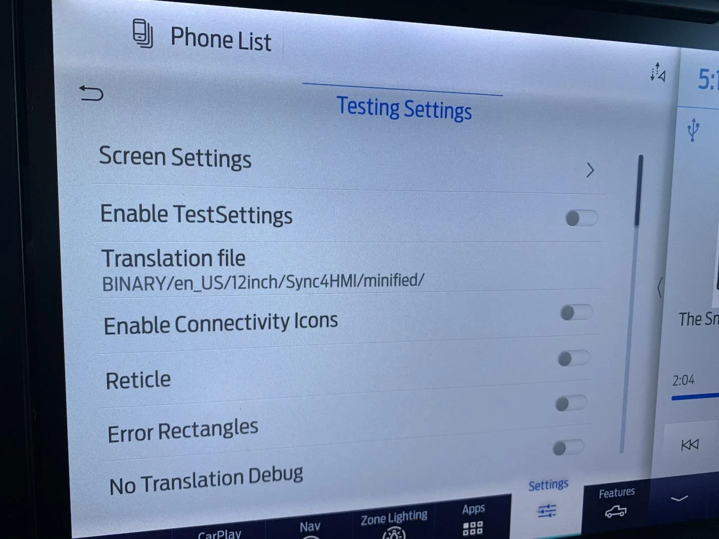

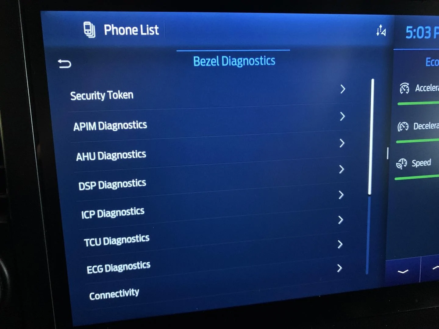

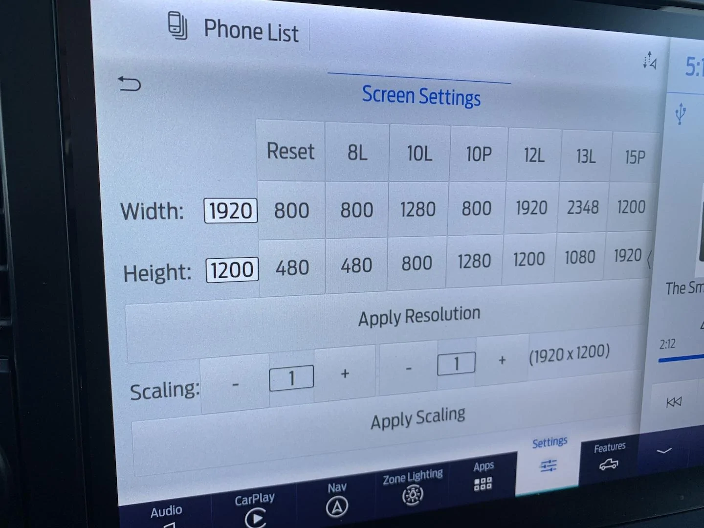

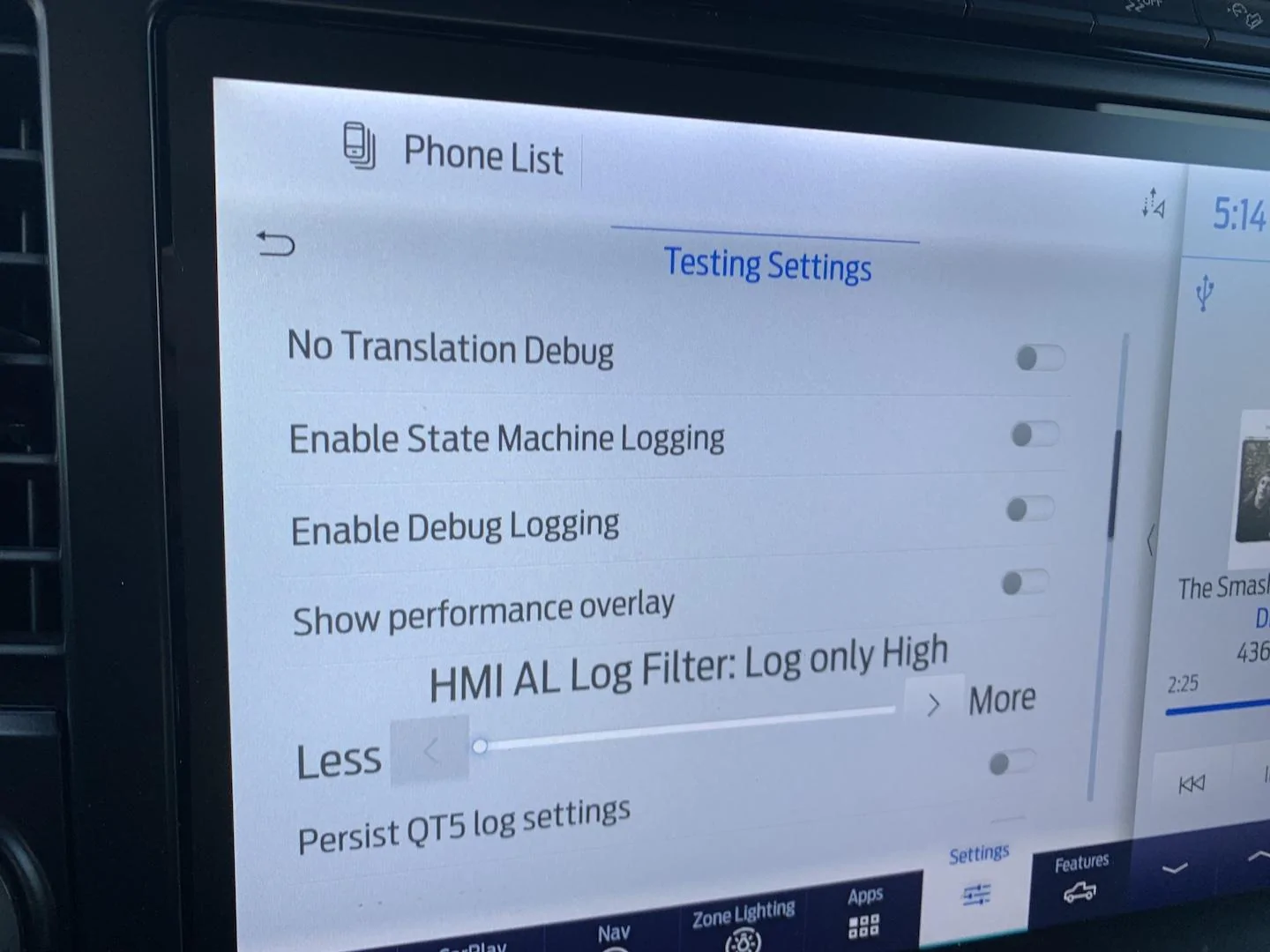

If you hit the End Test Button, it brings up the Bezel Diagnostics Screen. Each options has lots of data about software and hardware versions. Thought if may be of use:

Be careful in there, I didn't no how to exit so I pushed " exit gracefully " the screen went blank and it was 4 ignition cycles before it came back on. I guess I stuck my finger in the mouse trap! ?

If you scroll to the bottom there is an "Exit Diagnostics" that has worked for me.

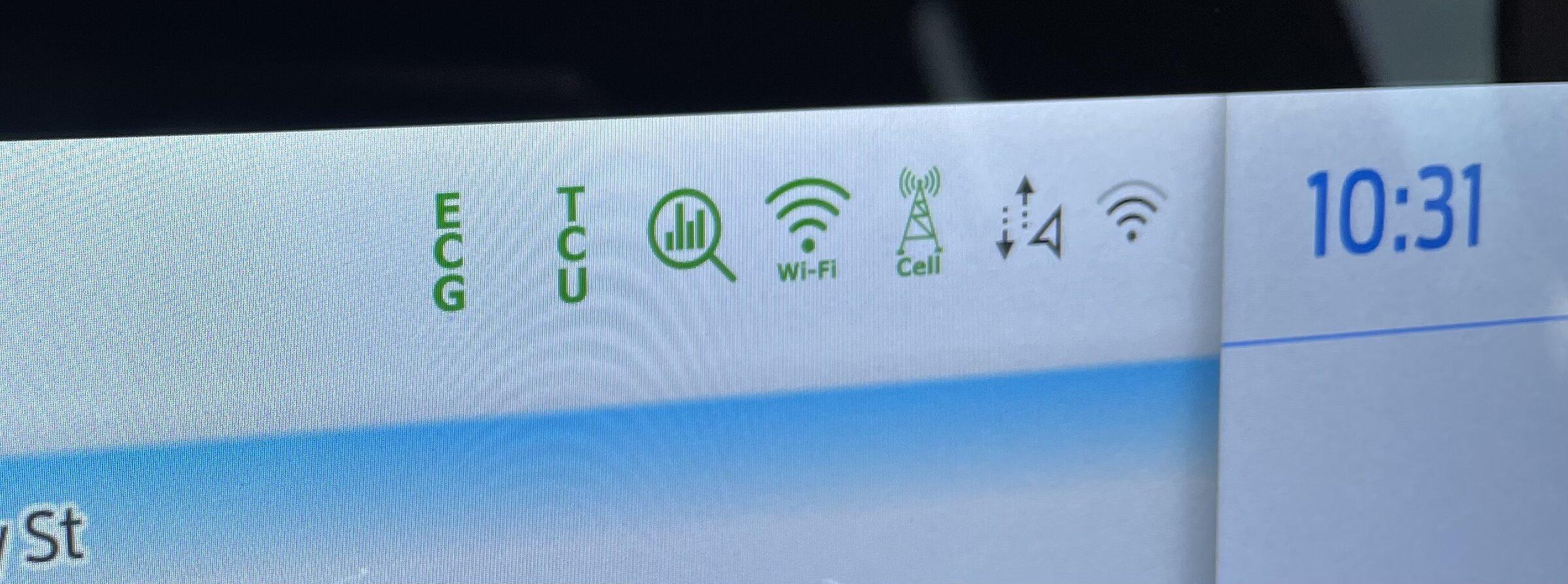

These come in handy and can be left on.

Where did you find that
Toward to bottom of the menu. Think it says connectivity or something like that. Just exit normally, not gracefully and it will stay on screen until you turn it off or till you do certain updates.
