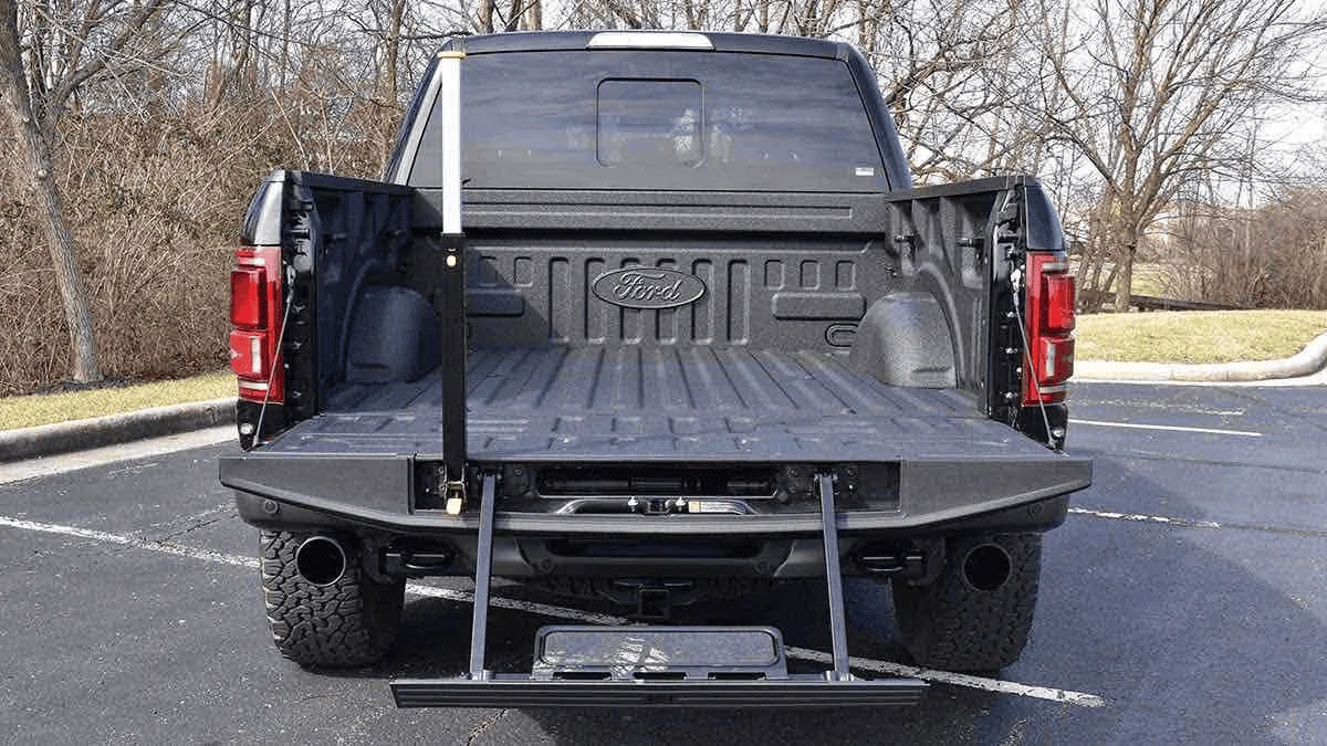

I have found that if the tailgate step isn't fully seated the power tailgate will just beep. I accidentally hit the tailgate step sometimes when I pust the tailgate button.
Release the tailgate step then push it back in to place. Try the button.
Apologizing for the thread hijack, but why does it look like you have exhaust pipes? Of do you also have a F-150 ICE in addition to your Lightning?

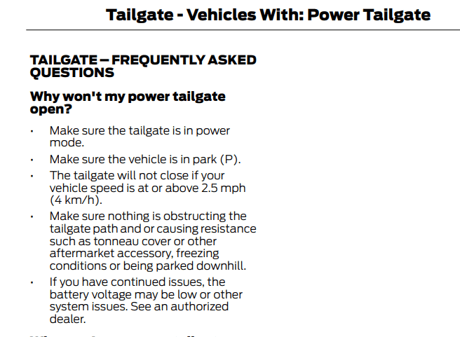

Per the Owners Manual. Think most of these have been already suggested but worth a shot...
Thanks for that and I have done all of those also lol. Ya I checked all the other posts and anything else I have found online. And I’m sure like most others the dealers are booked way out and very hard to get into. So was hoping to find a solution that I could solve on my own lol.
