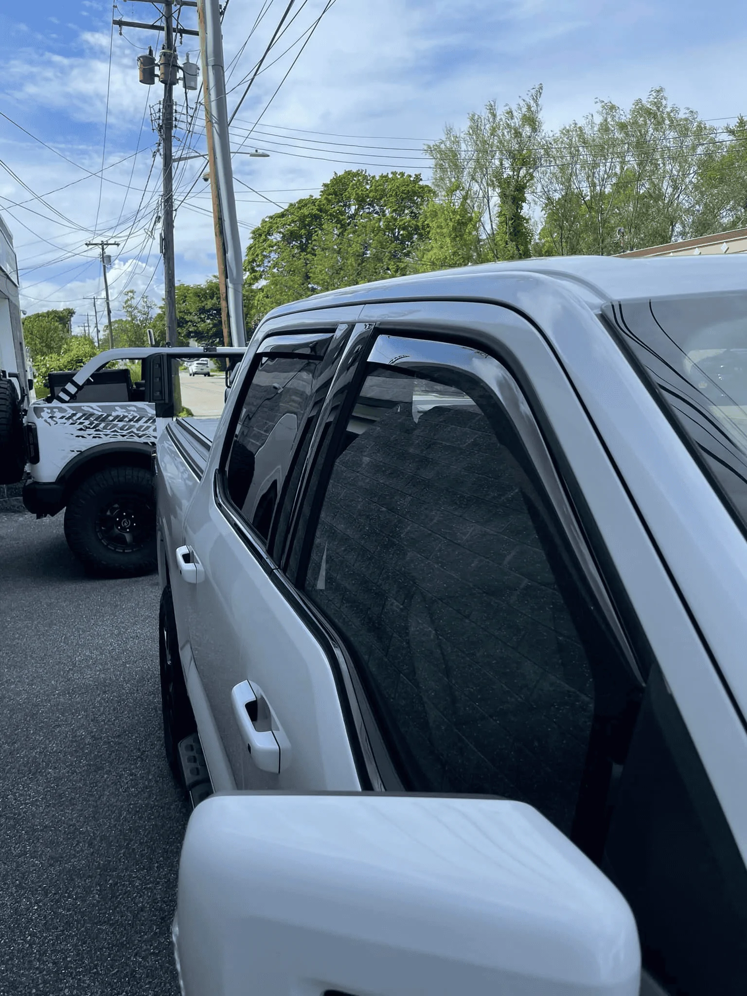

So we sell these Weathertech Vent Visors at our shop. I was looking online to see about getting some for our new Lightning. Naturally Weathertechs site doesn't show the 2022 Lightning... or the 2022 F150... OR the 2021 F150 for Vent Visors, weird.
So we started looking at other brands and when we went to order, they said "2015+" so I said "hmmmm I WONDER..."

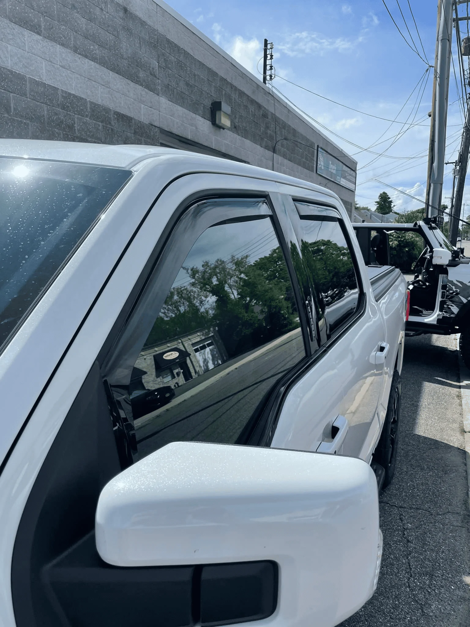

Grabbed a set of 2015+ F150 vent visors (probably for 2015-2019) and they appeared to be the same size. The only issue we had was the front lip. These vent visors sit in the channel and sit on top of the door lip. It wastoo long. Sooo I just trimmed a little off. PEFFECT! I threw on some helicopter tape to prevent it from scratching the soft plastic on the door trim and installed them.
They are currently "baking" in right now (you have to leave the windows up for a few days to SET them, otherwise they interfere with the auto-up and get caught).
We shall see how they actually work in a few days, so far so good. Im not sure WHY Weatertech has not made them for the 2021/2022 F150s yet. Maybe they gave up after people complaineda bout the auto-ups getting stuck. For now though, these will work great.
