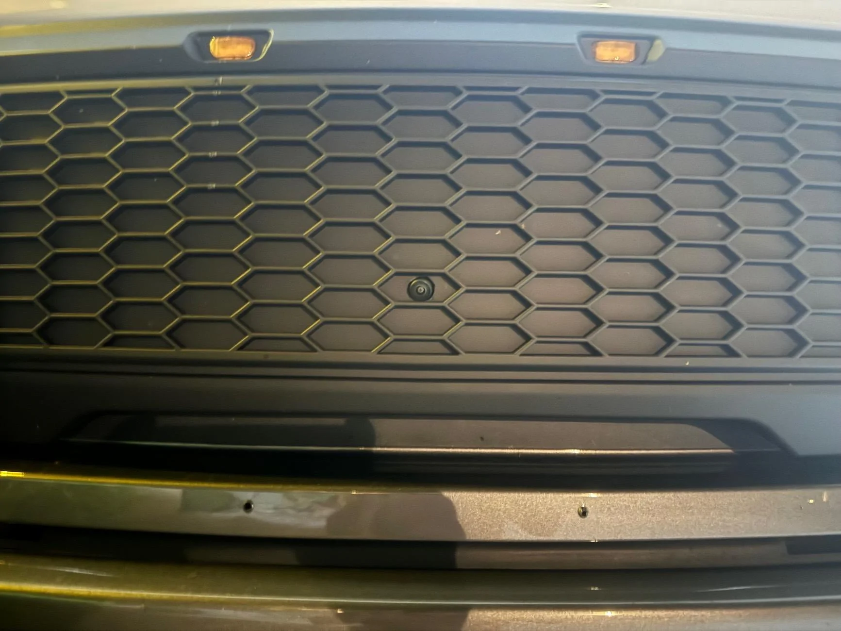

I didn’t get install photos, but the camera is in just about the same spot as the OEM grille.
And I used the camera mount that is flush with the OEM Ford circle, so it’s taped for now flush on the grille so the angle is the same as the OEM grille

It looks aligned to me. I still have to epoxy the camera mount to the grill. Then it should be perfectly aligned since the camera is mounted in about the same exact spot as the OEM grille.
When I disassemble it a little so epoxy the mount, I'll get some more photos.

I used the oval mount too. I think I'm going to switch over to the old raptor mount though as it projects a little more. Got one on order. Fingers crossed.
I was first thinking of trying to use the oval and cut out a hole and mount the entire oval onto the grille. But I like the clean look how the grille looks now. When I get time, I’ll take the duct tape off and epoxy the camera mount in and put some silicone between the camera and the hole and be done with it.
