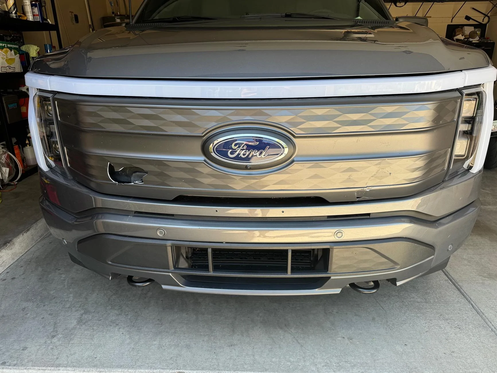

I had an incident and trashed my grille.
I ordered the one in the photo.
I have a 2023 Lariat without the washer.
here’s my grille and bought it from this place.
Hopefully all I have to do is cut a hole for the camera and hot glue it in.

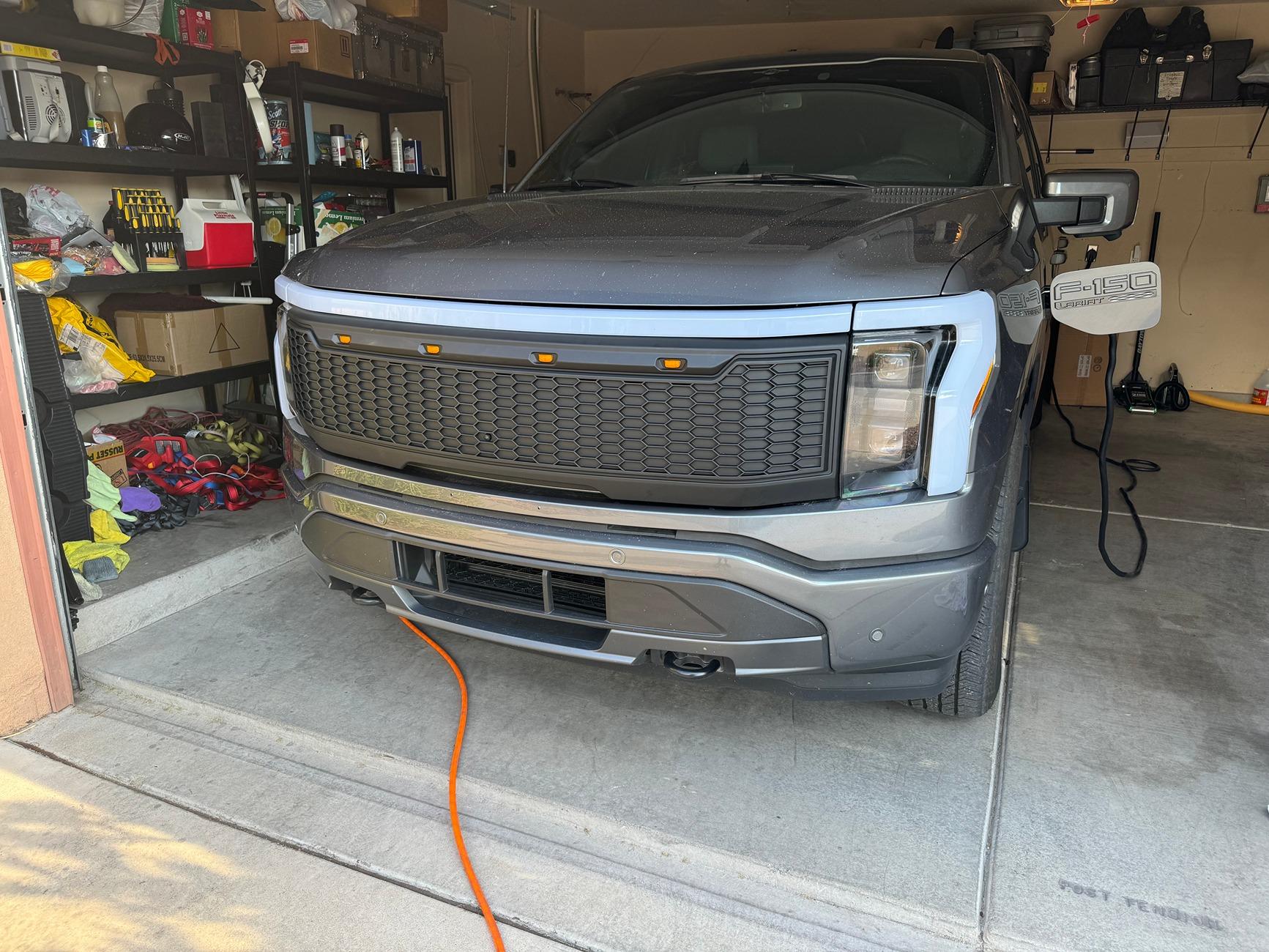

I switched my grille a few days ago. I only had a few hours until leaving for the lake so I have it partially done. Getting the old grille off was super easy except for a few bolts that were bent from the tow straps putting holes in the grille. I didn't have any epoxy on hand so I removed the FORD oval and took the camera and mount (non washer) out.

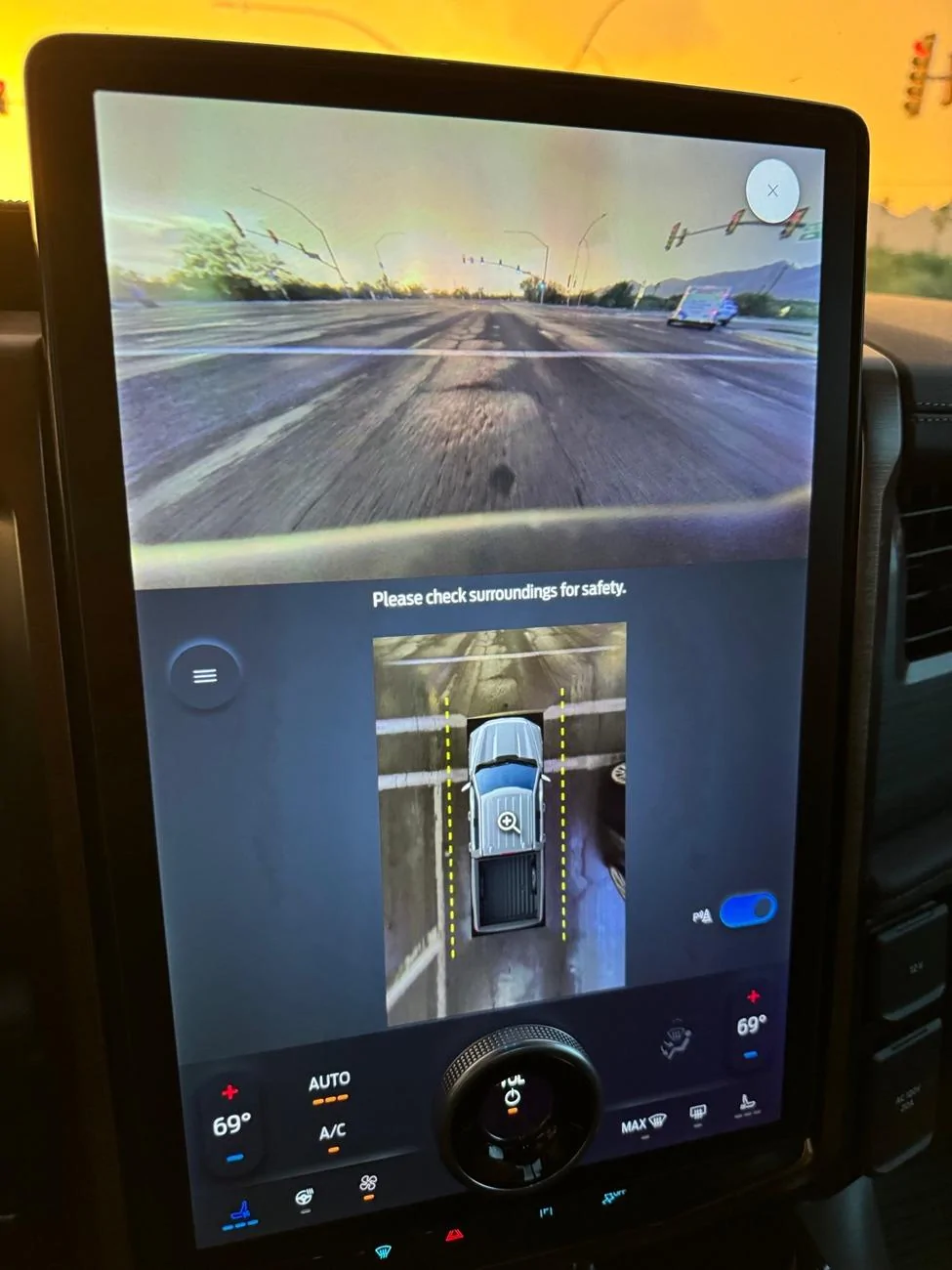

When pushing the mount against the grill (like it is on the OEM), the camera is at the stock angle and positioned close enough.
But the plastic line below the camera is barely in view of the front camera screen.
I just duct taped the mount to grille. When I get more time, I'll epoxy the mount in and shave the plastic under the camera so it's out of view and also silicone around the camera hole.
All in all, I think it looks better than the stock one, or spending $1,200 on a new one, or $700 on a used OEM grille.
Washing is easy too, I just pressure wash in the slots and it gets all the bugs out, but it does throw some water back at you.
I don't think I'm gong to add the FORD letters as I think it looks better this way.
To me, this was the easiest way instead of trying to epoxy just the camera to the grill and getting the alignment perfect.
