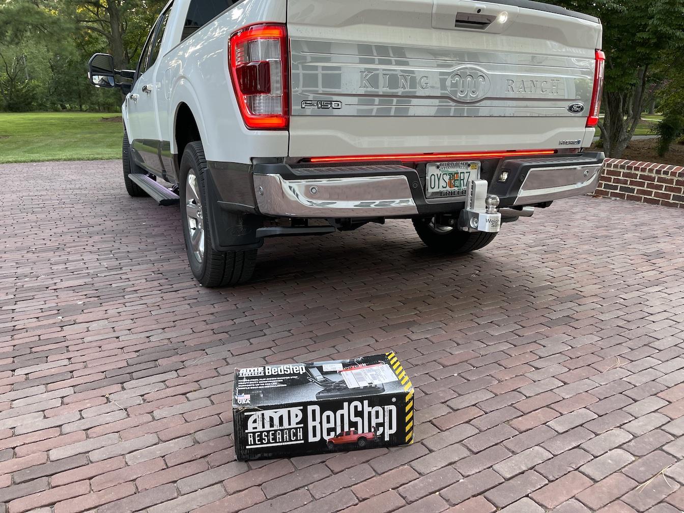

I'm struggling a bit with whether to add one of these and the under-tailgate light bar and the LED downlight strip under the running boards that I have on my '21 Powerboost. Seems like these would have minimal draw, but range is EVERYTHING with an EV, and adding any sort of electrical draw for aesthetics only seems a bit counterproductive. But still tempted.

The newer ones don't have bulbs - just continual line led strip - and they change color to amber for turn signal and bright white for backup lights - The one on my '21 PB goes bright white for backing up - lights up the whole area behind the truck, way brighter than backup lights.

Let us know if you go with light bar. Careful reading for the one I was considering said not to install it if you have trailer assist and BLIS.
That's if tapping into the trailer wiring, makes it think a trailer is attached.
Yeah, there was an issue with that, my installer had to work with Putco engineering to isolate the light blade, I think it involved extra wiring and resistors, not real clear, but it works and BLIS is okay. But now that you remind me, I'll probably not do it again on the Lightning.
