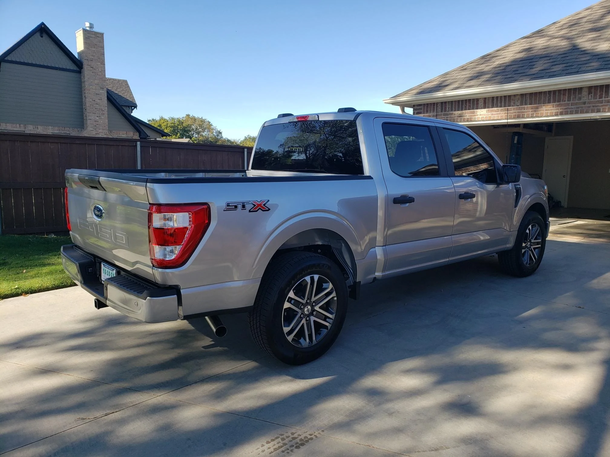

If pavement princess, the 20's will look better IMHO, I think you will be fine. My 2021 STX 20's rides amazing.
Ford F-150 Lightning 18"vs 20" wheel ride quality 20211031_153930_resized
