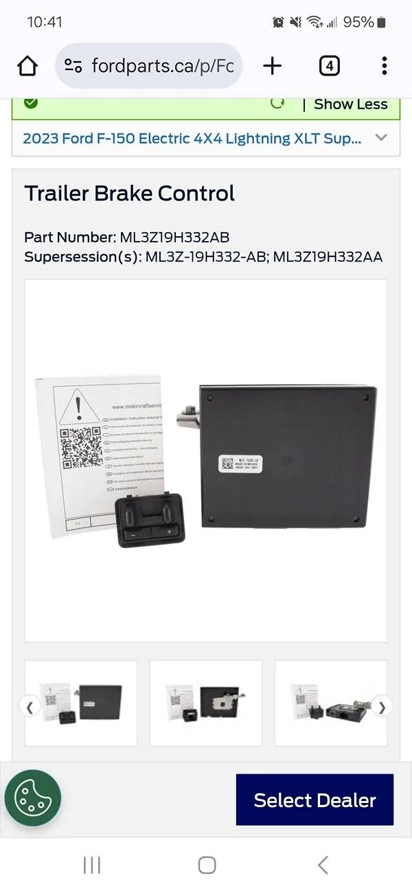

I have a 2023 XLT ER with max trailer tow package and equipment group 312A.
I do not see a physical break controller but only the coin tray.
I do see a ready connection behind the coin tray.
I am very new to trucks and need help answers for the below ones.
1. My truck cannot control the trailer electric break with what I have now?
2. I will need the below part to be able to control the trailer electric break? It says it is compatible to my VIN but the description said not for lightning?
3. My last question is that do I need to program it? If I just swap those two everything should work?
Anyone had actually done this before? I am very confused.
