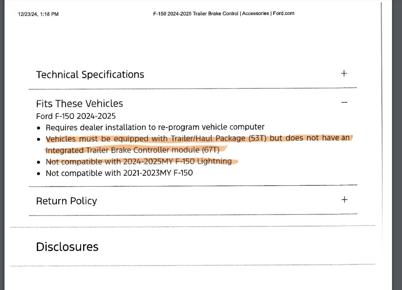

Ford F-150 Lightning Add on trailer brake controller - possible for Lightning? 1735044660047-i2
From Fords page about the 2024 Trailer Brake module
mxracer
Dan
Dec 18, 2024
2024 F-150 Lightning Flash
This is honestly one of the biggest points of confusion for me and one reason why I ordered the wrong thing. All of them for the F150 say that including ML3Z19H332AB.
Appreciate your info/help. I'll scrounge up a ML3Z19H332AB module and get it in the truck.
