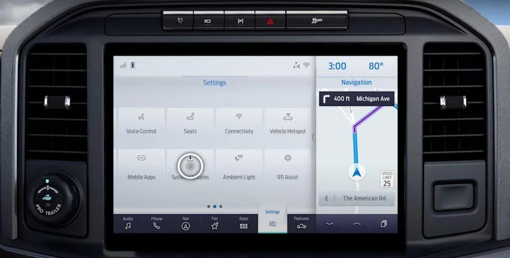

The updates are delivered to the 2021 F-150 through FordPass Connect, via the truck’s onboard modem or Wi-Fi. Updates are set to download automatically by default, which is the easiest and quickest way to ensure the truck remains up-to-date at all times.

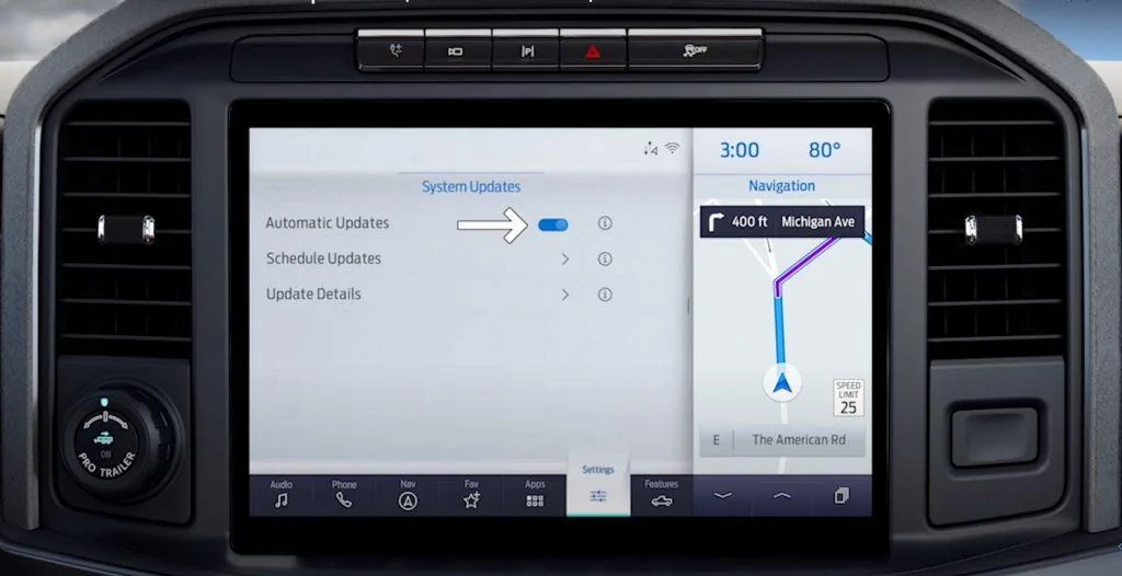

However, if the feature is switched off, it’s pretty easy to turn it back on. To do that, navigate to settings on the infotainment screen, then select system updates, then verify that the automatic updates slider is in the “on” position.

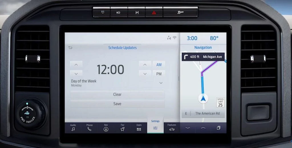

Automatic over-the-air updates require that the vehicle be parked with the ignition turned off. When an update is ready, the infotainment screen will notify owners within 24 hours of a scheduled update. Another notification will arrive via email or through the FordPass app 12 hours before the update is applied.
Then, owners simply need to ensure that the truck is connected to Wi-Fi, and can schedule the update to occur at a time when the vehicle won’t be driven, if needed, such as overnight. To set the schedule, go to settings, system updates, and schedule updates. Here, a specific time and date can be set for the update to occur.

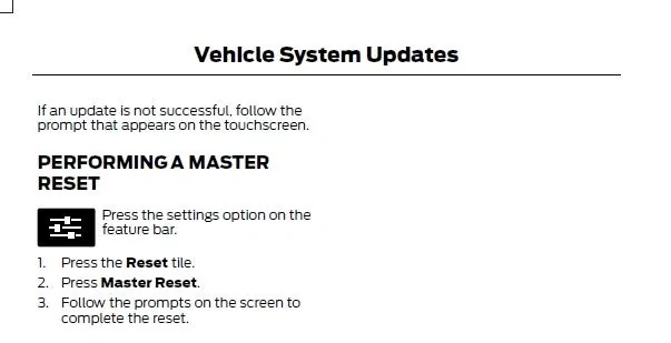

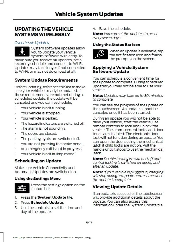

From page 597 & 598 of the Owner's Manual.....
Ford F-150 Lightning How To Use Over-The-Air (OTA) Updates In The 2021 Ford F-150: Video OTA01
Ford F-150 Lightning How To Use Over-The-Air (OTA) Updates In The 2021 Ford F-150: Video OTA02
Should answer most questions posted so far.

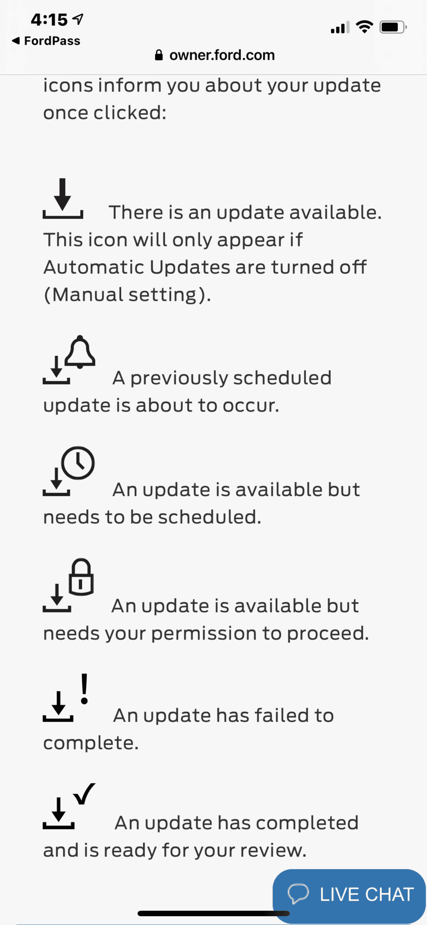

I have left mine in Manual. Still haven't seen any update icons. Check for updates and it says up to date.
