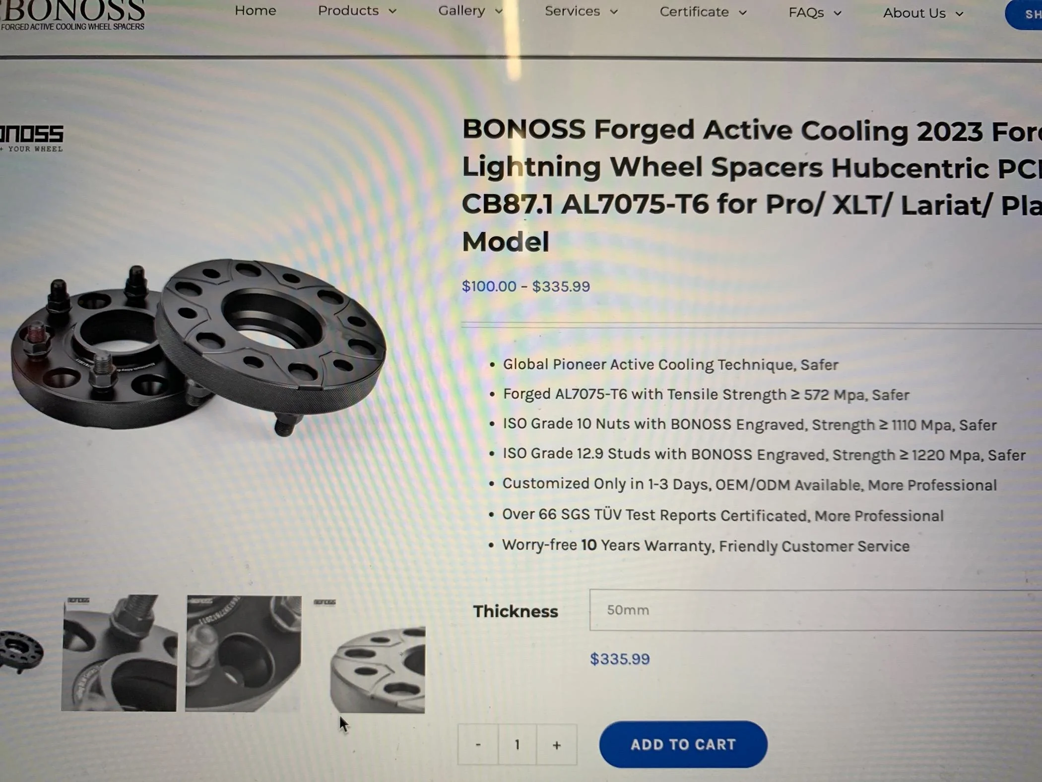

Hey fellas, just wondering if anyone has a similar setup and don’t mind sharing some images. Looking to get this BONOSS wheels spacers for my stock Lariat wheels
Ford F-150 Lightning Anyone has 50mm wheel spacers with stock wheel/tire here? image

I am interested in this as well. I really like the Lariat wheels (would like more painted black), but I prefer a little bit wider stance than stock. I am currently running with after-market wheels that have a +20 offset (stock Lariats are +44) with 285mm tires, so I figure compared to stock I have moved the outer edge of my tire out by 29mm (24 for the offset change, and 5 for the wider tire). And that has resulted in a stance that I like, although it does poke just a tiny bit, so I am wondering if a 25mm spacer would allow me to achieve that same stance with the stock Lariat wheels.
