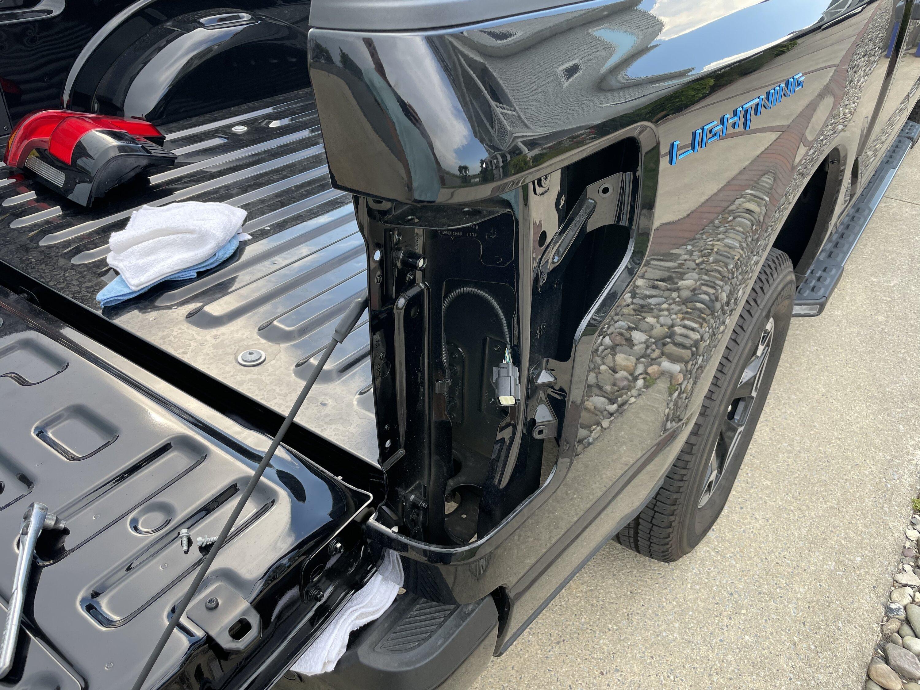

Anyone have part # for soft close tailgate hinge? I ordered one from dealership and its soft close up not down… I checked every different position…there is only one way it goes in.. I flipped the hydronic hinge and doesn’t function differently. It’s like the hydraulic arm is soft in wrong direction.

Damn.. that’s the one I supposedly have… super easy to install, but it can literally only mount one way.. I could just be doing something simple wrong but it’s literally damping only when you close
it on the way up…and falling like a rock on open lol..
I’ll go back to dealer in the morning and return it. The box was retaped when I got it.

Which side of the truck did you mount the part?

right, mine is only for the LEFT/Driver side of the tailgate, and must have the 'extension end' of the strut DOWN: and it works perfectly...
although the first few inches you may find yourself reaching up to 'catch' it thinking that it's falling, but then it is suddenly caught by the arm and makes it's way down slowly - nice. I'm enjoying not having to worry about it falling abruptly on my camper's hitch post. It DOES lean on it, but I simply carry a towel or similar soft item to let it lean on.

You are correct, the part goes on the passenger side. Are you sure you have the shock installed in the correct orientation?

UPDATE: the part number is the correct one…. I had the dealership order me a new one and lo and behold the hydraulic pump was different in the new one with the reverse action!! So I was right for once in my life lol
I got the right box.. but someone had switched out the pump in the first box.
