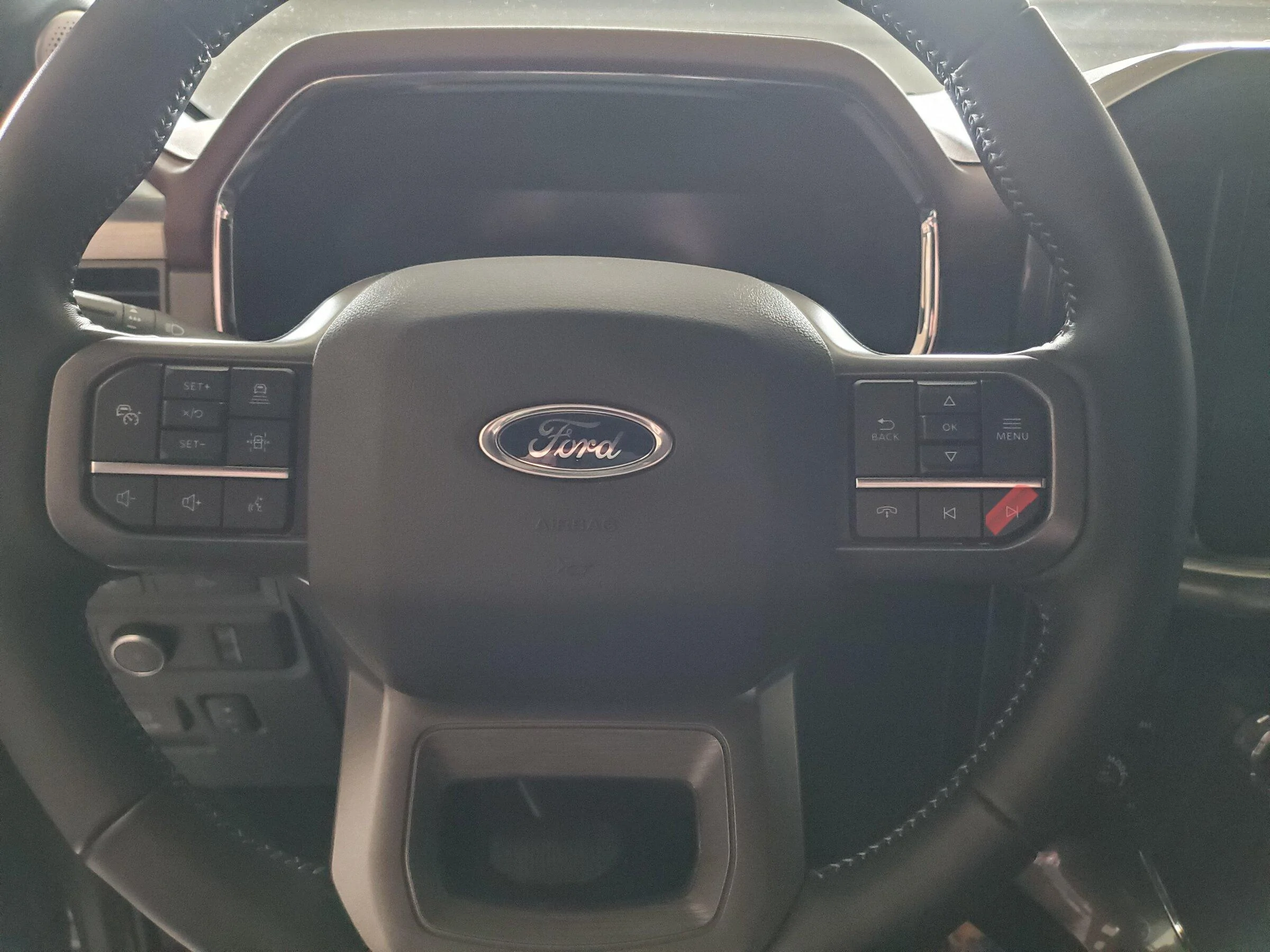

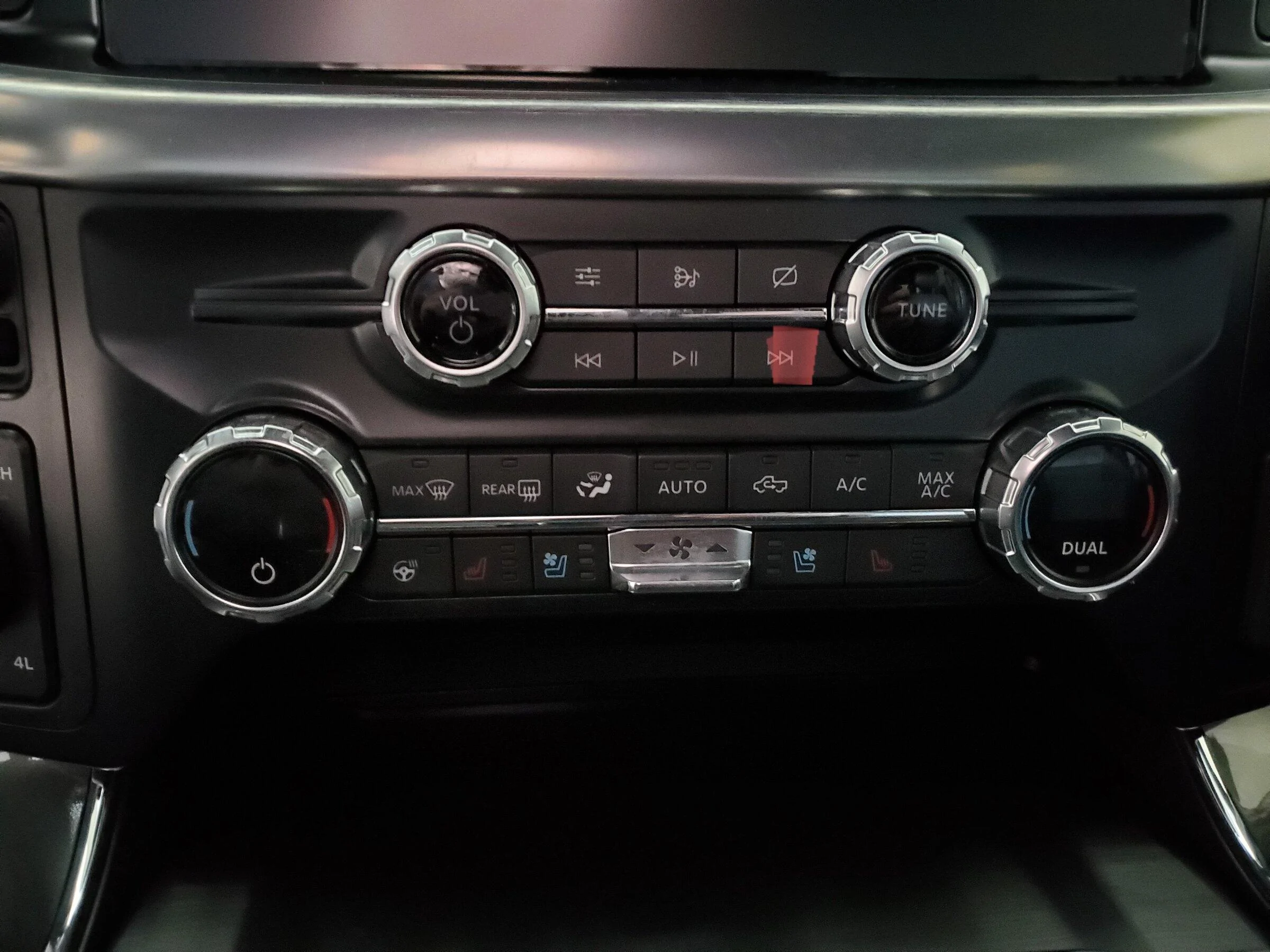

If you think your speakers aren't working, press and hold the next track buttons (1: on steering wheel, 2: on dash) and it should make all 16/18 speakers beep one at a time.
Everybody else is correct though, check the fuses, try a much better audio source, try restarting Sync 4. The Unleashed is very front center heavy even in surround unless you adjust the fader just behind the front seats.
I tried it nothing happend.
Just double checking, you pressed and held these two buttons together and nothing happened? I'd try resetting the sync 4 and if that doesn't work you might need to try the dealer.
Yes and with the truck "on".
