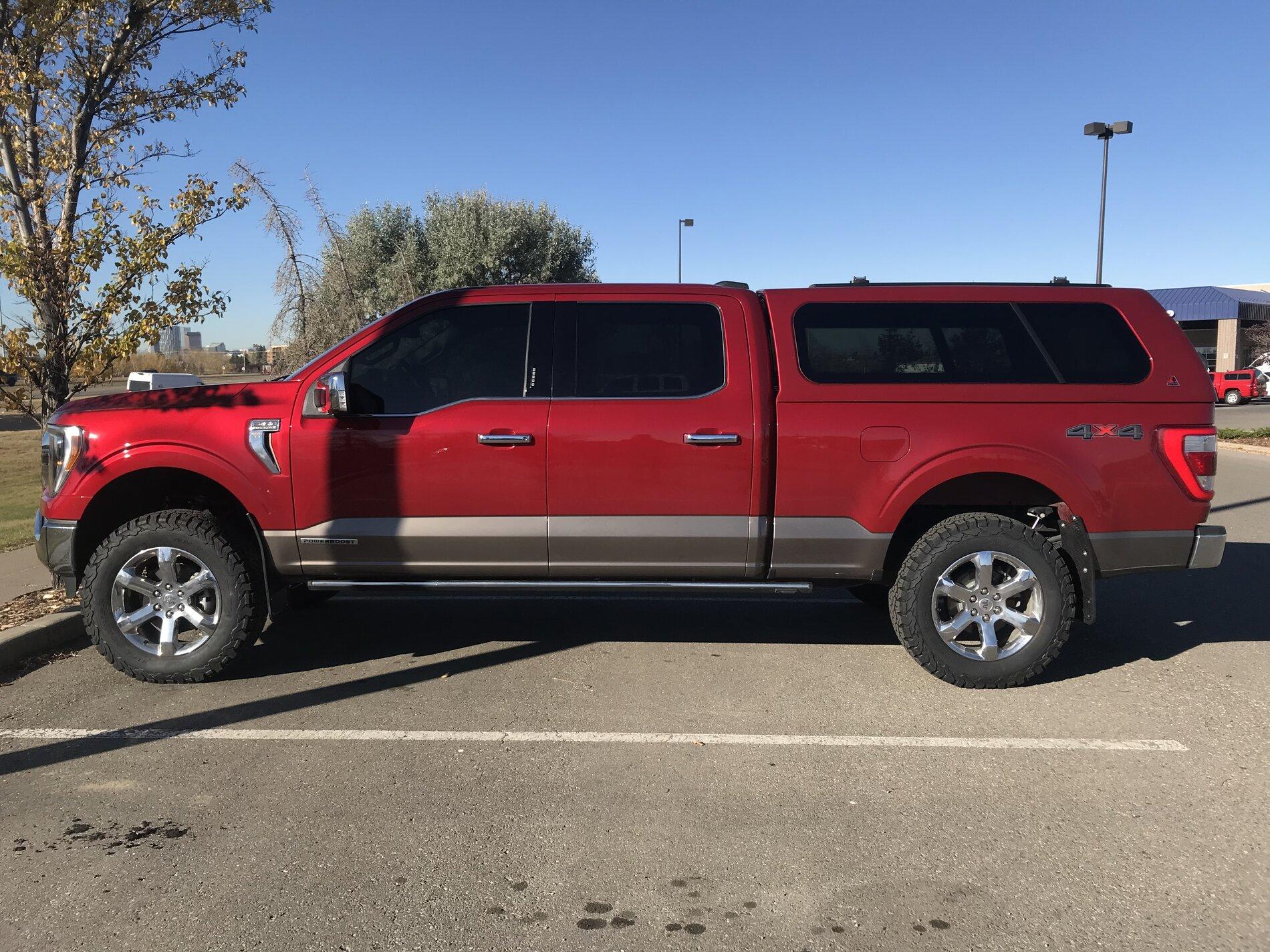

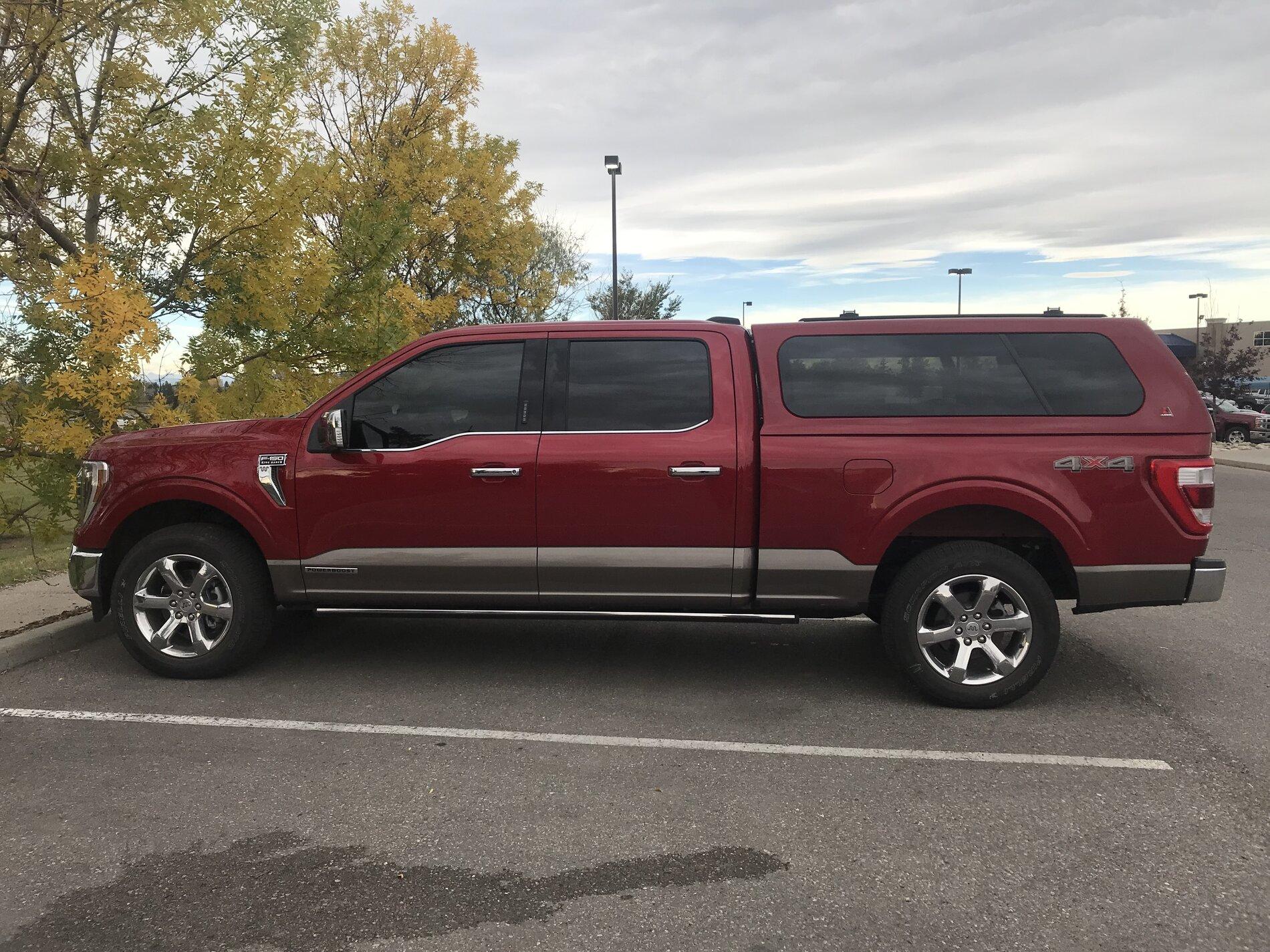

4” lift with KO2s (285/65/R20) on stock rims.
Before:
Ford F-150 Lightning BDS 2" 4" and 6" Lift Kits for 2021 F-150 released 4209BF4D-0926-4058-8215-4343DDBF01B4
After:
Ford F-150 Lightning BDS 2" 4" and 6" Lift Kits for 2021 F-150 released 5469512B-1102-42CC-86A7-8A54112378B5
Before:
After:
Hey Jerry, do you know the height of your truck now? Did you chose the fox 2.0 rear shock or their standard BDS shock? i just ordered my ARE 2 weeks ago so before it comes want to get my set up completed but dont want to do it twice. thanks for any help you can give.
The height of my truck is approximately 80-81” measured at the centre of the moonroof (sorry, it’s hard to measure accurately). The Thule cleats on the topper probably add another inch above that. I went with stock coilovers and BDS’s NX2 rear shocks. I had Fox 2.0 coilovers and shocks on my last truck and decided they’re not worth the price.
