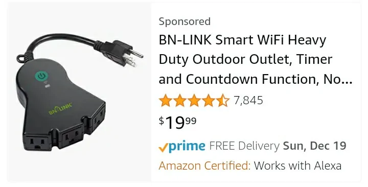

with wifi, i have a wifi switch on the block heater and can turn on the heater remotely before starting it.....what would be approx min amount of time needed to have block heater on?..... 15 min, 30 min...longer? Probably makes a difference if it is 0 or -15....
i just searched on internet....said between 2 and 4 hours depending on temps
The block heaters sure does help in frigid temperatures. It was -44 with WC here in Alberta last night, currently sitting at -32 as we speak. The wifi switch, mind sharing where you got it from?
i got them from amazon... outdoor, three plugs availble, plus can activate each singularily, plus they can be programmed to come on and shut off as you like. such as i use with outdoor christmas lights...you can overide auto turn on or auto turn off and easily set timers. numerous timers if needed. just need to be in wifi range...download app from your smart phone and you can run the whole show from your phone. I have several of these switches...both indoor and outdoor....i am in command..?
Haha that is pretty cool! Any chance you have the link to the one you got?
