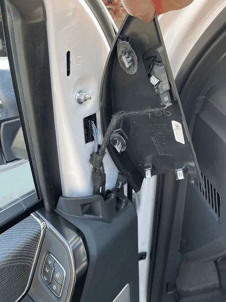

Only difference with the modules in Blue Cruise cars is the CMR(Driver Status Monitor) That is the only change made. The ipma, APIM, Cluster, BCM, PSCM, ABS, RCM, all the same. Im adding the CMR once its not ice here in Dallas. Ive also been busy working on my 19 F150 adding SYnc 4 to it while I was waiting on my new 12" screen. I needed the screen that has the mounting for IR and Camera.
After adding the CMR for blue cruise I have to make a decision either wait for Ford to release the update for the IPMA or buy a new IPMA from a JOB 2 or 22 truck. They releases the Cluster update for the Job 1 digital clusters this week. That is a good step. It brings the job 1 clusters to the Job 2 level. They are the same clusters but have had different software for some reason.
Also I believe there APIM will need to be updated for blue cruise in Job 1.
