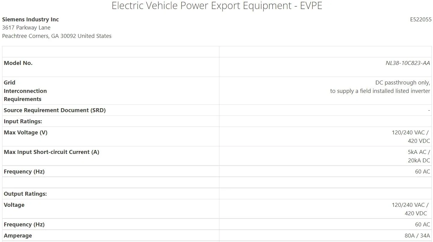

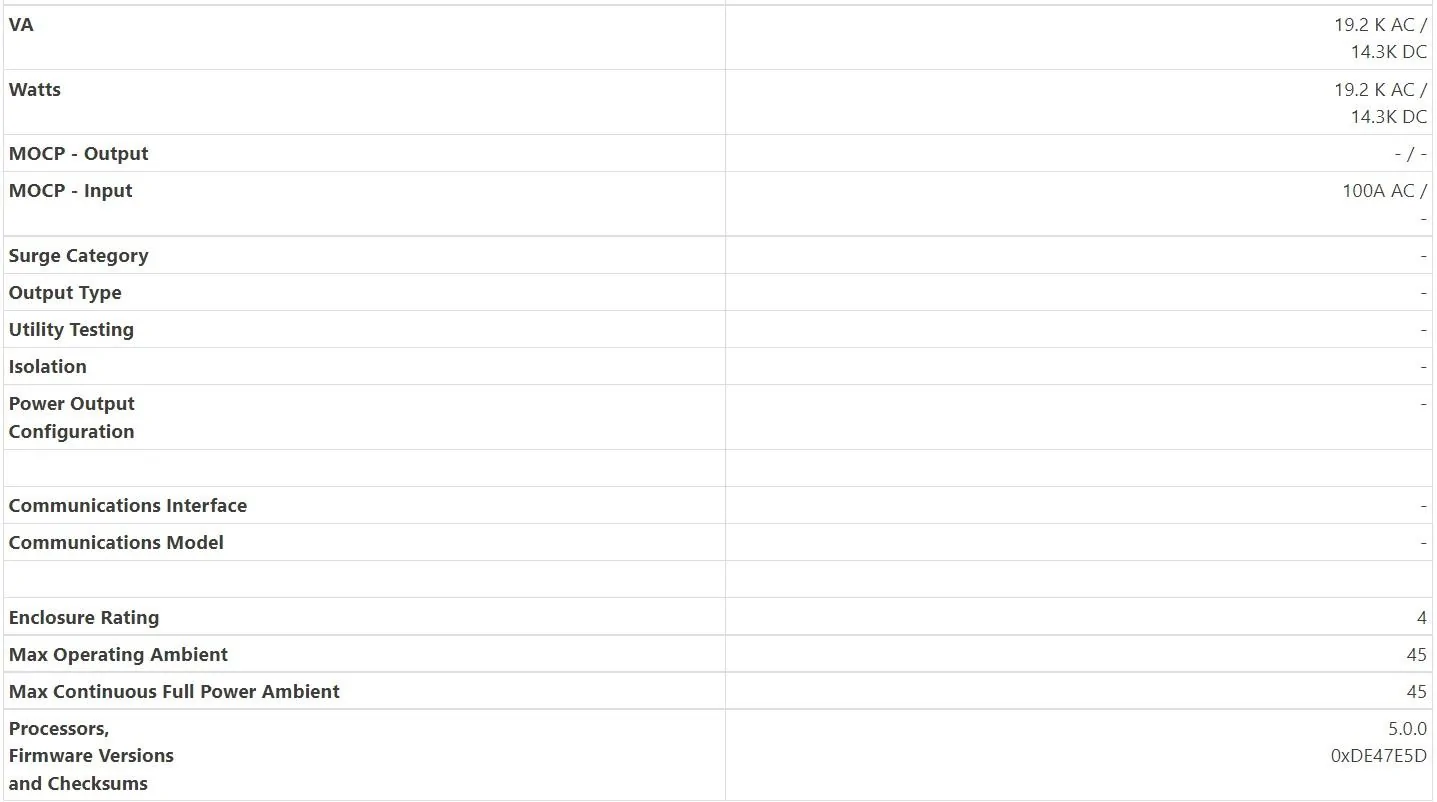

The UL listing of the product is complete as of 2/1/22. The Charge Station Pro is "DC passthrough only, to supply a field installed listed inverter". Max voltage / voltage are indicated to be 420Vdc. DC max amperage is 34Adc for absolute max of 420 x 34 = 14.28kW or nominal 14.3kW. If actual operation was at a more common 380Vdc this would be 12.92kW.
Watch out if installed in a location that will exceed 45 deg ambient (113degF presumably).
Product model number is NL38-10C823-AA.
Enjoy!

Is there possibly a link to the source information available?
It would be awesome of the "DC passthrough" is bi-directional so we could charge direct from solar before going through an inverter.

The following is available on the UL listing website, behind a login.
Ford F-150 Lightning Charge Station Pro - 14.3kWdc Export Capacity (and other specs) Siemens UL 1 (1)
Ford F-150 Lightning Charge Station Pro - 14.3kWdc Export Capacity (and other specs) Siemens UL 2 (1)
