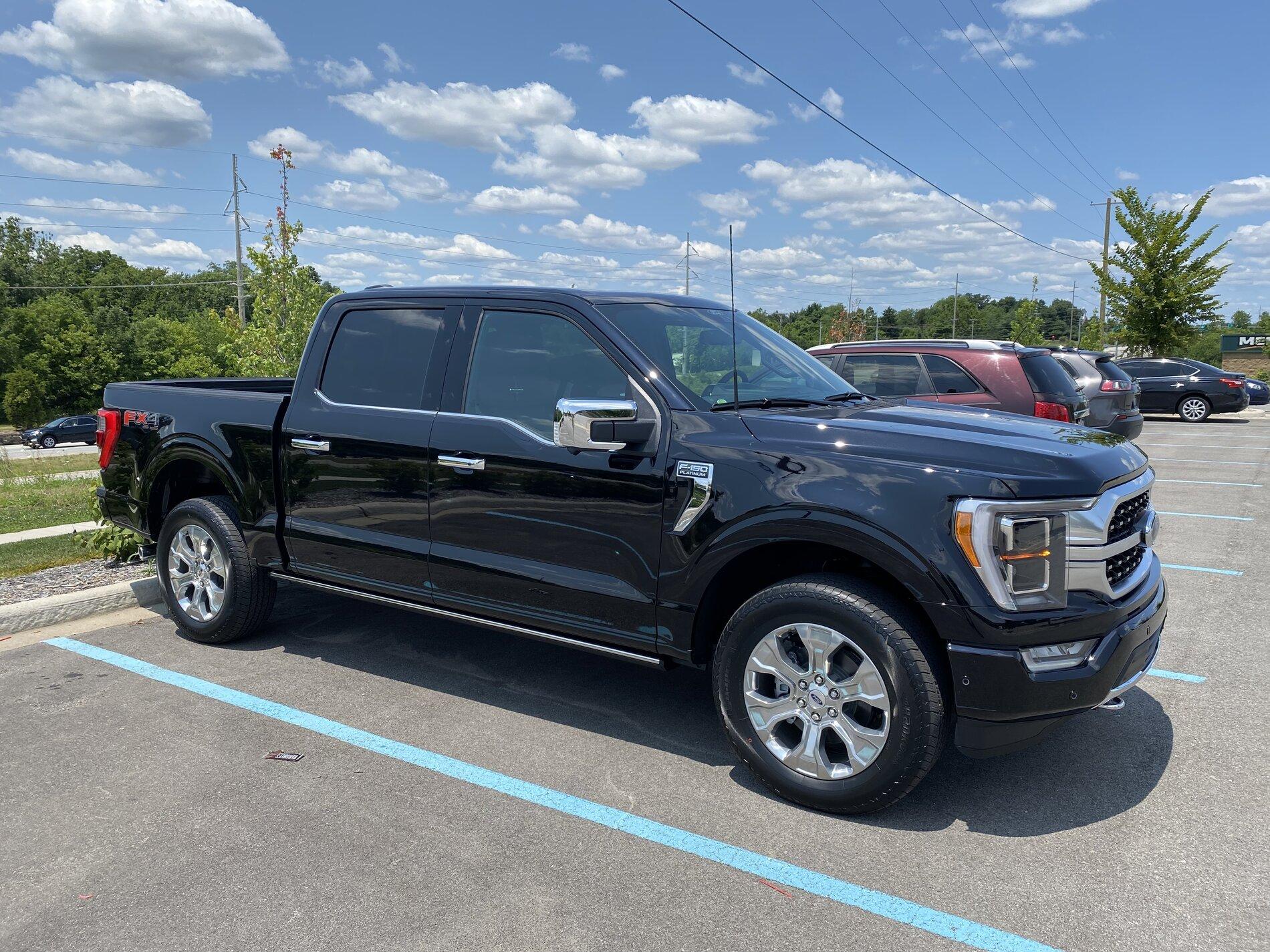

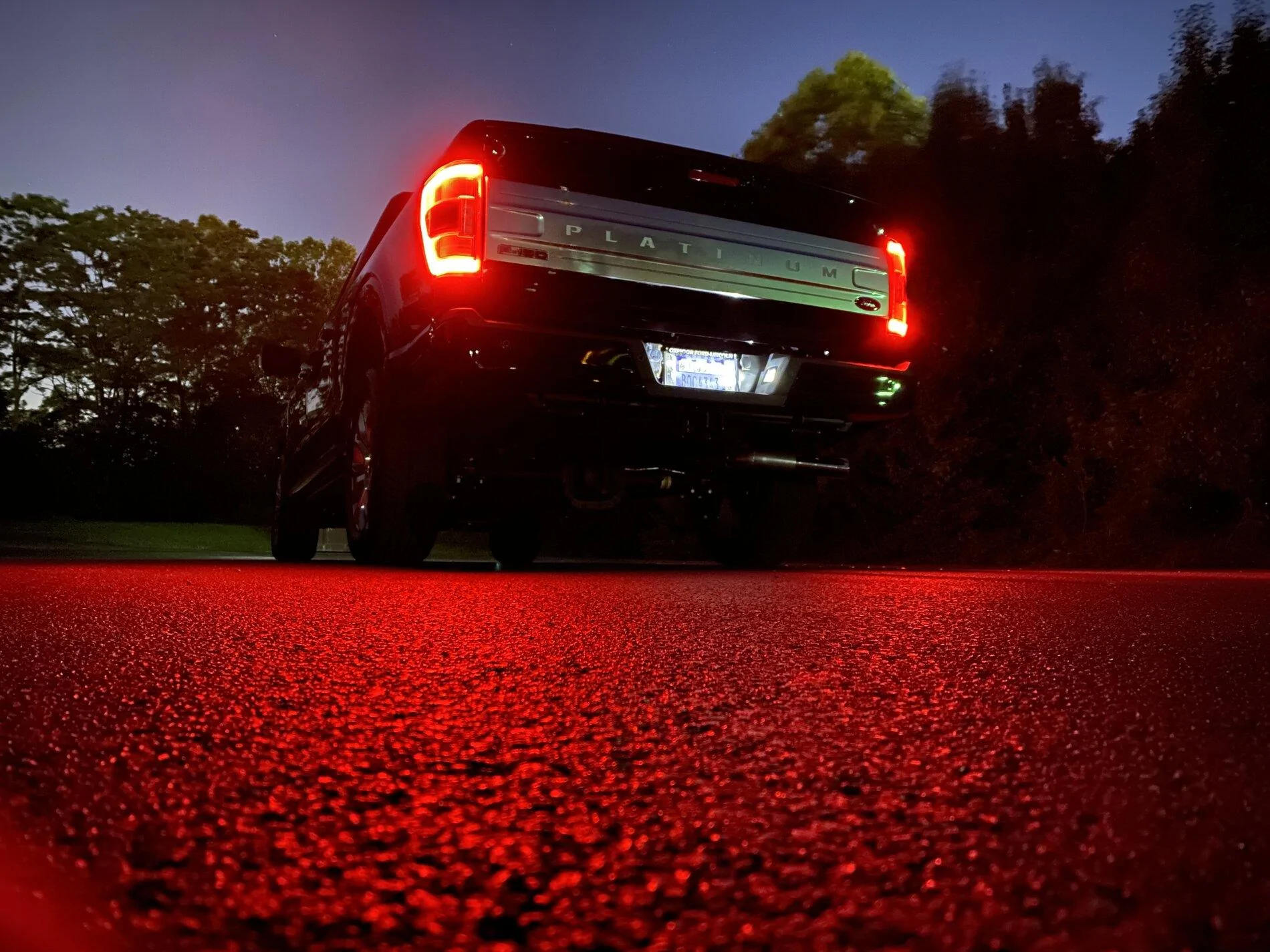

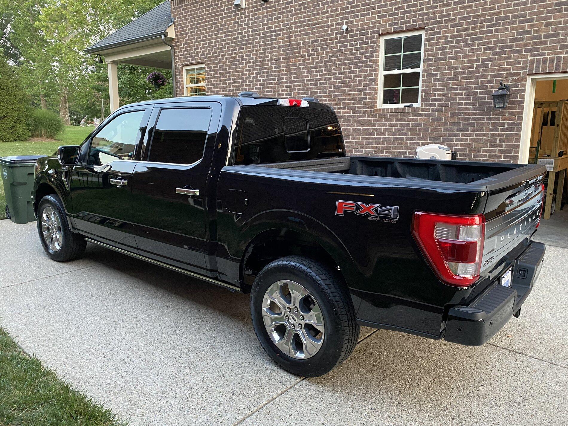

Thanks madman. Here are the pre
Ceramic coat pics.
Ford F-150 Lightning Cleaning suede / leather on the doors of F150 Platinum interior? E9C19419-8A64-43DA-A76B-96FD1CF6F5B3
Ford F-150 Lightning Cleaning suede / leather on the doors of F150 Platinum interior? 1CBFE871-B305-4299-A305-B570EE0301A6
Ford F-150 Lightning Cleaning suede / leather on the doors of F150 Platinum interior? 105BDA60-2612-4DF7-80C6-9A09B8BC9E2C
Ford F-150 Lightning Cleaning suede / leather on the doors of F150 Platinum interior? 78A63835-EAB1-4CC7-9DA0-DF0FFB48FBD3
Ford F-150 Lightning Cleaning suede / leather on the doors of F150 Platinum interior? 2C733527-C210-4725-AB6C-9D398E0EB2A4
