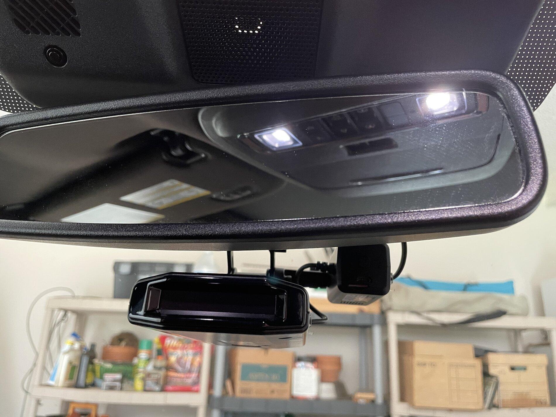

Mine is to the right of the mirror stalk.

Very clean! What camera did you end up getting and did you tap into the back of the rear view mirror or run the cable somewhere?
Mine taking a closer profile view of the setup?

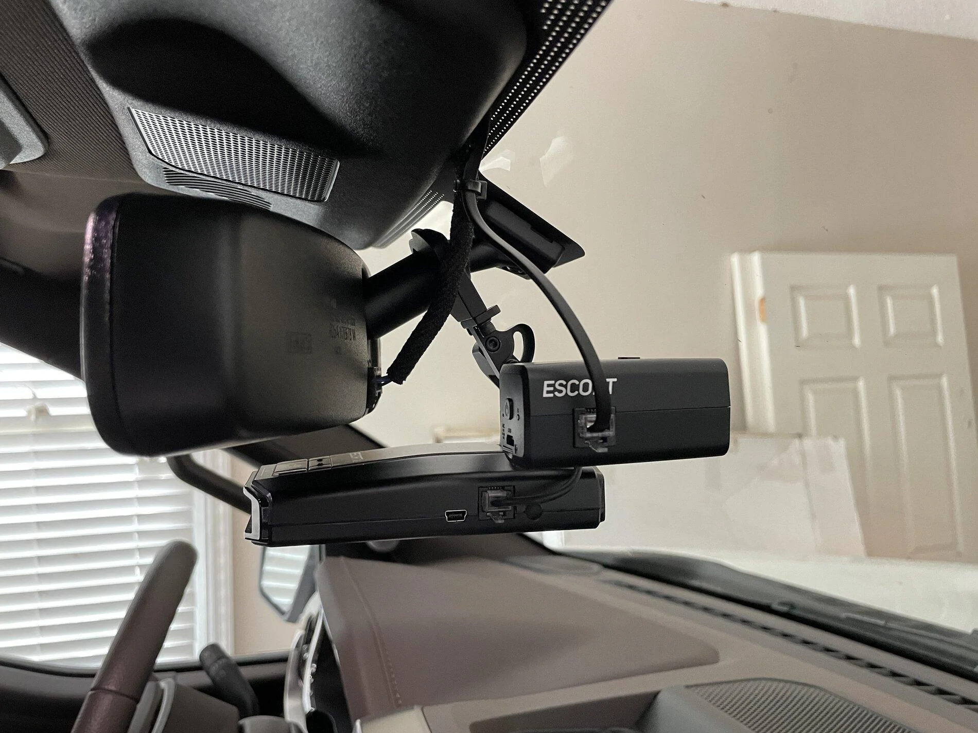

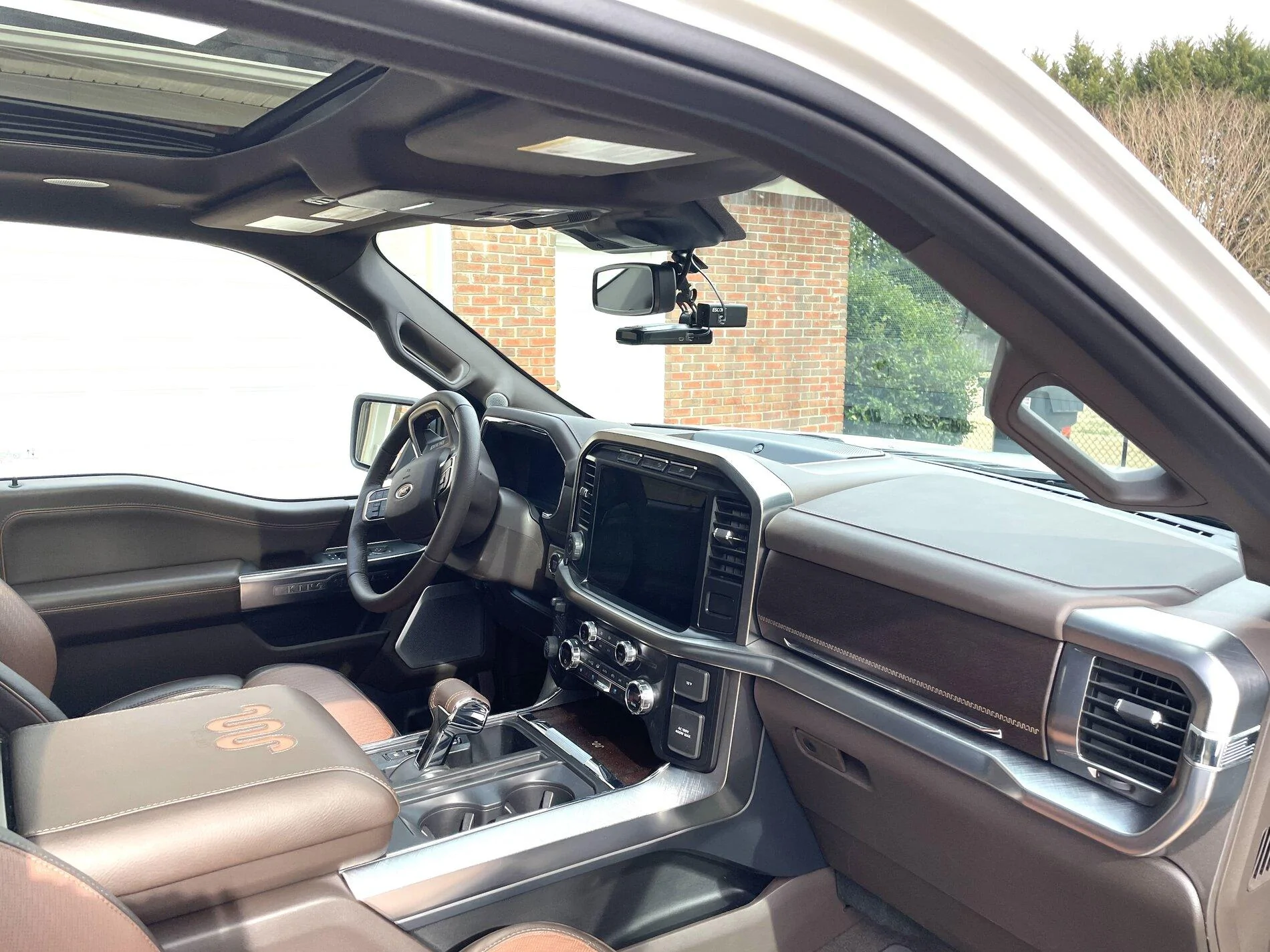

The dash cam is an Escort M1. I chose it because I can use one power source for both the radar detecter and the dash cam. The power is run from the BCM to the mirror. I had a stereo shop run it. I get a closer photo later today.

Here are a couple of closer photos.

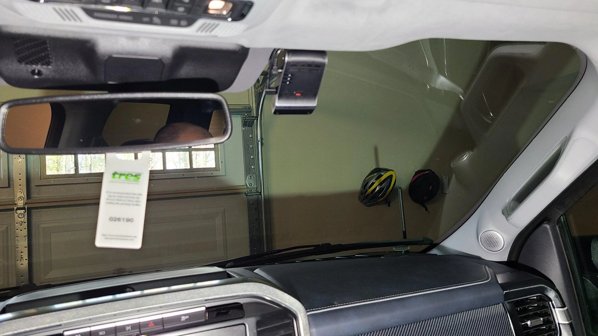

Not the best pic but mine is to the right of the mirror. Thinkware U1000. Wiring is tucked under the headliner and run down a pillar to the passenger side fuse box.
Truck is at the dealership for recall and alarm issue but can get some better pics when i get it back

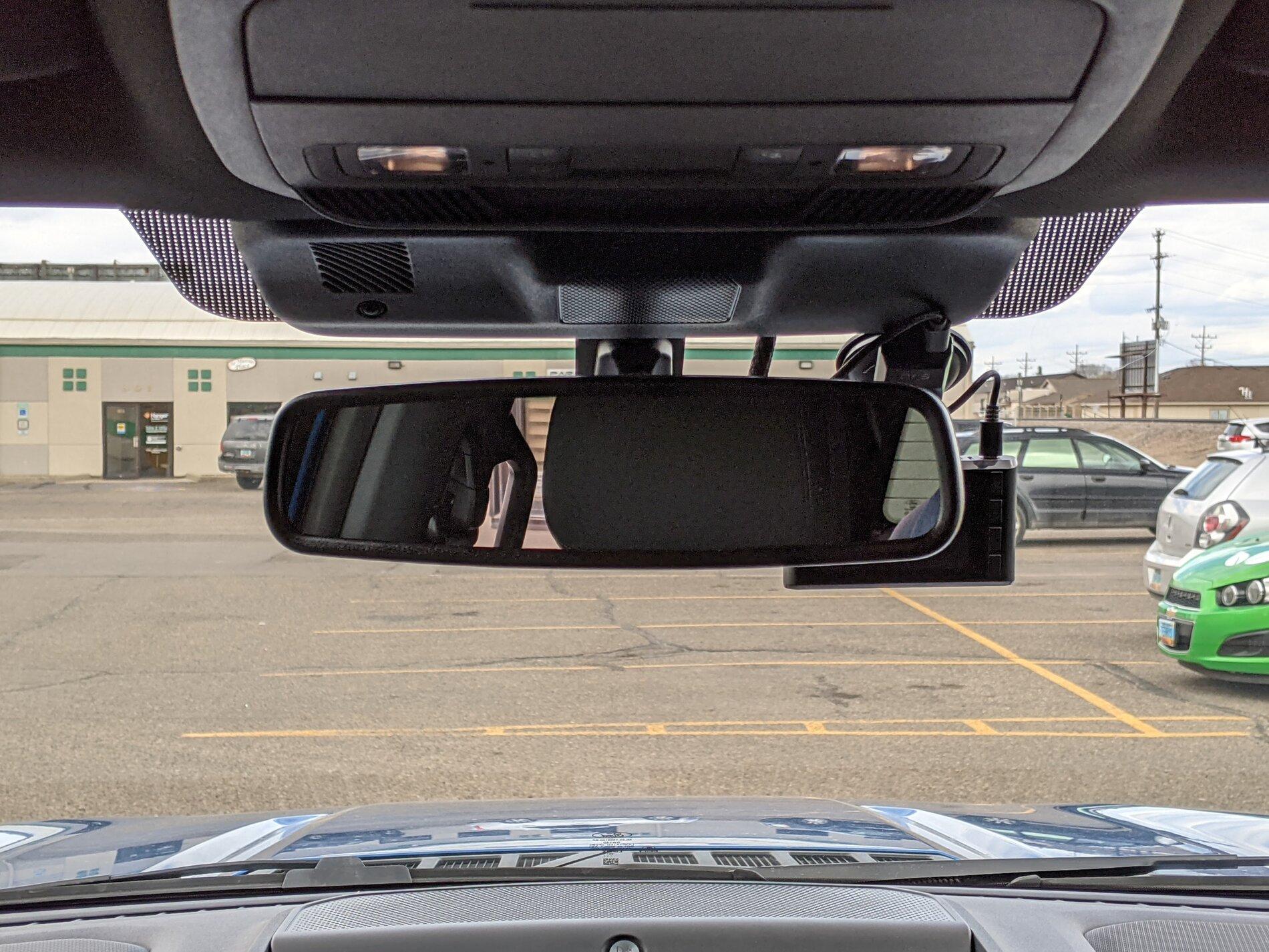

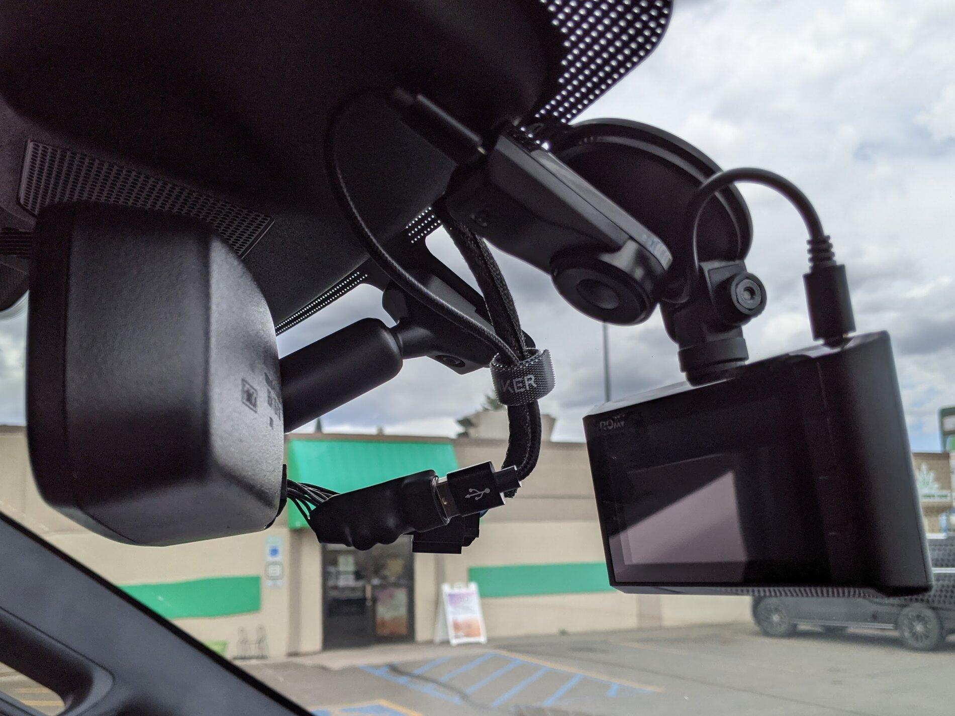

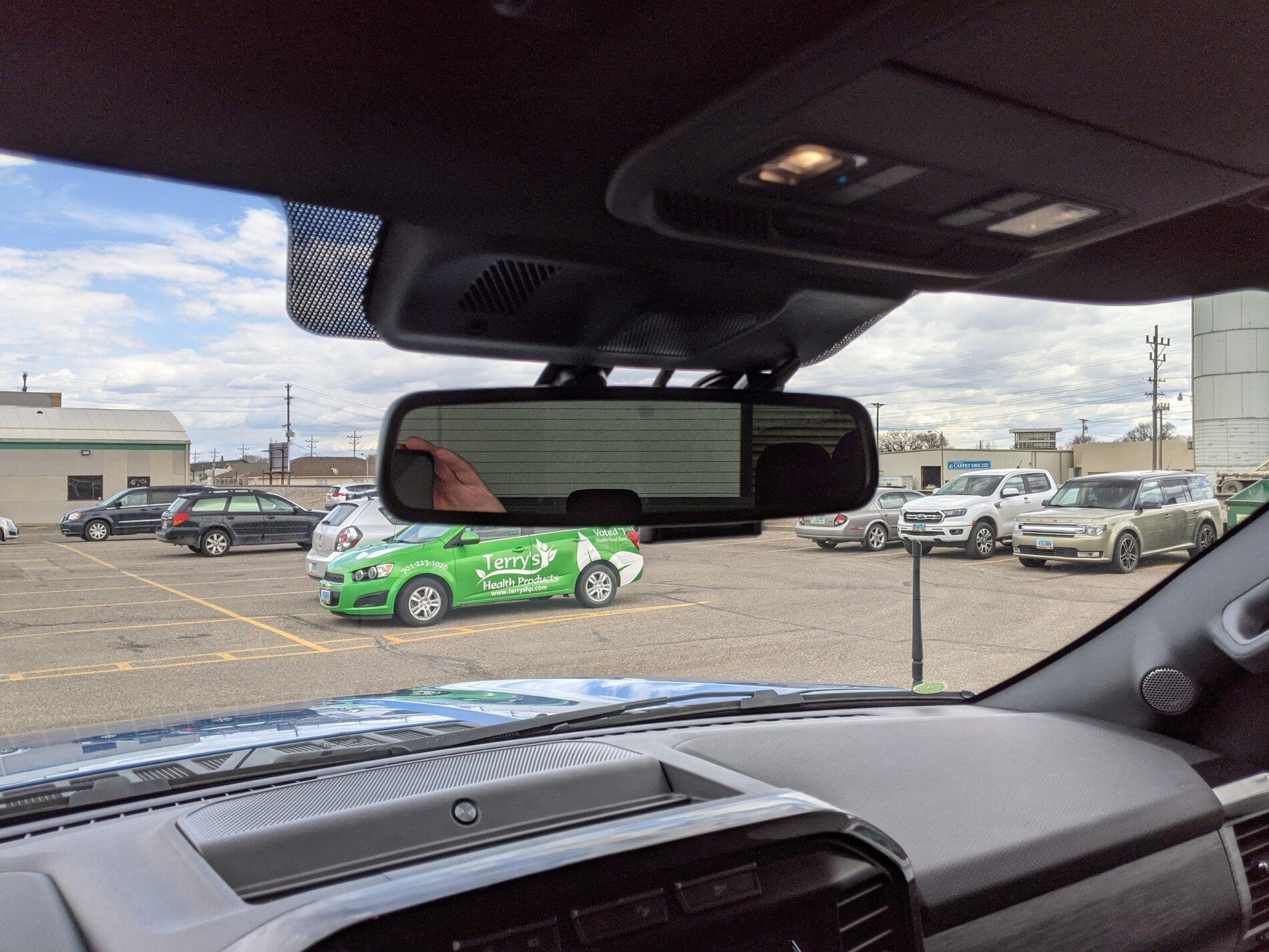

I'll be installing a newer dashcam this weekend (I hope), and I'll probably try placing it closer to centered (directly to the right the mirror stalk) because the GPS unit is mounted differently. I was also going for the least amount of obstructed view as possible.
For now it's mounted per the following photos;
1. View from the driver's seat
Ford F-150 Lightning Dash Cam Placement PXL_20210428_193404142
2. View from the backseat
Ford F-150 Lightning Dash Cam Placement PXL_20210428_193319366
3. View from passenger seat of installation/wiring
Ford F-150 Lightning Dash Cam Placement PXL_20210428_193451577

What camera did you get?

Hey Paul, how did you tap into your review mirror? Is that that the hardwire kit from Anker?

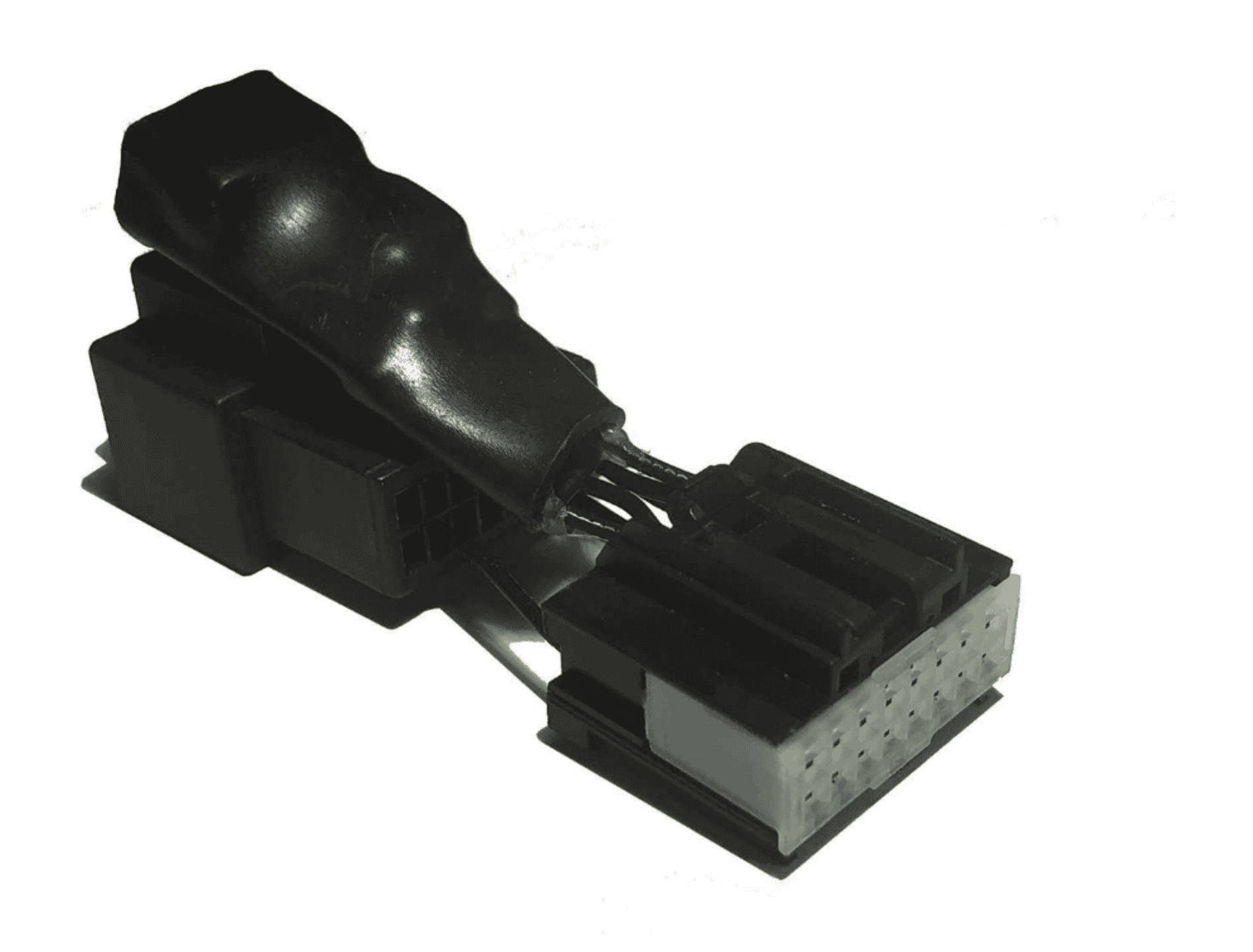

I used this adapter
Ford F-150 Lightning Dash Cam Placement Screenshot_20210428-213949
The Anker part you see in the photo of my install is just used for cable management.

So one end goes into the back of the mirror and the other end is a USB port? I'm assuming I need a get a whole new different kind of cable that goes to my camera if I use this adapter. For reference, this is my current cable.

"So one end goes into the back of the mirror and the other end is a USB port?" - Correct.
The adapter comes with a couple of short USB cables.
