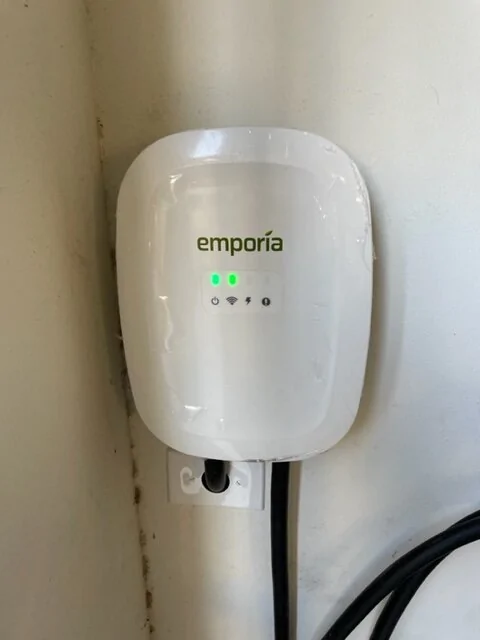

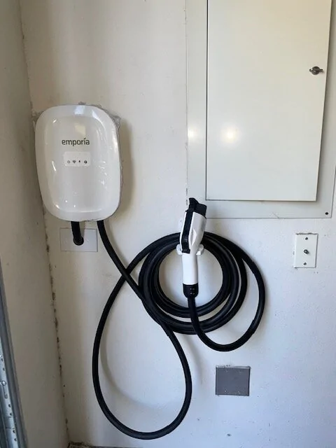

The delivery truck just pulled up with the charger! I may put one inside garage and the backup outside. My guess is the 80A FCSP will not be the one going out in the hot sun but we'll see how the firmware updates go.
Note it is 48A (11.5 kW) if you hard wire the connection and 40 Amp (9.6 kW) if you use a 14-50P plug. The charger comes with 24" plug you can remove. The 48A requires a 60A circuit breaker and the 40A requires a 50A circuit breaker.
What I really find cool about his charger is that in conjunction with their Emporia Vue, during grid down situation you can choose to automatically throttle the charger to a low current charge so as not to shutdown the solar due to high load or move the charger to a non-critical loads panel.

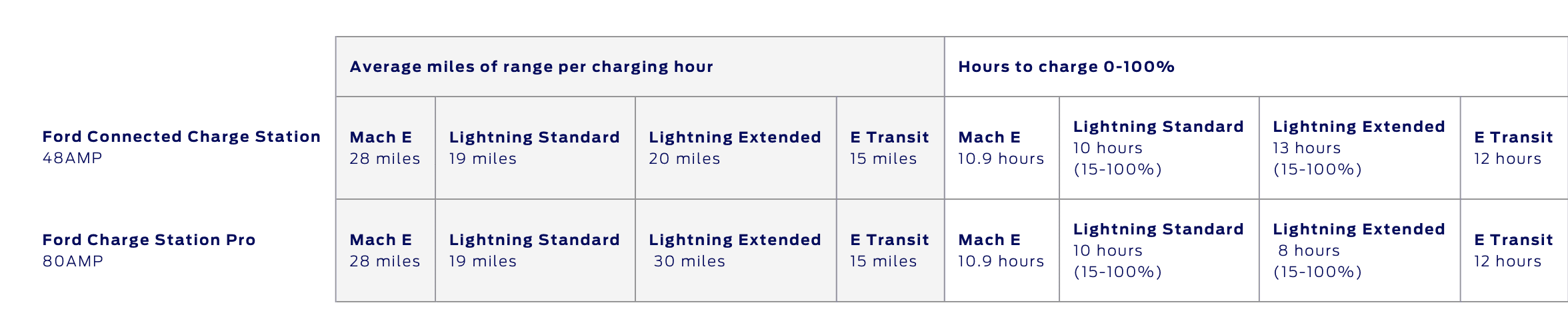

I plan on hardwiring mine. I'm hoping that 11.5kw will be enough to give me the charge I need in the winter to do my 100 mile round trip to work and back. My electric provider has a "super off peak" time of 11pm to 6 am. I leave for work about 5:45 so I would get roughly 78kw on that plan. I'm just wondering how the ER battery is going to perform on the way home after the truck being in the cold and unplugged for 12 hours.

Hey most electrical engineers have no clue on how to do the work of a practical Electrician! You guys actually get to have more fun sometimes as well. For example, spent a good number of years of my career designing and fabricating quantum well semiconductor lasers but It's actually more rewarding sometimes to run a fiber optic cable run or power up a server farm or hookup a well. You see the result of your work in real time. That laser took us 4 long years to design and fabricate and there are lots of frustrating years when things don't work and things look dismal. Eventually did get tens of thousands yielding lasers per wafer. Oh, and then the corporation canceled the program because we made more than we could ever use, so we sold the whole tech to the telcos and everyone had to find a new job. Such is life! You have job security and will always be needed! It's so bad in US with electrician shortage that Sunrun has a backlog of 4+ months in Texas as there are not enough electricians in the state. So we electrical engineers look up to you electricians and sometimes wish we had your job!
Back to your question, I think with 78kW you are good for 100 miles +. Here is a useful chart for 48 and 80A chargers on SR and ER batteries range per hour of charge -
