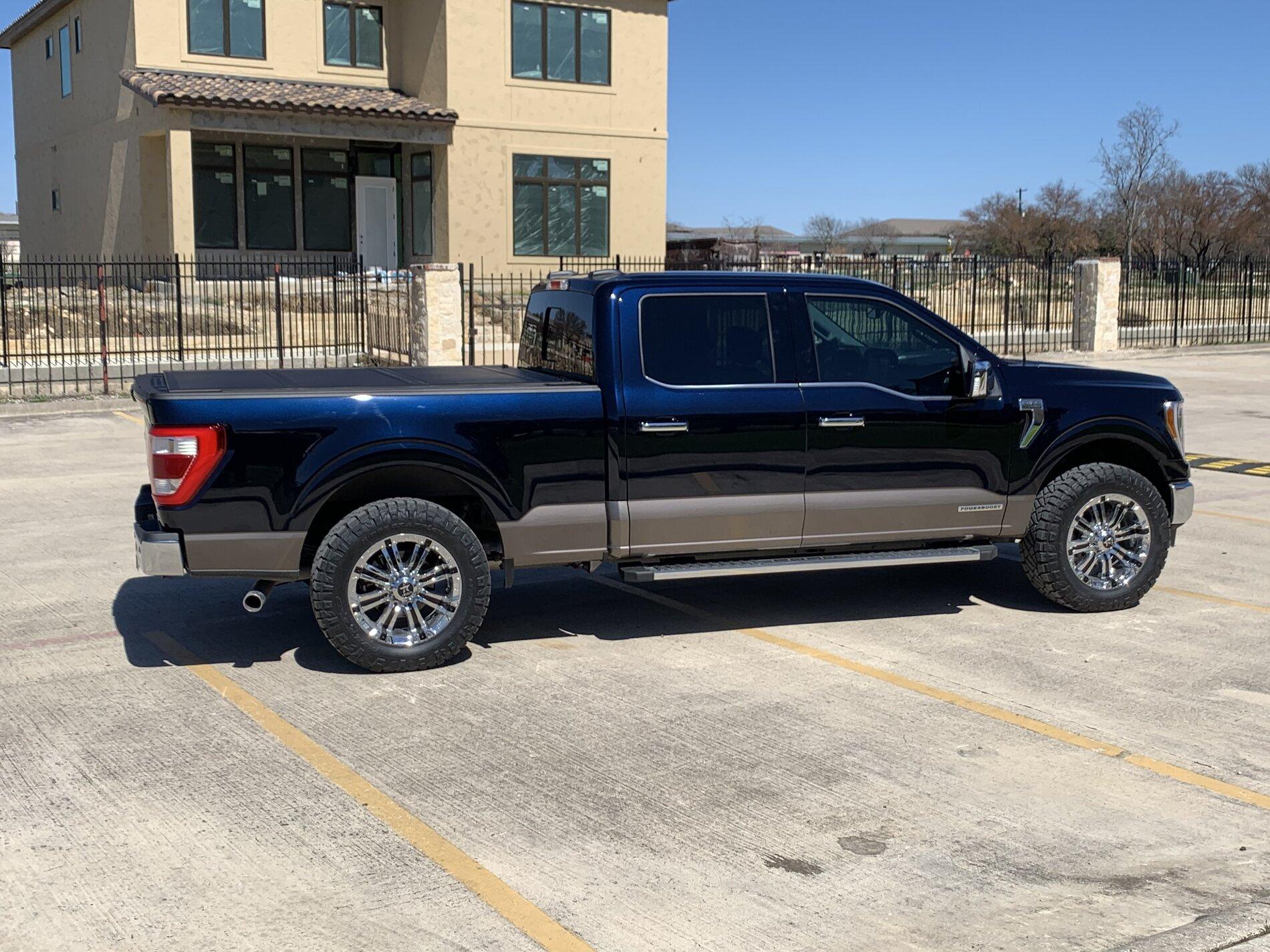

My rims : Going from factory 20" pvd chrome 8.5" wide to 9" wide RBP 94R Chrome Wheels
Goal : Aggressive look - stick out about an inch. Here's how the math works :
1. New rim is 9" wide, not 8.5", so that's 1/2 in wider - HOWEVER, you must divide that in half because it pushes the rim 1/4 inch inside and 1/4 outside (widens both ways)
So I start off 1/4 inch further out. So with an equal +44 offset rim, I'm sitting 1/4 inch out, still about 1/2 inch inside fender (remember 3/4" default inset explained above)
2. Need to determine offset - my rim comes in many different offsets. If I go +44 offset, I stay at 1/2" inside fender, but I would like to be about 3/4-1" outside for a slightly aggressive look.
So I choose a +0 offset rim. The difference here is going from +44 to +0, which is 44mm, which equals 1.73 inches.
Since after step one I was 1/2 inch INSIDE the fender, this now moves me about 1.25" OUTSIDE the fender - which is rougly my goal.
According to "Trevor" at RimzOne, where I purchased my rims, he says that despite all this math - it' s not perfect science, and that it's always a little more inset than the math says. He says that with going with this 9" rim and 9" wide tire, there's no way I can get close to 2" out - my only fear. He says I'll actually look about 1" out total, my goal. I asked about 2021 trucks having a possible wider default stance than 2015-2020 (unconfirmed) and he says they've done 2021's and yes, what he's saying is accurate and with my choices I will end up 1" out. - my goal. Assures me I won't need to return them if he's wrong - but that of course I can.
What I need to be careful about - I can put up to 12.5" tires on these 9" rims, and that would change the width - another factor... but I'm not, I'm going with 9" nitto ridge grapplers, keeping it around 33" (like factory) on total width, which according to RDP, will be perfect to what I'm after.
Summary : Lot of 'moving parts' in figuring out offsets related to reaching your goal, and one thing hardly mentioned is how far in the original tire starts at - which is about 3/4 inch inside to begin with - so you HAVE to keep that in mind once you start your wheel math. If Ford trucks had a +25 offset, they'd be flush with fender, but they're +44.
