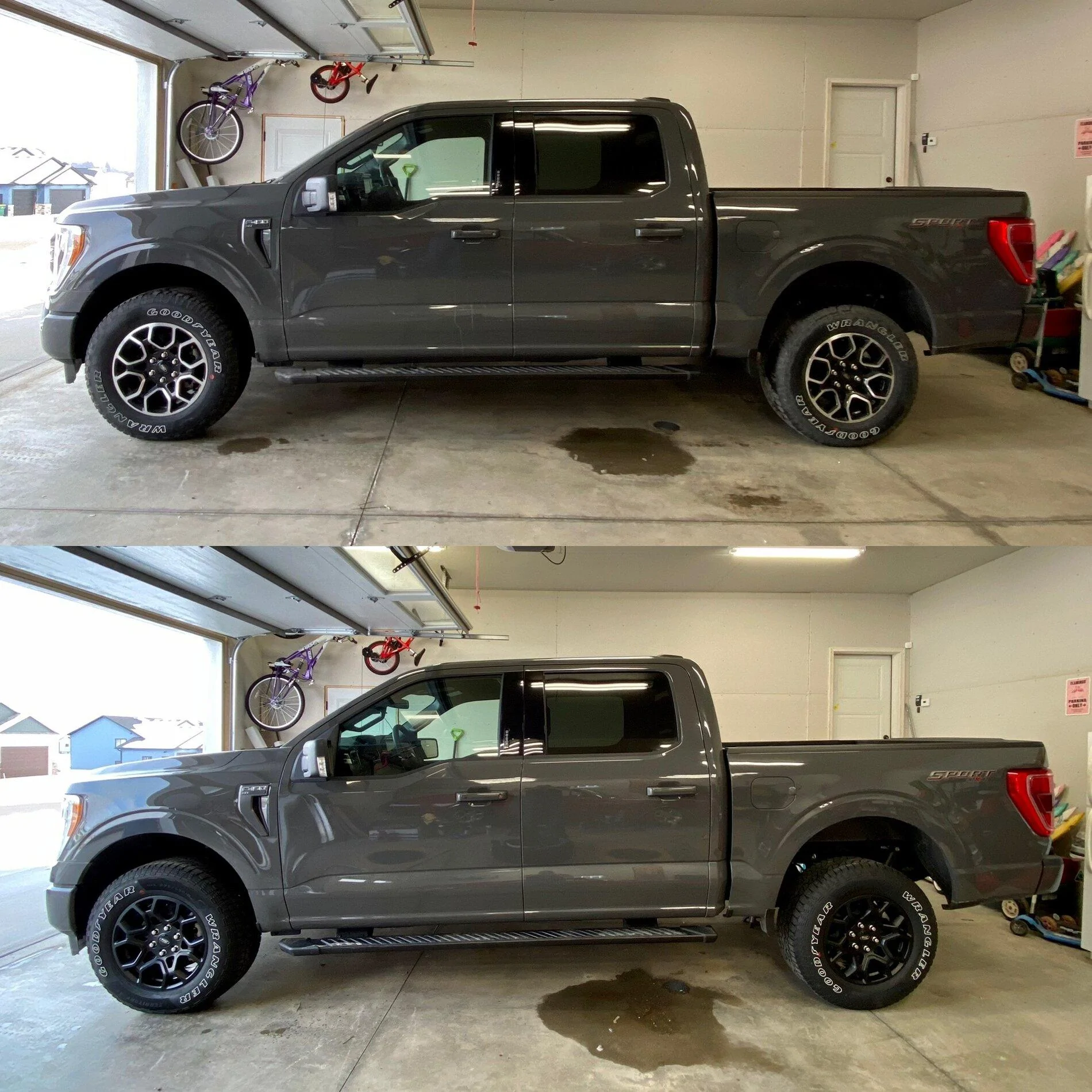

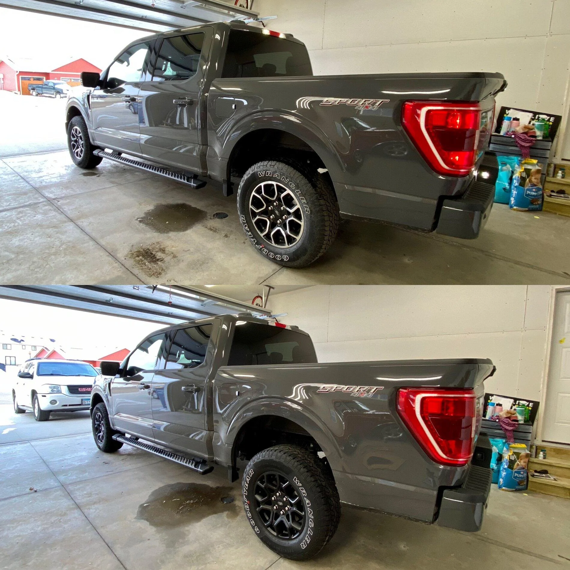

Can you post a picture after you did the black out? I am planning to do the same. THanks ahead!

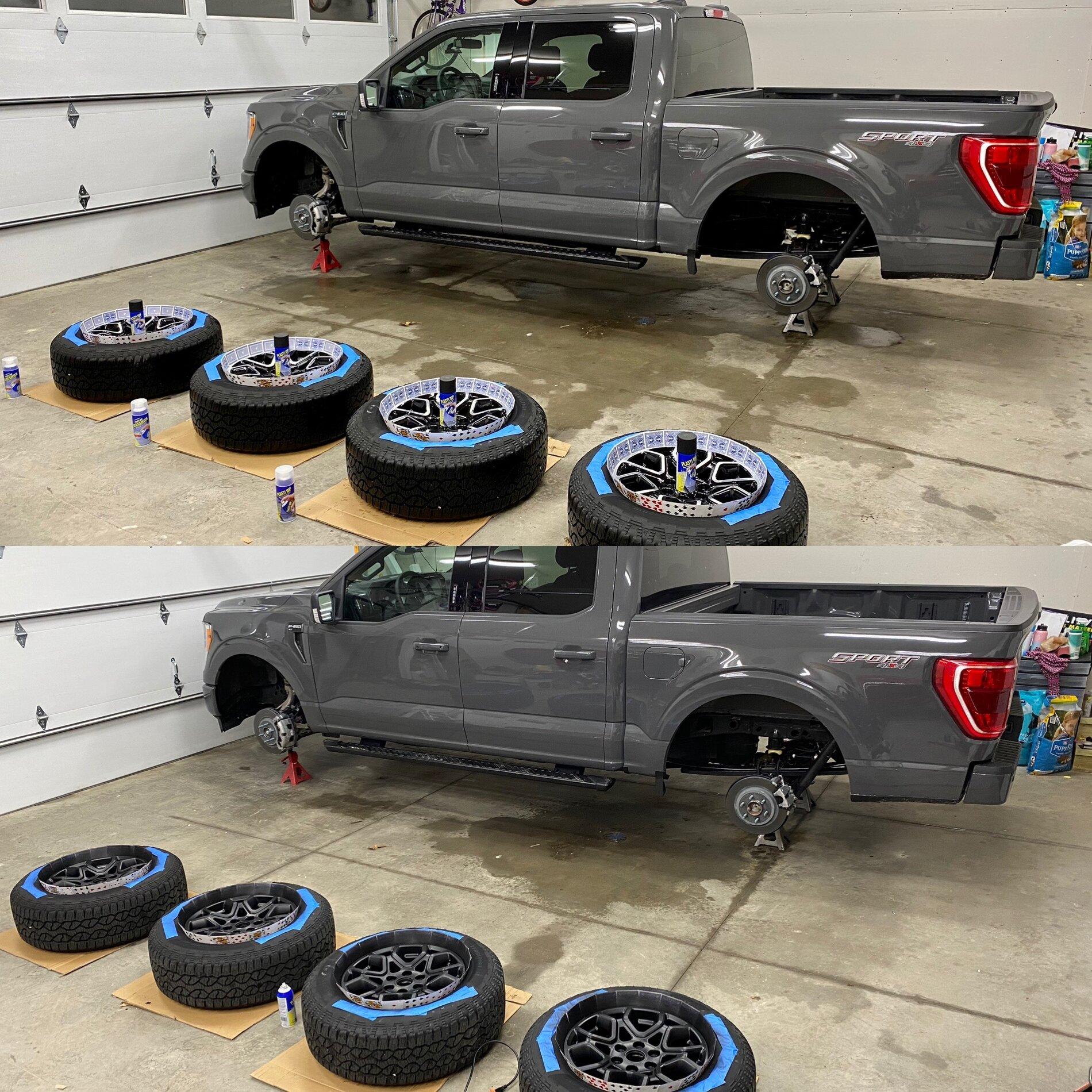

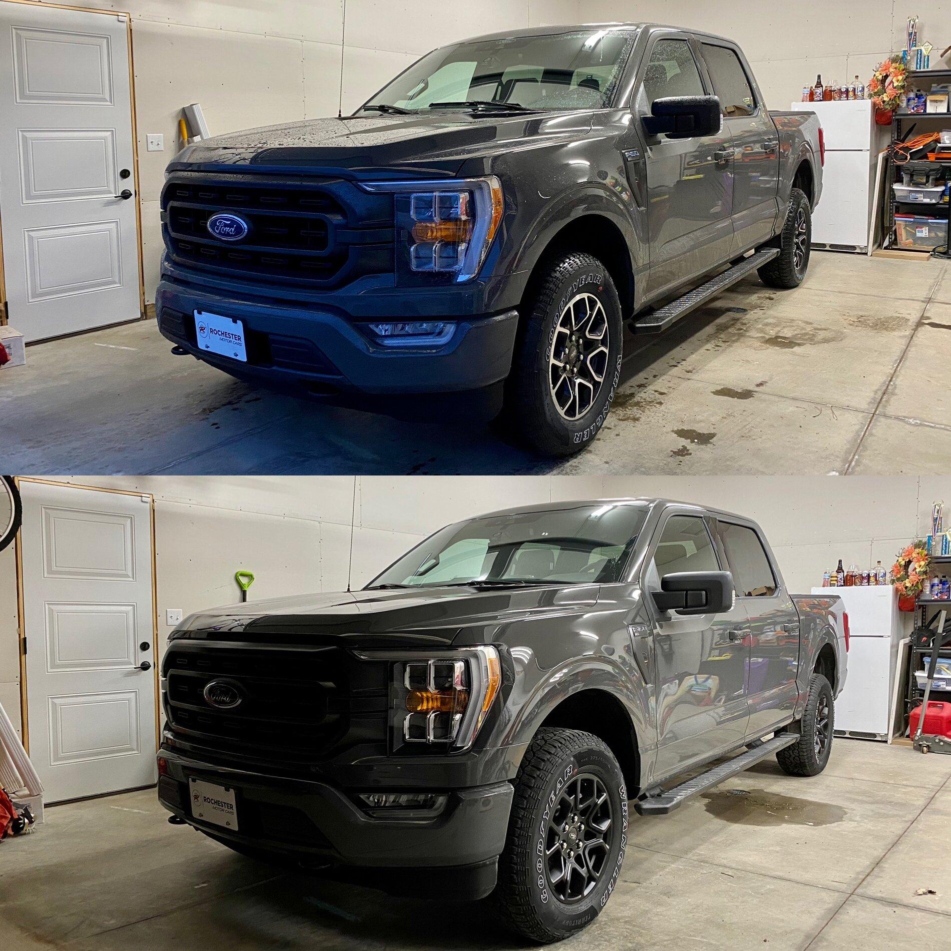

Ask and you shall receive.

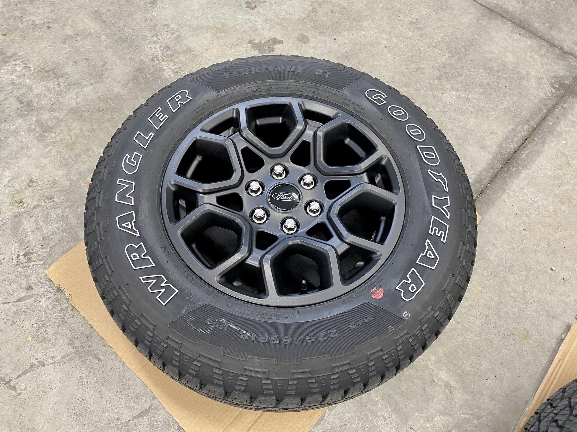

I would love to see some aggressive tires on these 18" sport wheels. I keep going back and forth between the 20" wheel or the 18" wheels. The blacked out wheel looks awesome!!!!

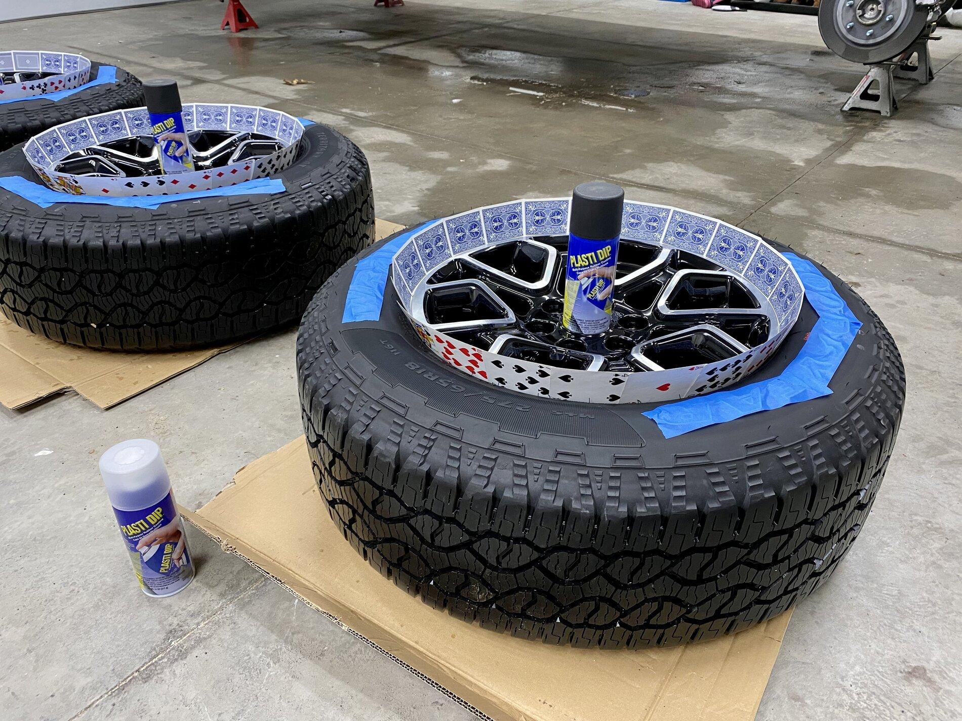

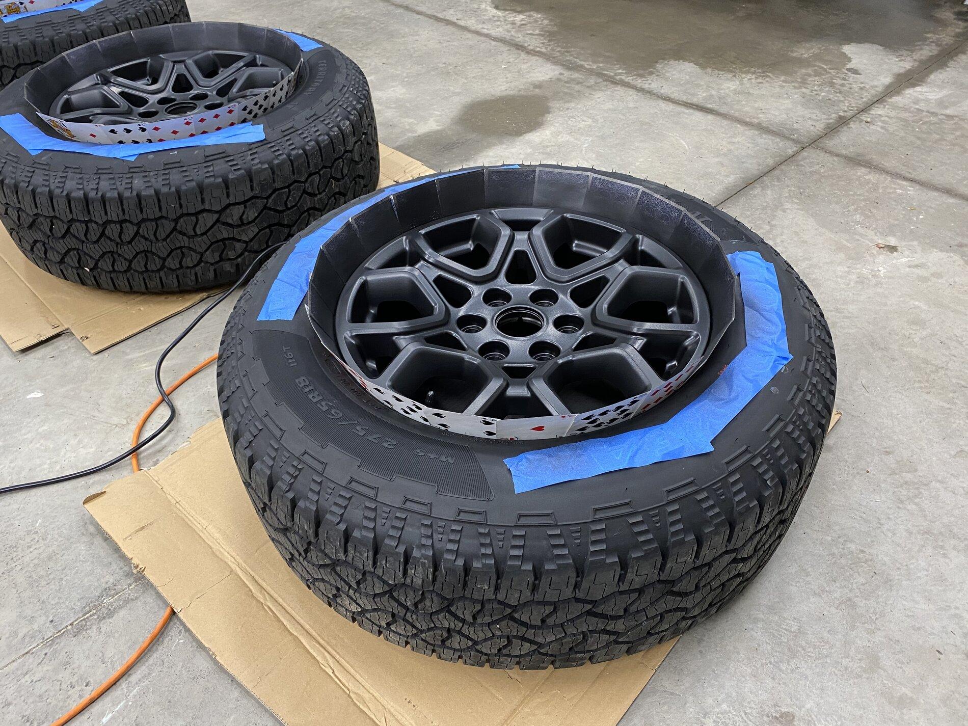

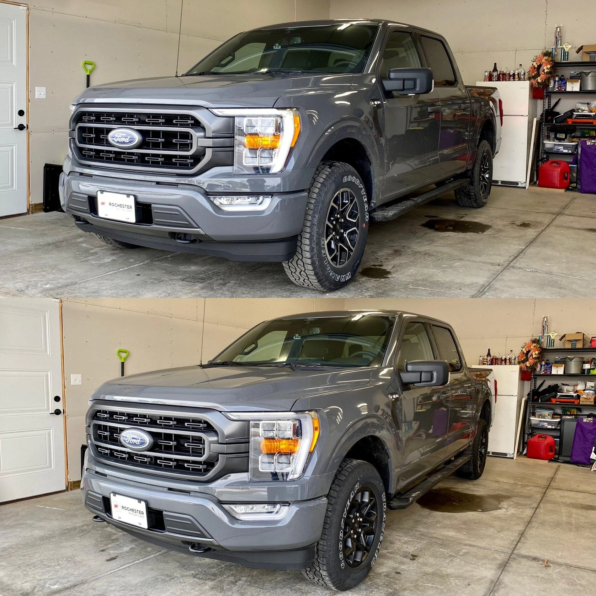

Plastidip fellas. Did it myself. You can get it at Menards.
I like the option to peel it off to put the wheels back to stock if I decide to sell. Wheels and tools are the the only things Iā€™ll use the stuff for, but it looks good and holds up great with good prep work.
Just make sure you pull the wheels and hand wash them, mask properly, and the lay on a lot of thin layers with minimum 30 minutes between coats and I think youā€™ll be impressed with the results.
Worst case scenario you donā€™t like it... Just peel it off!

Thanks for sharing your technique with excellent photos.
