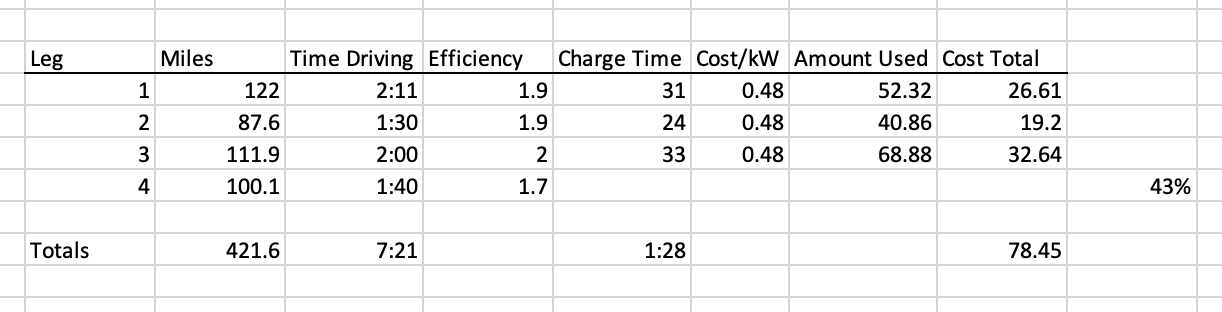

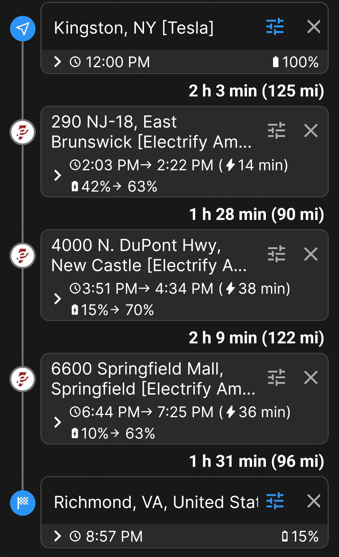

I'm not that far north 'eh. Both are big states. My trip is 576 miles, hence the potential 4th stop.

In the summer you should be able to do 576 miles in 3 stops easily.
Your 1st leg would be around 260-280 miles, especially since you’ll have decreasing elevation and 200-220 miles per leg after that if you charge to 70-75%

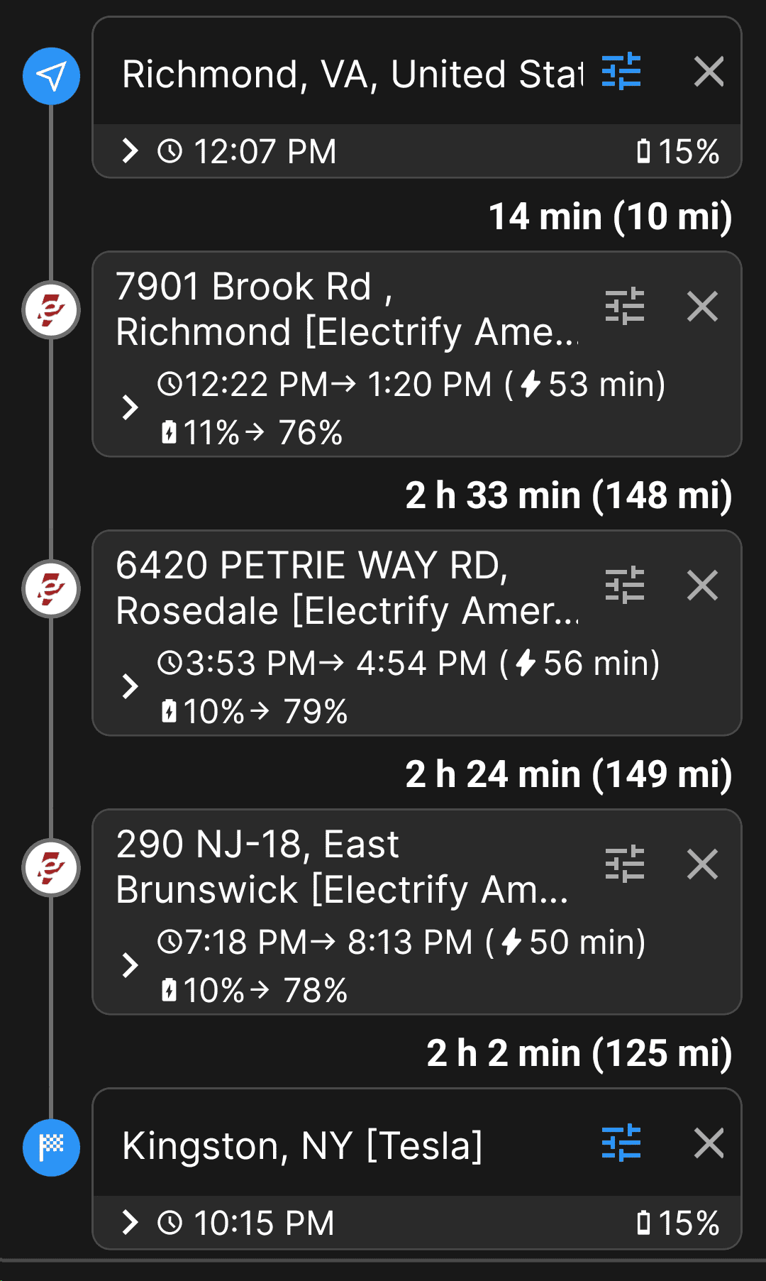

Coming back up, add a stop due to the elevation change.
The bigger concern is EA chargers seem to overheat in the summer heat and increased usage. Tesla coming online for us will help but I’ve found going down 81 instead of 95 while longer to be better for more reliable charging in the summer.
