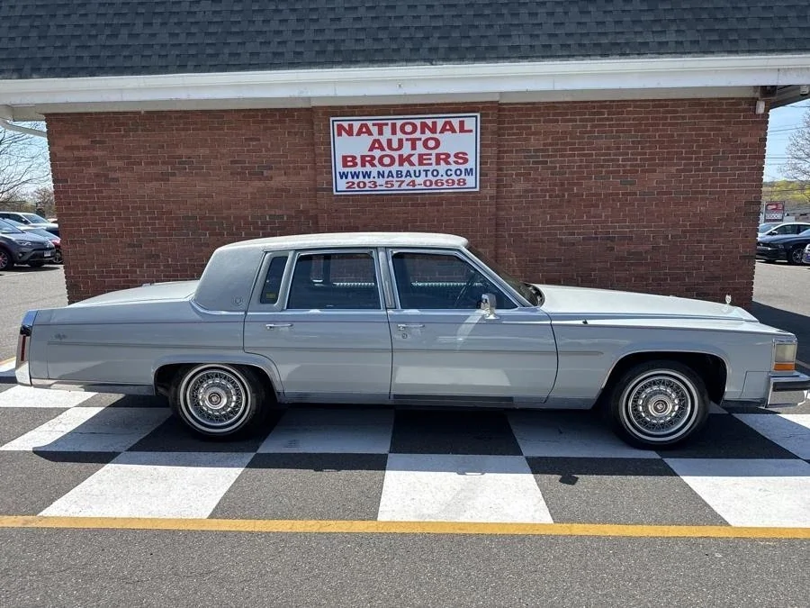

right, everyone has a different 'feel' to how they want the ride to be, or expect it to be... my LIGHTNING PRO SR 'glides' down the road in luxury - I would never personally label it as anything but exceptionally smooth and easy. .. gliding on a CLOUD... 62,000 miles and I've never felt anything but pleasure.
Ford F-150 Lightning Fix bouncy suspension? 1762976812418-52
I had a '88 Cadillac Deville, back in the day: this was the only other 'best smoothest glide' ride I have ever experienced. It was already 10-11 years old at that time, with hundreds of thousands of miles.

Had a 76 Deville my self, and you're right comparing it with these trucks for ride comfort. It floats every where I go, the new land yacht.
