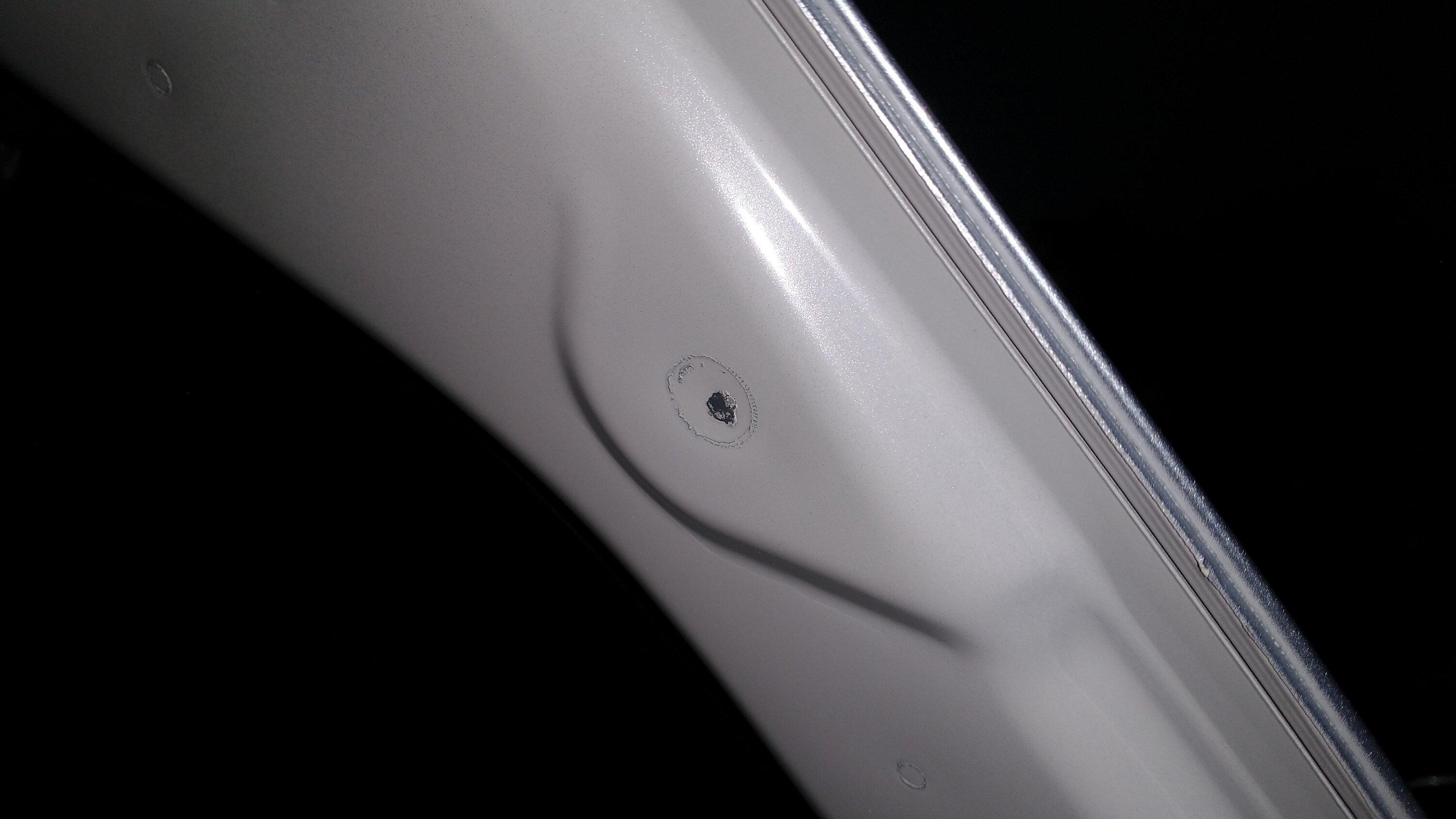

I am noticing that the "luggage compartment" hood rests hard against the rubber bumper posts on both sides. It seems they would be adjustable with the bolt threads into the fixed nut, but they do not move by hand twisting and I am reluctant to force with a wrench. Maybe they are meant to be rigidly fixed at the factory and provide a bit of pop to the hood when unlatching? Has anyone adjusted these?
Ford F-150 Lightning Frunk bumper posts adjustment? IMG_20221129_171030263 Frunk rubber bumper hard impact on hood
Ford F-150 Lightning Frunk bumper posts adjustment? IMG_20221129_171147510 Frunk rubber bumper hard impact on hood

Anyone adjust these? My frunk creaks pretty substantially and I *assume* that lowering these stops might help... but yeah, they don't twist.

So, actually they do twist. Just have to twist them pretty hard. I think the creaking is improved. Need to mess with them more to see if I can totally get rid of it without making them too low.
