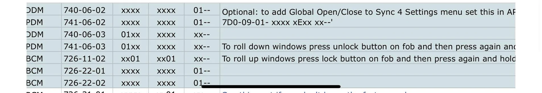

Can’t get windows to go down with key fob. Changed the line item in Forscan. But it just isn’t working. I have a regular cab, does that matter?

There are a few lines needing changed. I don't remember them off the top of my head.
Alternatively, I think it is a single line to just add it to the menus. Then change it there.

So if I just add it to the sync menu I’ll be good? Still works from key fob?

That is what I did. Then turn it on in the menu.
