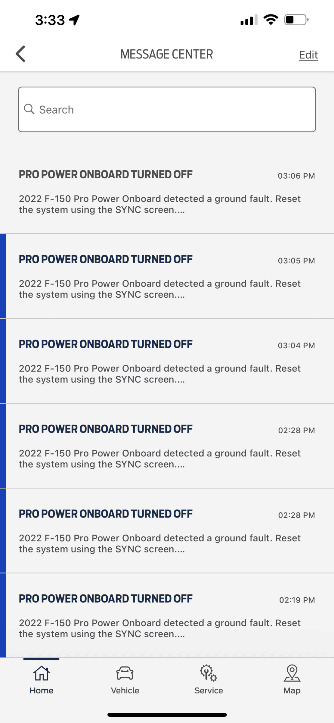

Also having this issue - first popped up after I parked the truck outside in the snow at my in-laws over the weekend. It's been dry since Sunday but still haven't been able to shake the ground fault errors. Seated the fuses under the hood, but will try the orange cable under the hood near the firewall and grounding wire on the passenger side. Sure does feel like some missing seals or weather proofing though...

My fordpass app doesn't give me an alert like yours, just the pop up on the screen. When the dealer scanned truck there was not sign of the error ever happening... it's very annoying. As most of the time I will ever use the generator the weather will be poor and I can't rely on it to work .

After a car wash today I got a message that ProPower needed service. I didn't receive an alert on FordPass. Previously I always got the ground fault message after a car wash, or during rain or snow.
