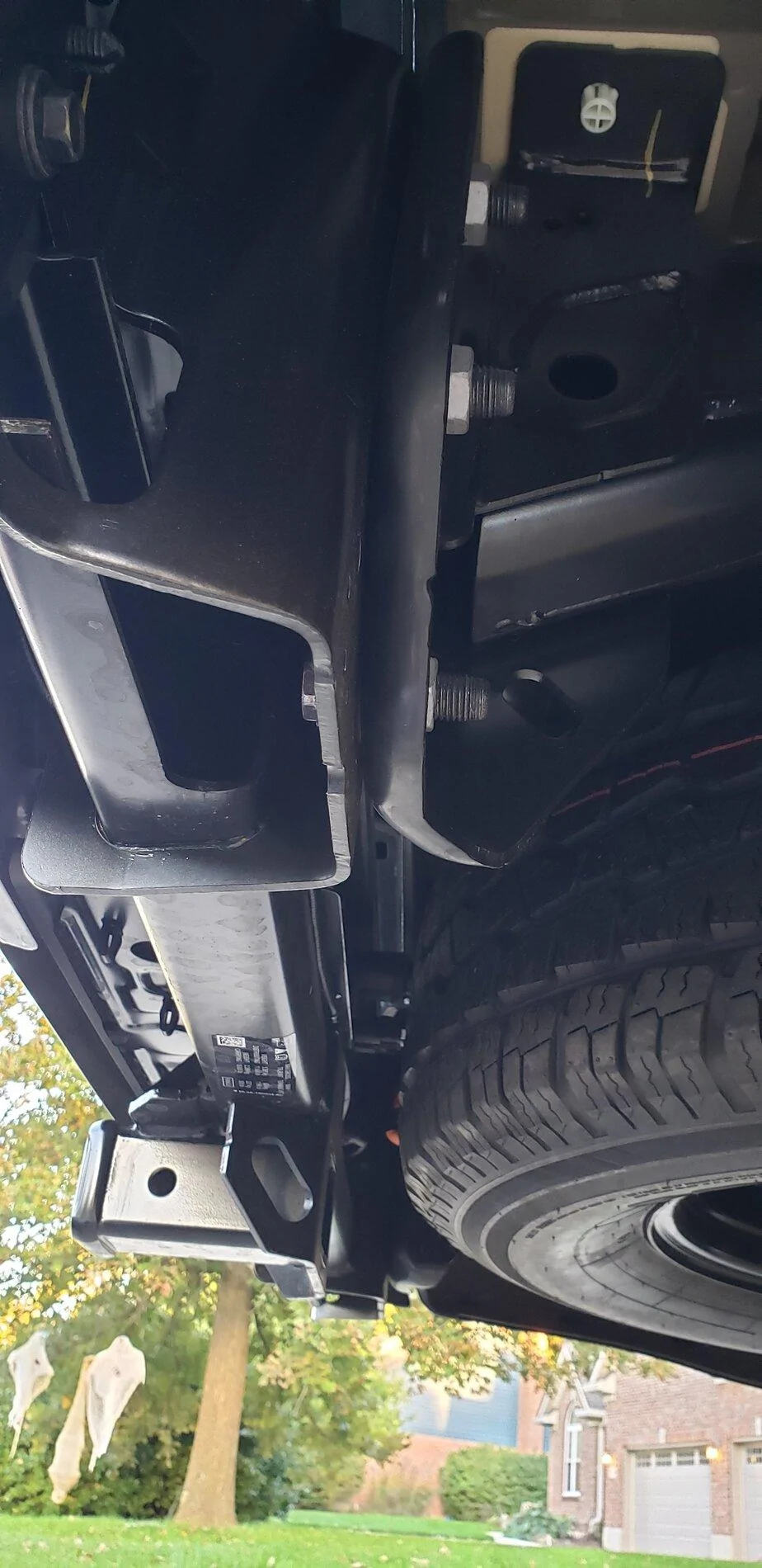

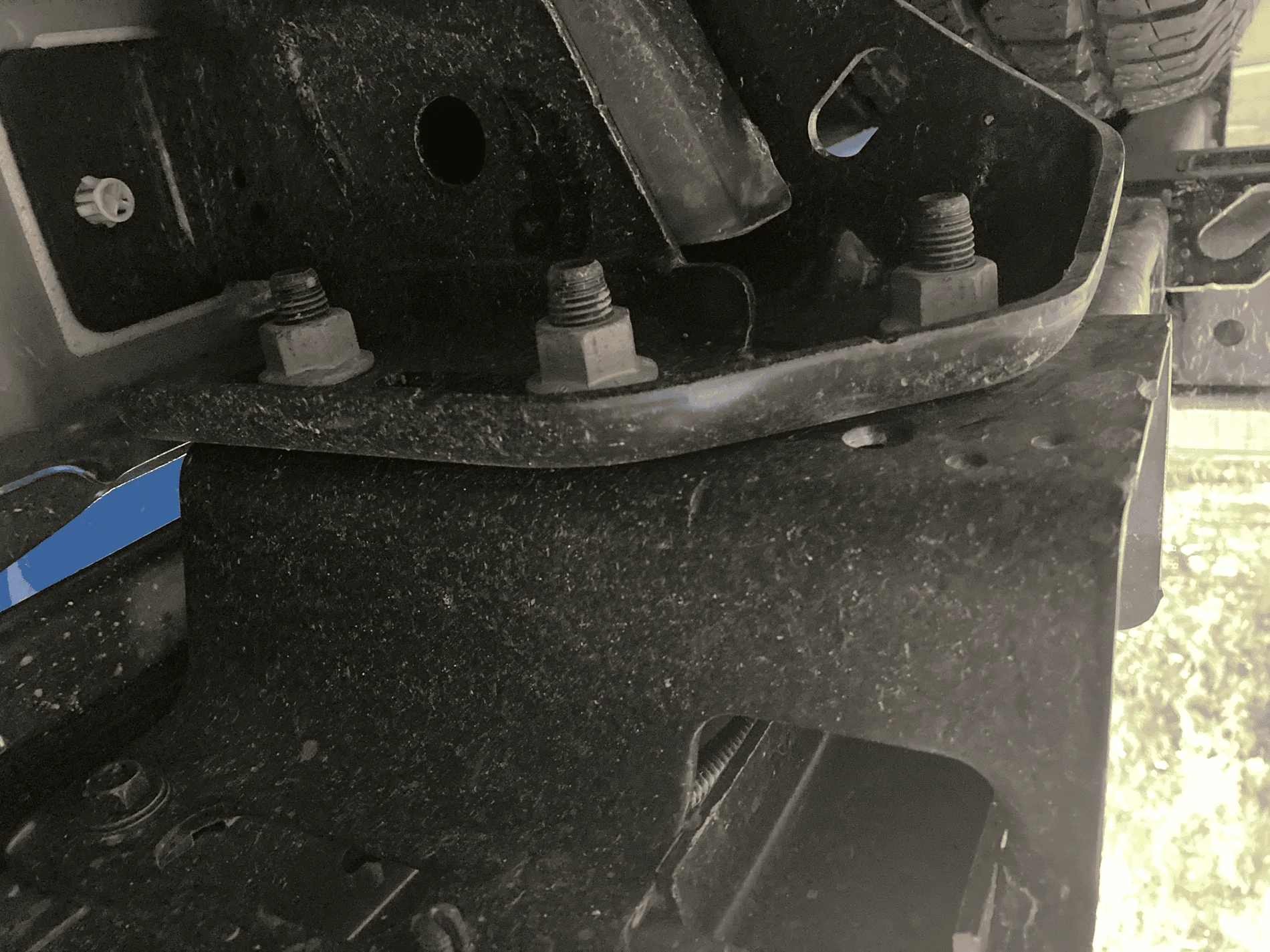

Can we reuse this thread to see pictures of the various stock hitches or hitch upgrades? I am curious what the physical setup looks like for tow-tech vs. trailer-tow vs. max-tow. I will post my tow-tech-only picks this evening.

Here are some shots of the hitch config on a 502a Powerboost with only the tow technology package.

It looks like the pull weight through this hitch (ultimately the trailer) is effectively held by the threads of the bolts. Is that true?
