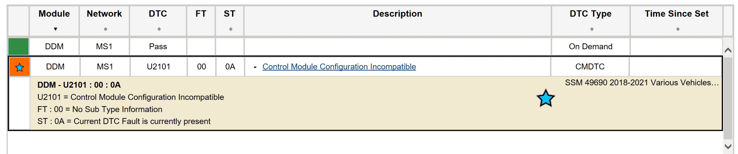

Btw, I am having a weird DTC in my DDM that popped up after flashing it:
Ford F-150 Lightning How to find latest version of OTA SYNC4 Updates? 1642131531944
I tried to reflash, reconfigure it multiple times but I just can’t clear this DTC. No configuration changes have been done to this module using ForScan or any other tool.
Anyone has an idea how to clear this ?
What does the SSM say?

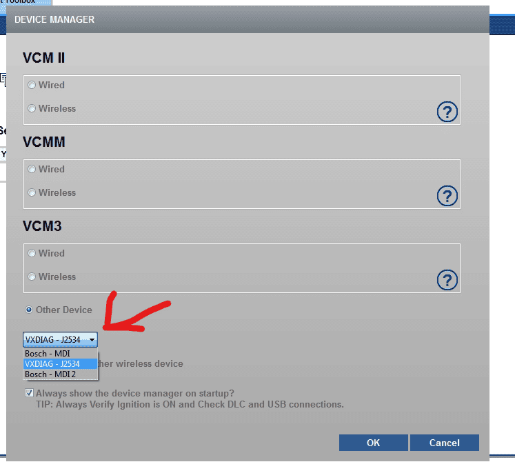

One more Important thing about this device:
DO NOT perform SW updates in VCM II emulation mode.
It bricked my GSM (Gear Shifting Module) when I tried to flash it in VCM II emulation mode. Luckily the J2534 pass-through mode could revive it and all is fine now. I found out the hard way. But as long as you set it up as J2534 pass-through, you will be fine.
In the process of setting up my VXDIAG/FDRS. Is this the place you need to make sure you have J2534 selected so it's not in VCM ll emulation?
