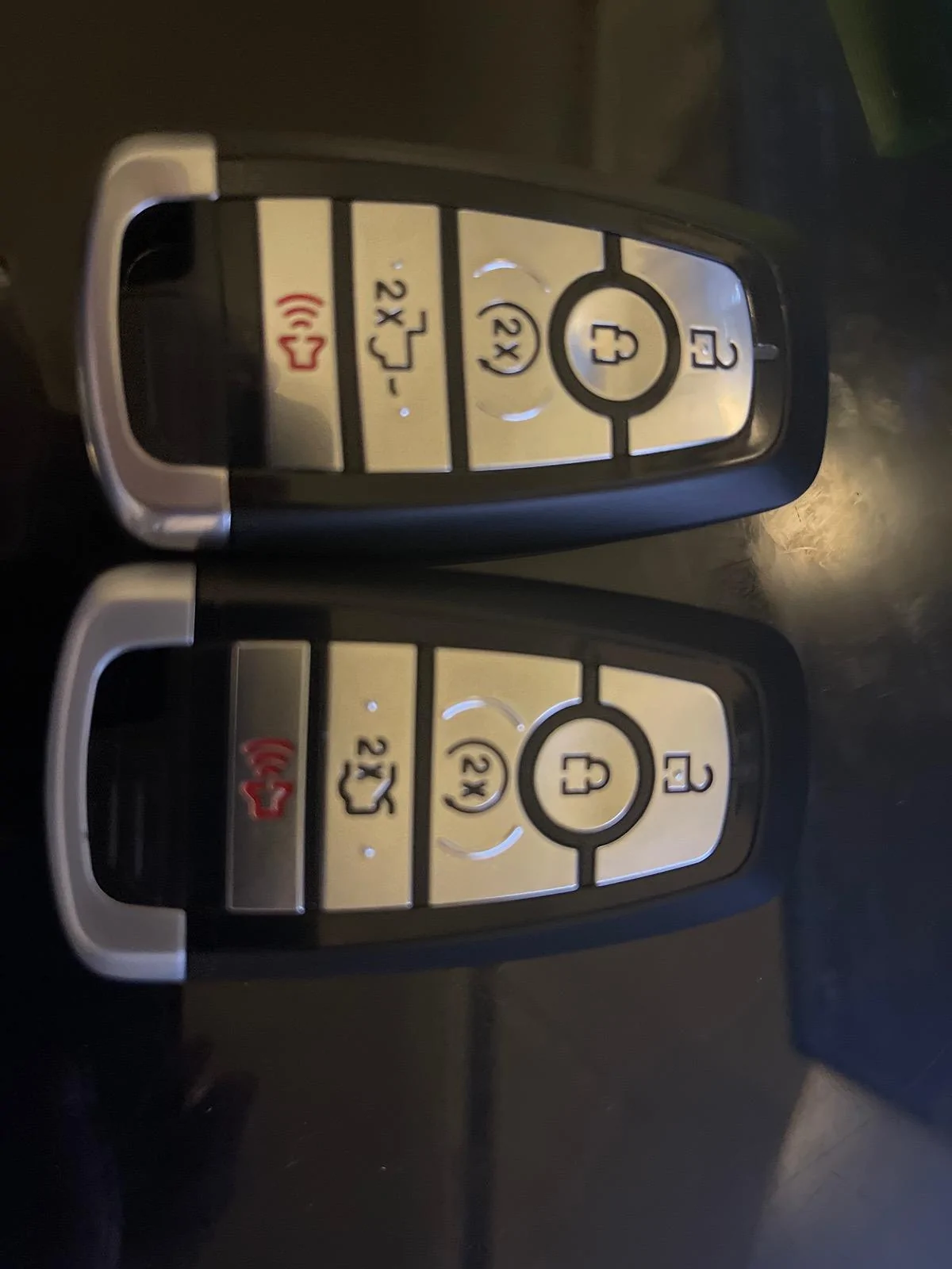

I know it was mentioned, but just a friendly reminder that the fobs on AliExpress work with remote start and are super easy to program, super cheap ($30 shipped), and come rather quickly. I did two orders (the first I ordered one with the tailgate release, but it was the wrong frequency) and both came in about a week. Once I programmed it, the remote start worked immediately. I figured it was 50/50 whether it would remote start or release the Frunk. Anyway, I am just harvesting the PCB to make a slimmer fob with an integrated air tag, but I thought I’d give a PSA about it.
Ford F-150 Lightning How-to: Remote Start from the OEM Key Fob!! (NO FORDPASS) imag
