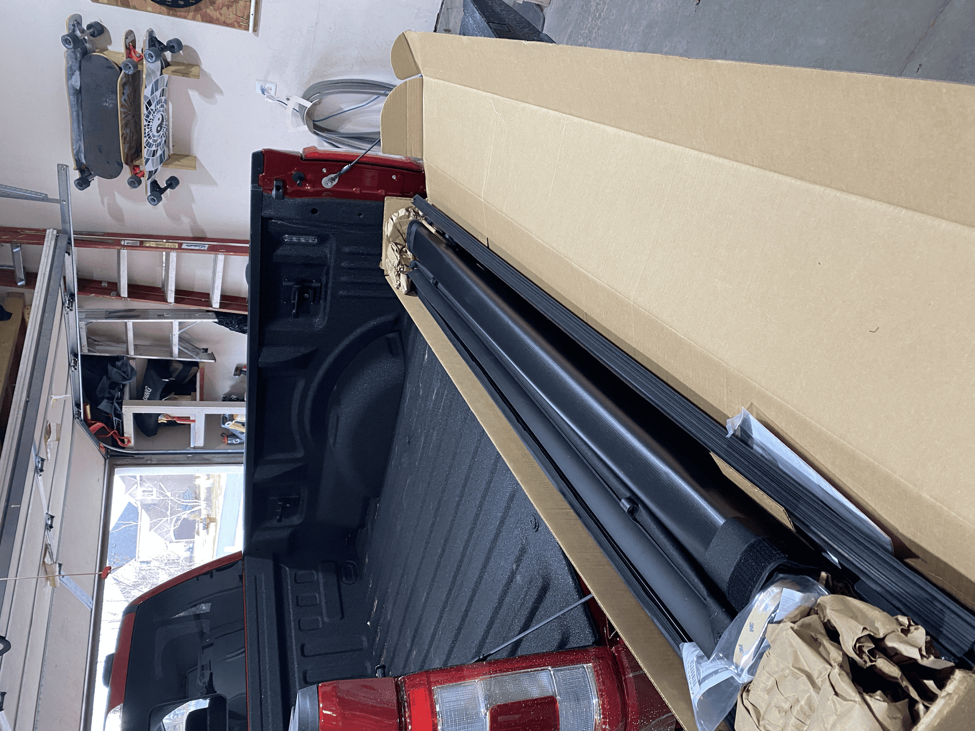

Upacked, not much to it. Two rails, the "header" cover combo and some sealing tape.

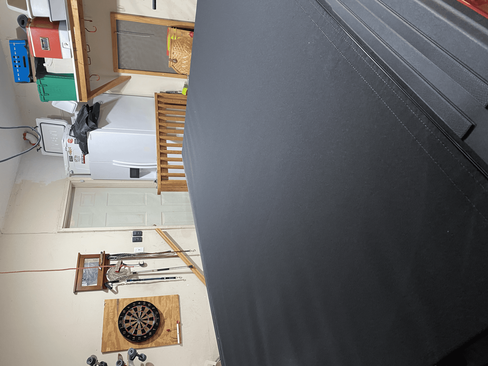

Now unroll the cover, check to see how it fits. You might need to adjust the tension. I was lucky and didn't. No big deal if you do. A simple flat blade screwdriver does the trick. Then work the velcro down on each side, Pulling the minimal wrinkles out. Snap the cover closed in the back and shut your gate. I know some do the gate first, in my case it worked better to close the top first.

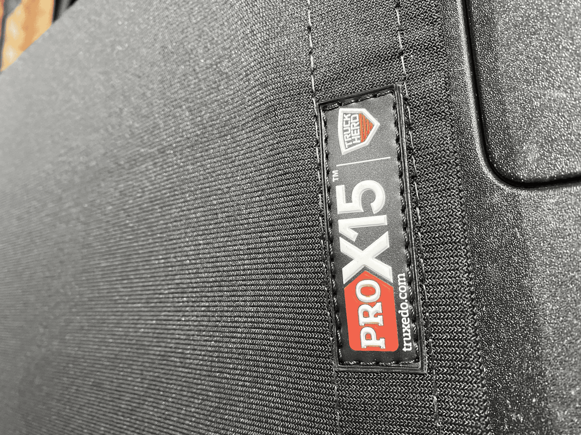

The fabric finish is a step up from my last cover. We will see how it lasts, and how easy it is to keep clean. My last Truxedo lasted 6 years with zero issues. I had no water in my bed when it rained and it provided some security for items in the bed. (Out of site, out of mind-Kept the honest people honest). I will now let the sun heat it up a few times, and make adjustments if needed.
