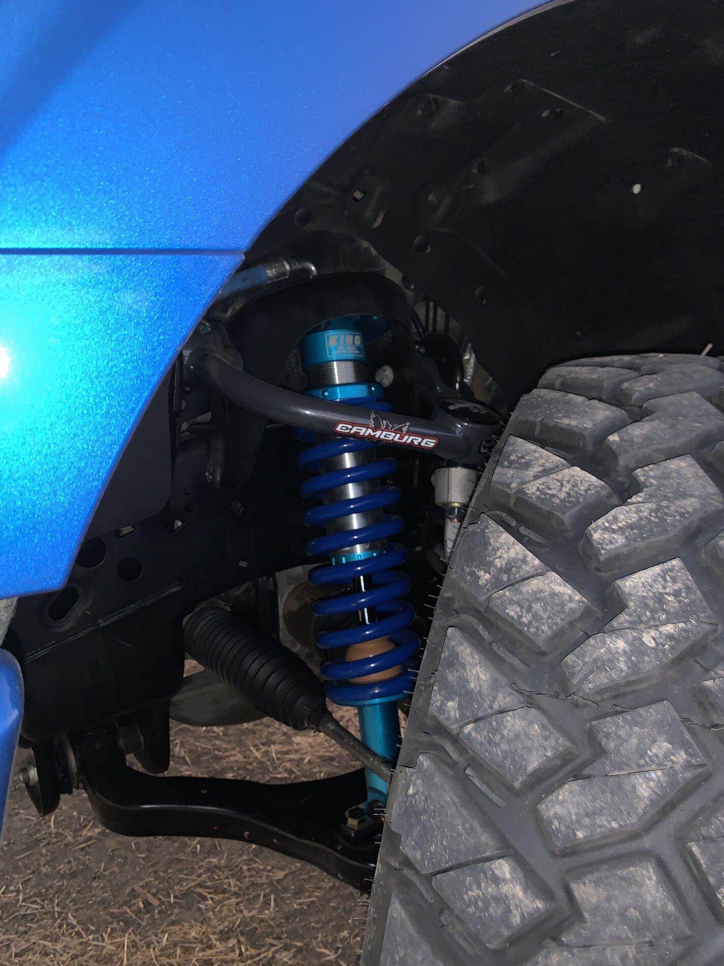

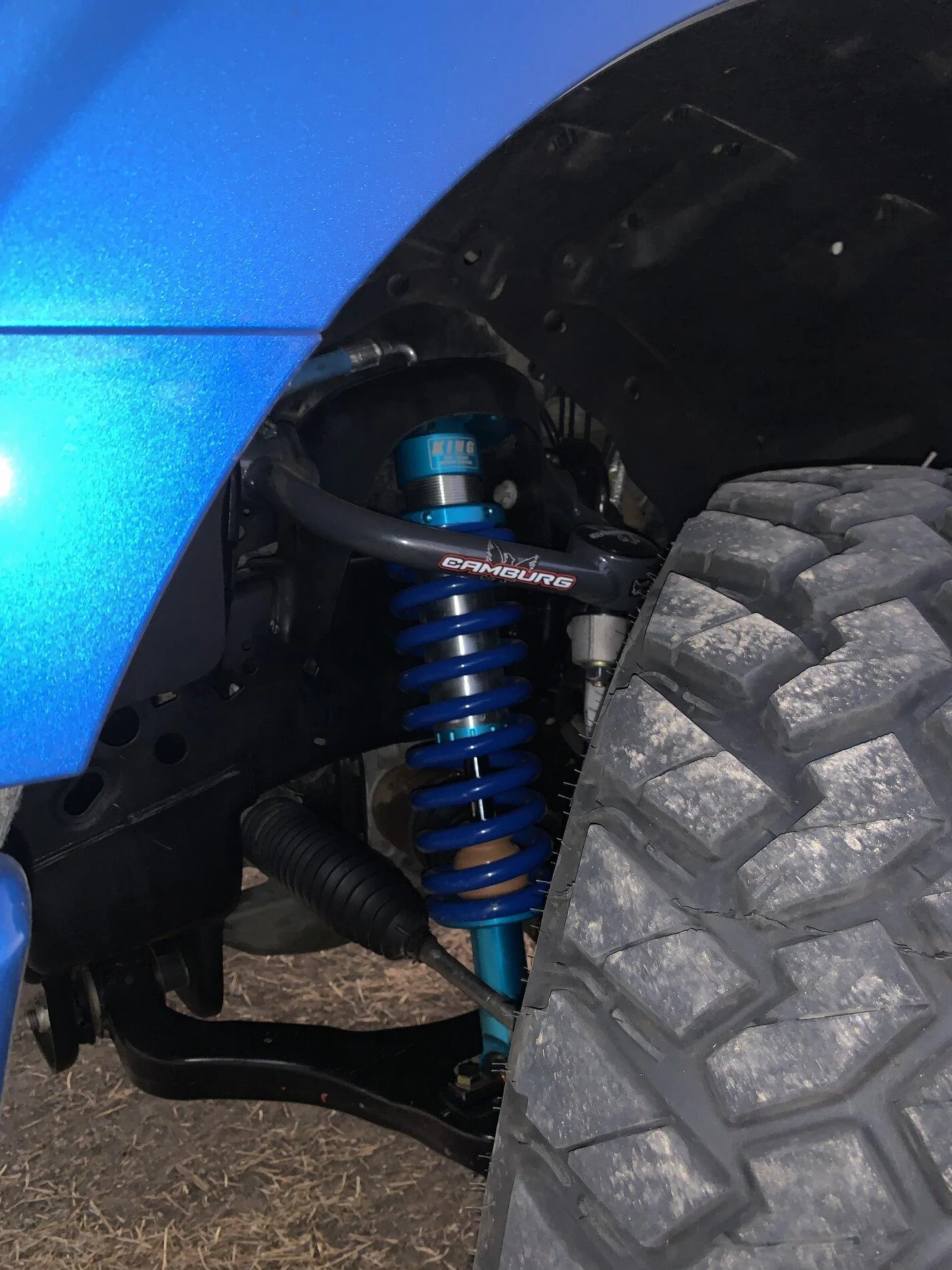

I have a 2021 F-150. I bought the Camburg tubular upper control arms for the 2015-2020 F-150 as well as the king coil overs for 2015-2020. Everything went on with no issues what so ever. Here are a few pics. Also, the ride quality on road is a huge improvement over stock. I highly recommend.
