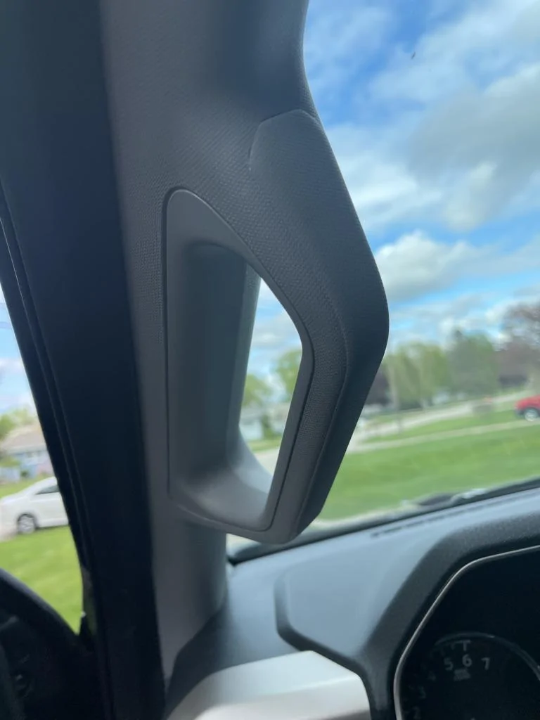

I'm trying to hardwire my dash cam into the interior fuse box down by the passenger's feet.
How do you remove the trim piece in the center of the handle pictured to access the screws to remove the pillar trim? it looks like there is a small hole that you should be able to just stick something into it and pry it out but i've tried several objects and they have all bounced out of the hole without moving it at all so I think i'm doing something wrong. (drivers side is pictured cause I was on that side when I decided to take the picture)
Thanks

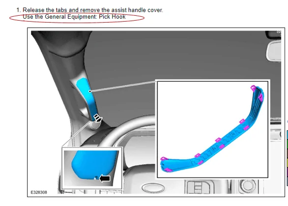

I believe you remove the outside part of the handle to access the bolts. There is a small little spot in the cover you use to pop it off.

That is what I have been trying to do, but I was using keys and then when that didn't work tried a screwdriver but neither worked. I'm sure I have pick hook somewhere so i'll give that a try once I find/buy one lol. thx

It’s two bolts behind the cover on the handle. It’s easy to do but use caution if you’re not only using your fingers. It scratches really easy. Also, once the bolts are out, it easily comes out. There is an airbag behind it as well, so use caution if your just tucking the wire if you don’t take it off.
