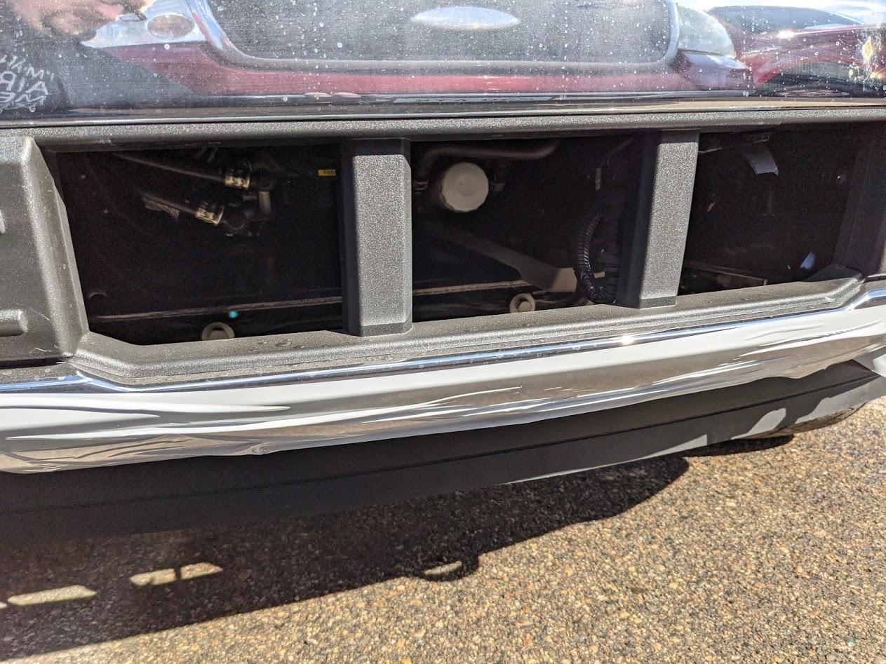

Well I'm planning on doing my first oil change on Monday so while I'm down there I'll make sure I can get that panel off without damaging anything. If you're up for trading at that point let me know.

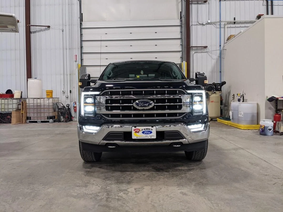

That opening was one of the first things I noticed when they backed it off the truck. Without the license plate bracket on there it really looks unfinished. Especially with the gleaming white of the oil filter shining through at you. Took a while for someone to get back to mas as to why it had the EB panel on it and not the standard 5.0 panel.

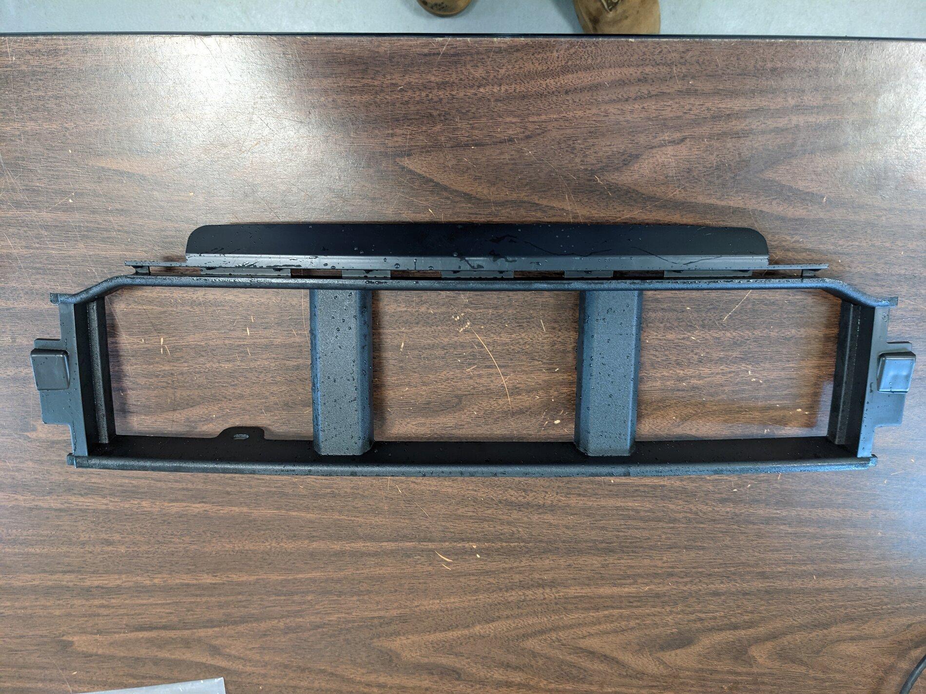

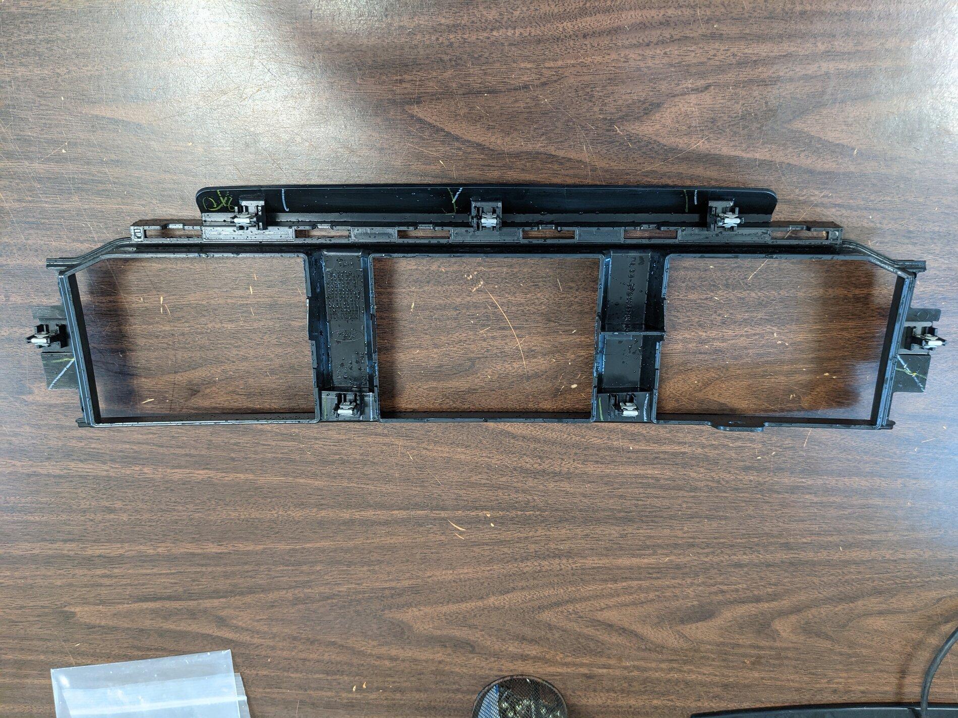

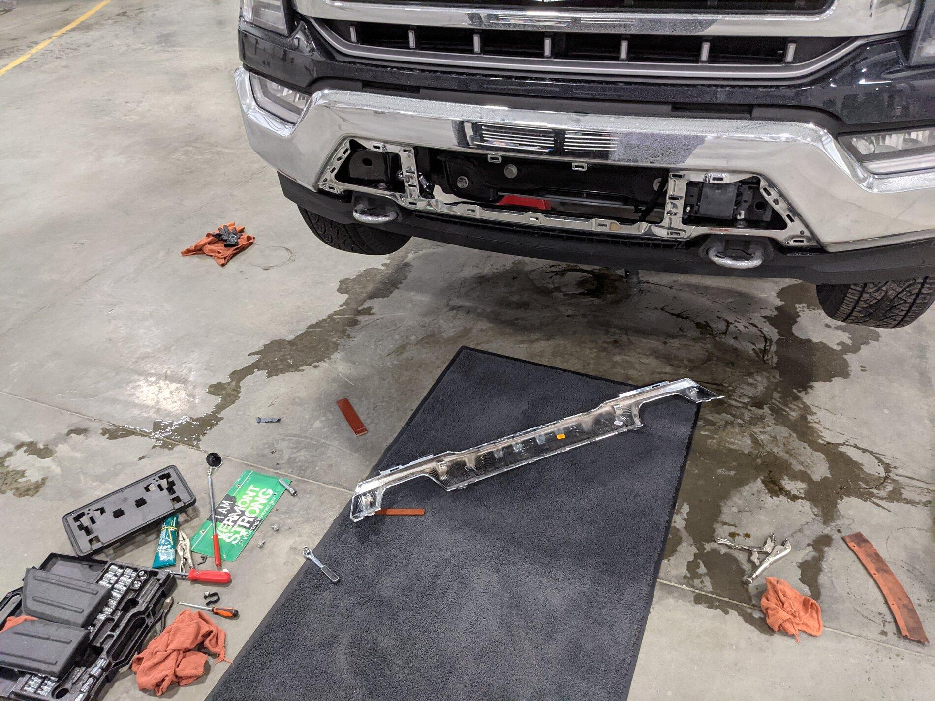

OK, so after a little bit of finagling, and a lot more removal than should have been necessary, I managed to get the center piece off in one piece.
Ford F-150 Lightning ISO Ecoboost Bumper Insert PXL_20210426_180608256
Ford F-150 Lightning ISO Ecoboost Bumper Insert PXL_20210426_181026510
Ford F-150 Lightning ISO Ecoboost Bumper Insert PXL_20210426_181040266
Ford F-150 Lightning ISO Ecoboost Bumper Insert PXL_20210426_181049016

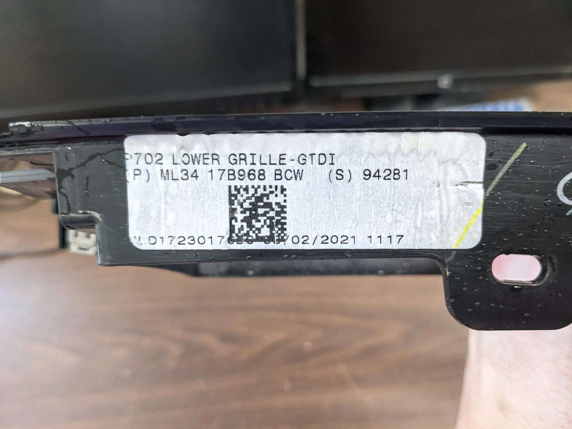

I would double check the PN to make sure that it will fit with your installation, but honestly I don't see why it wouldn't.
If it looks good, let me know.

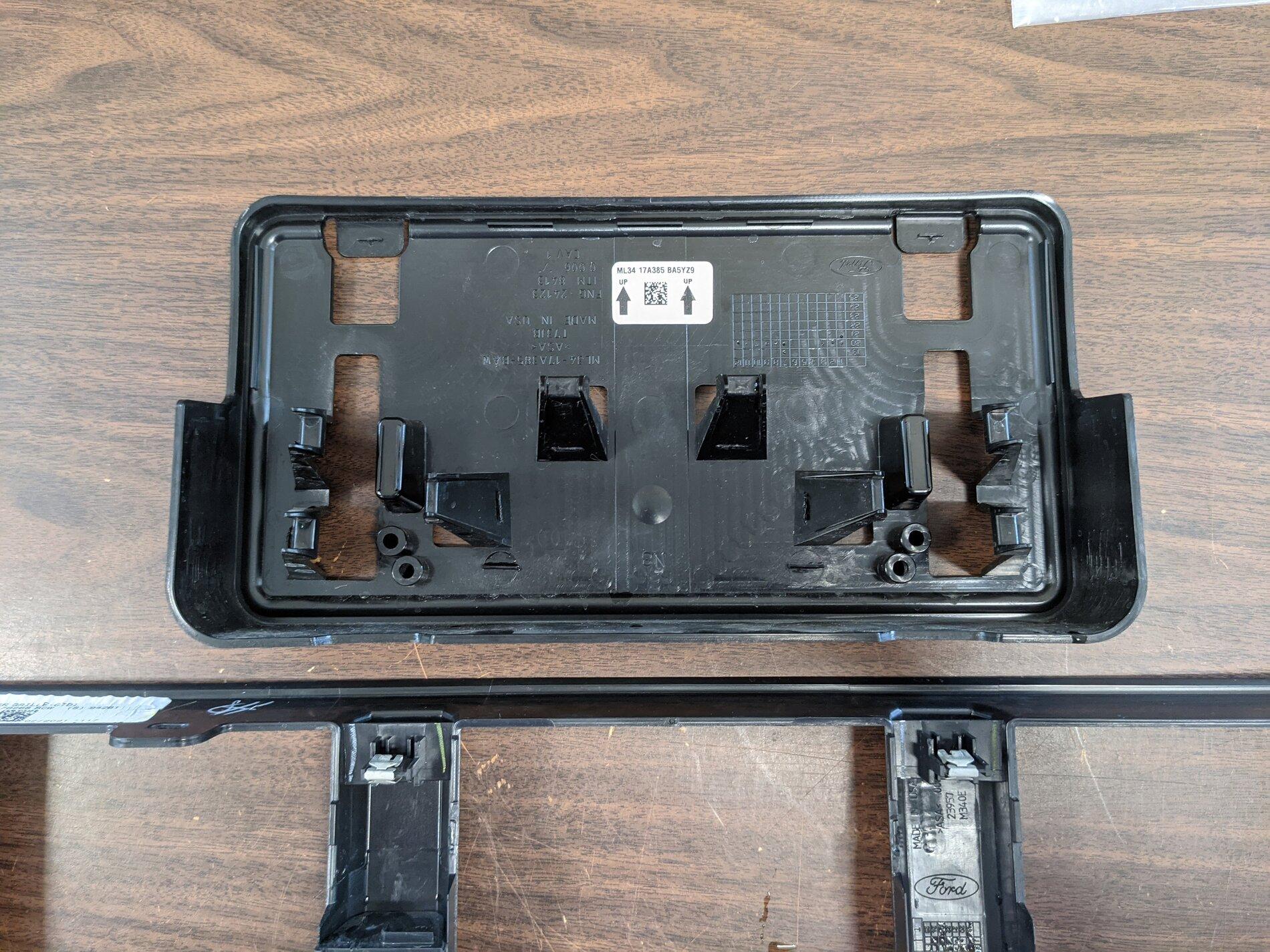

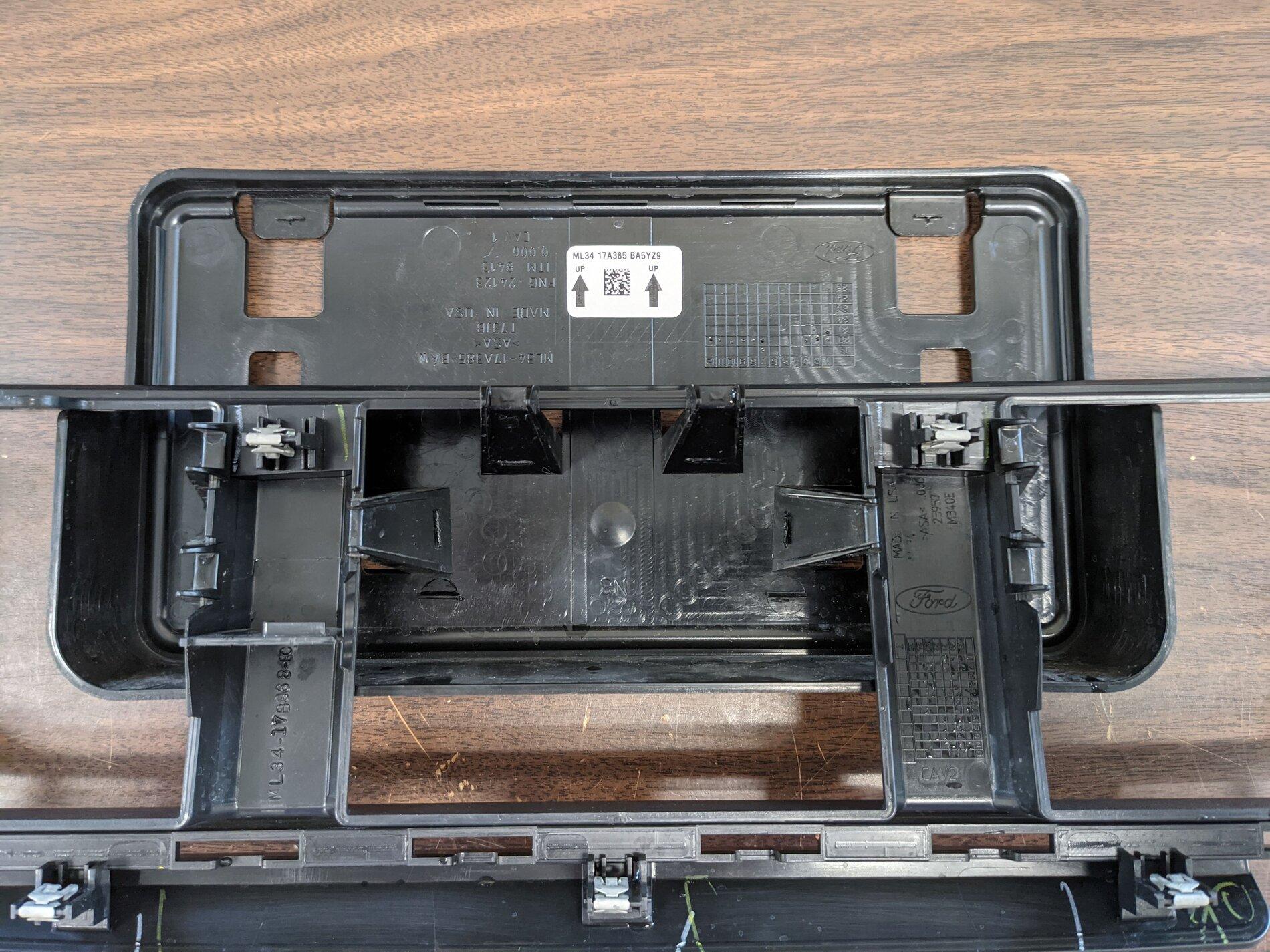

Also, the front license plate brackets may also have to be traded. I'm not sure how the one for the solid front piece is supposed to attach, but this one looks like it was designed to work with the open center piece only.
I’ll have to order one, I don’t live in a front plate state. I’ll touch base with my dealer to see if they have any.

Sounds good. I put most of the front end back together but I left the center piece and license plate bracket off. I suppose just shoot me a direct message with your shipping info whenever you are ready. I'll box then up tomorrow and get them ready to go. ?
